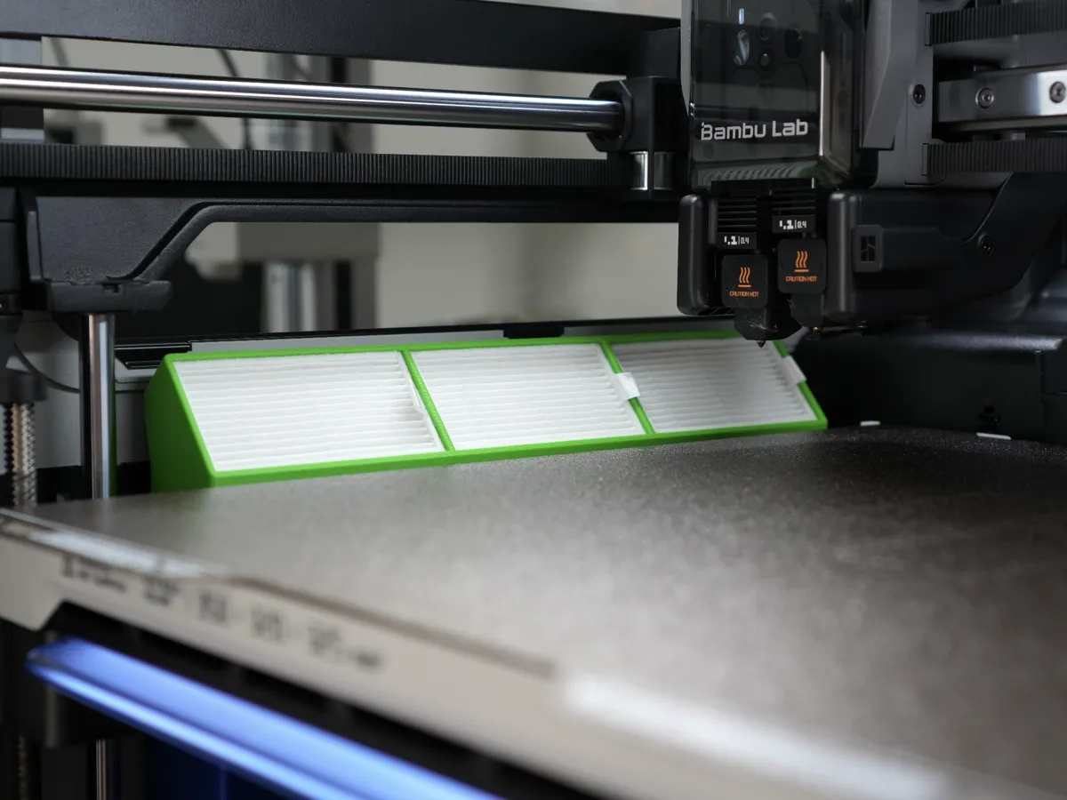

Meant to ask you this, but what is this? I’m guessing this is something that replaced your auxiliary fan on your H2D? I think that’s the top of what I saw in your flexy christmas ornament stream.
@KYZ_Design designed it. Works great. Allows extra recirculating filtration, thats controllable.
Did my first ABS prints on my H2C and my AQ meter showed a spike in small particles and VOC’s at the start of the print. My X1C shows no similar spikes when running my bento box, so I was thinking of how I could add better scrubbing to the printer. Your stream made me think that might be a solution. Thank you for sharing.
