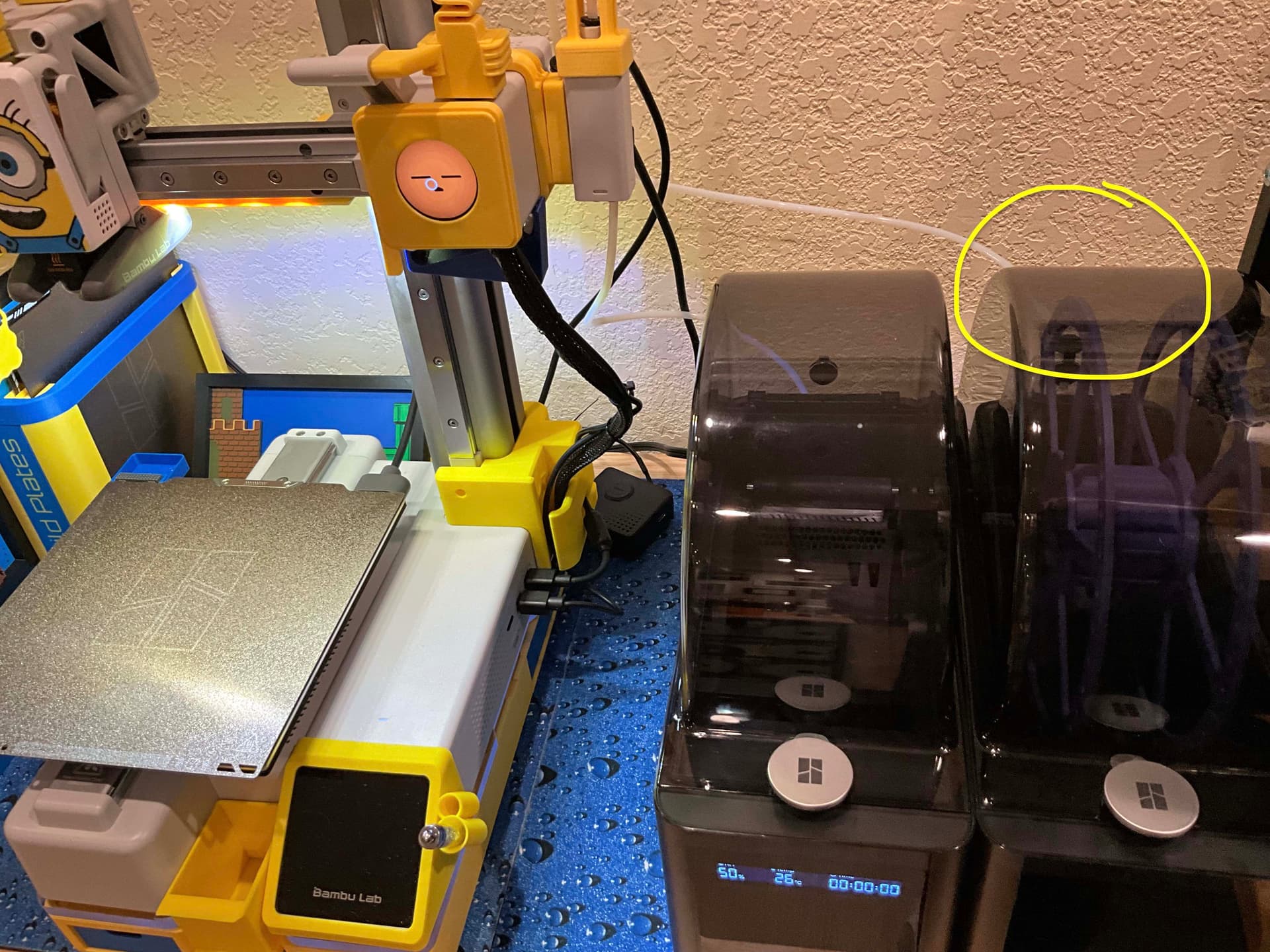

I have a couple BL printers - H2D and an A1-Mini.
I want to print TPU and have zero interest in jumping through the hoops necessary to print it on the H2D. So that leaves the A1-Mini.
The more I looked online, the more potential issues I found - open bed, temp control, feed issues, etc.
I spent quite a bit of time working out just how to efficiently feed the TPU 95A into the head of my Mini. I scoured the internet for some proven methods and didn’t really come across anything that blew my mind.
I printed the typical stand to hold the spool and such. I use the small Sunlu spools. Even in the spool adaptors, they spun way too freely and caused the filament to catch at times. And there was no way to deal with the moisture/temp variable.

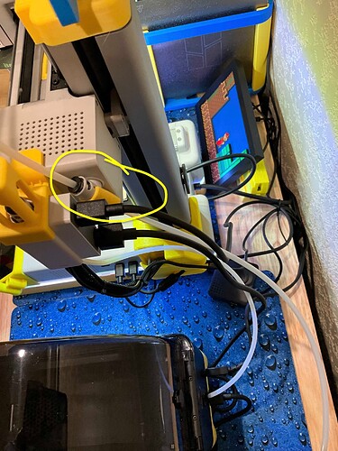

So I picked up another AMS-HT and utilize it as an “external” source. I printed a cool little fitment thing that allows me to attach the tube to the original feed tube on the Mini. There are no open gaps in the tube from the HT to the hot end. Sealed pathway. Because it bypasses the hub, I can actively dry the filament while the TPU is being fed through the tubes to the print head. I tested it and the prints came out flawless.
If anyone else out there has been uncomfortable with TPU on these open bed slingers, maybe give this a shot.
I’ll attach a pic or three here.
It works surprisingly well for TPU95 (Sunlu). I’ve run several models through and they are incredibly clean. No hairs.
The AMS-HT on the left is the main unit for most all printing and feeds through the hub. I only print single color on the Mini. Any multicolor printing is done on the H2D.
The AMS-HT on the right is only for TPU and bypasses the hub.
I use AMS Lite Passthru
I have a fitting on the PTFE that I use to switch the tube when I use it.
It works great, haven’t had any issues.

^ I am hoping the water drops are a printed pattern on the blue surface under the printer.
hahaha, yes. The water droplets are actually two oversized mousepads that act as a mounting cushion for all of the devices. It helps deaden the activity happening above the workbench. I have a large supply of these cushiony mousepads with all kinds of Caribbean graphics. Water bubbles won the job that day as the blue went well with the Yellow and Blue theme for the printer mods.
