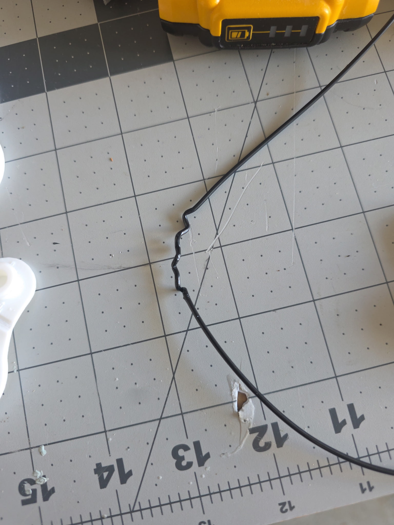

TPU won't unload from AMS
I was planning to try a TPU print. I had a reel from Creality so I loaded it in. It fed through just fine but the AMS says it will work with Generic TPU ? So I tried to unload it but I push on the release the Filament and it won’t let it go?
  1. Any suggestions how to unload it?
  2. Any suggestions on how to convince my H2D w/AMS2 to use it ?
Thanks in advance.

Solution, I did not have to dismantle the AMS. Thank goodness! We cut the TPU at reel, pulled open the feed tube underneath and pulled it out. Looks like it got prematurely hot and got stuck. Sounds like a personal problem :wink:
I appreciate all that responded. Here is a pic of what the filament looked like when pulled out.

Glad it worked out. It has nothing to do with heat but the flexibility. Other soft filament like PLA flex, PEBA etc. will have the same result, dont try it again.
