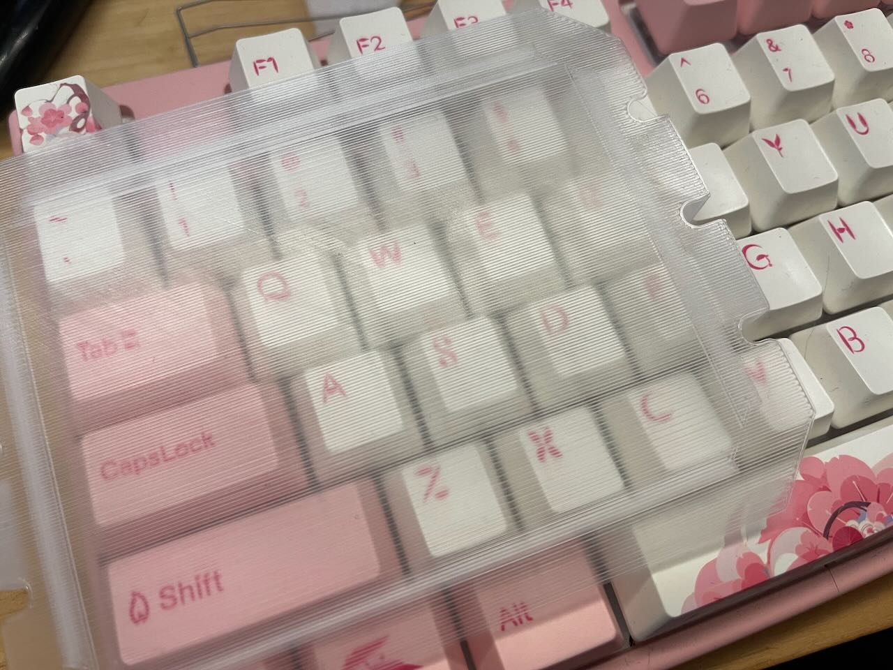

Here are a few examples that may help.
Transluscent PETG vs white PETG with one vs several walls:

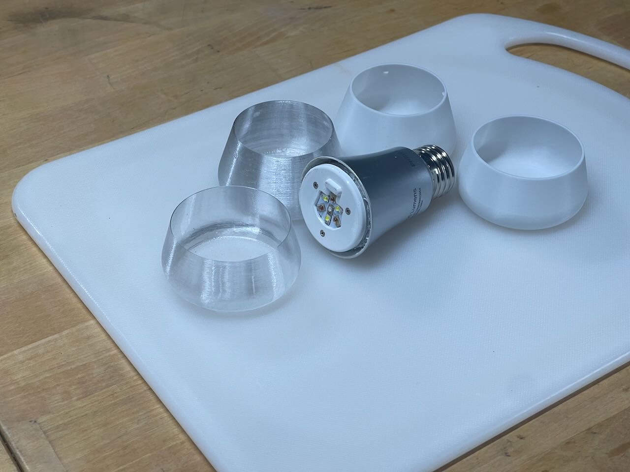

This is light bulb diffuser for an OG Philips Hue bulb, back when they still used glass. (Newer ones are all plastic.)
  • The one at far left was printed with a single wall and very slowly to get maximum clarity.
  • The second from left is two or three walls thick, normal speed. Due to the multiple walls, it is not nearly so clear, but it transmits nearly as much light.
  • The third and fourth are white PETG, same wall thickness as the 2nd. They transmit much less light, but are far more effective at diffusing light. (The clear ones turned out not to be very useful to me.)

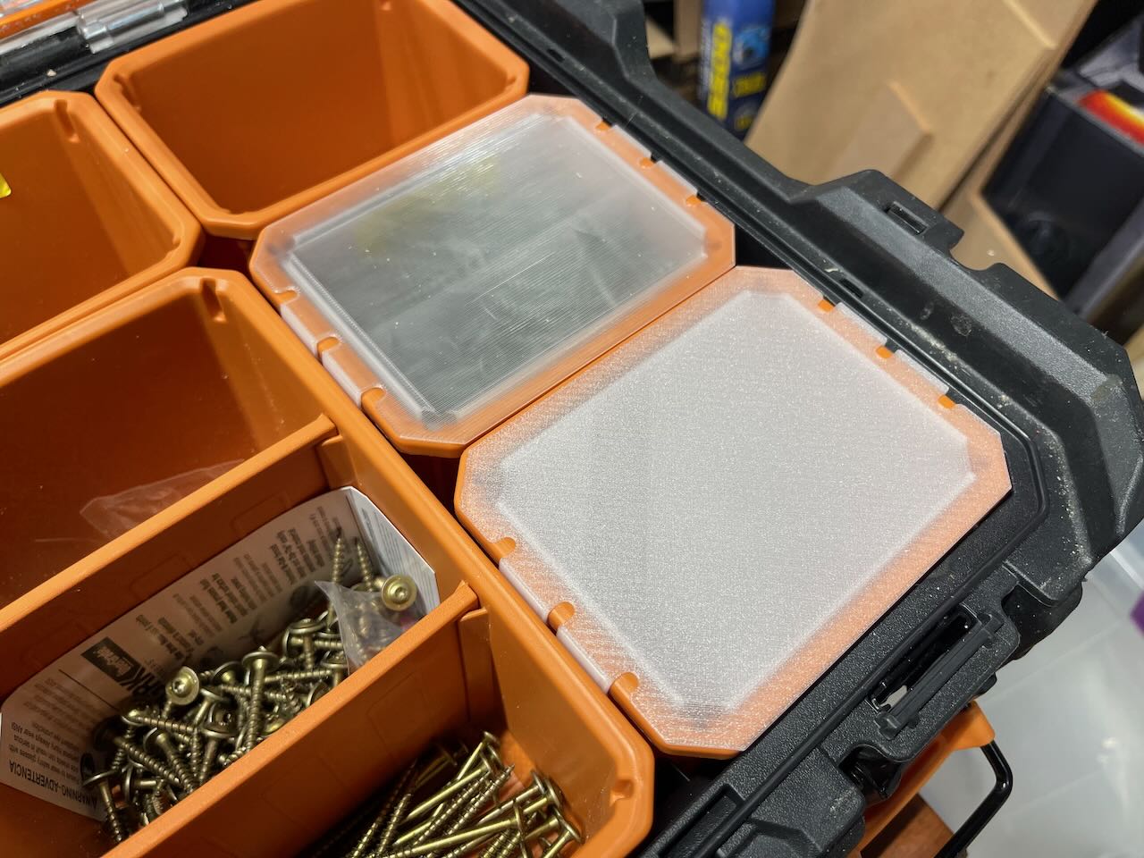

Translucent PETG, thin and thick panels:
These are covers for parts bins in a RIDGID organizer case.
  • The left/upper bin cover was printed with most of it a single, 0.2mm thick layer. I aligned the print direction and printed it very slowly on a smooth plate to try to get maximum clarity. It’s still hard to see through, and it broke very easily.
  • The right/lower bin cover is printed at full thickness (I think it was 1mm thick?) and on a textured PEI plate. You can’t see a thing through it.

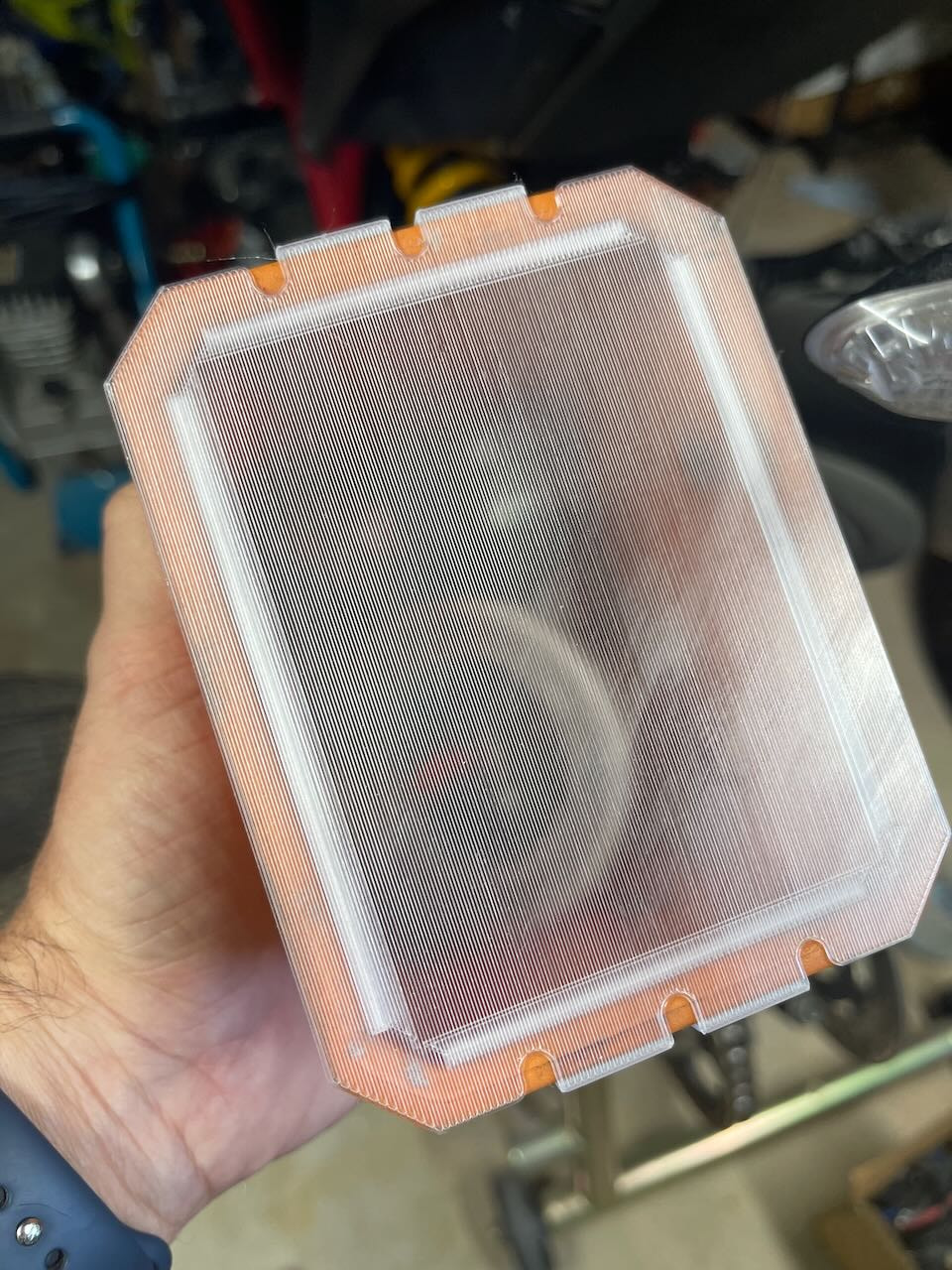

  • This is that first cover again. If you lay it directly on something you can see shapes through it, but back off even an inch and you only get the vaguest of shapes:

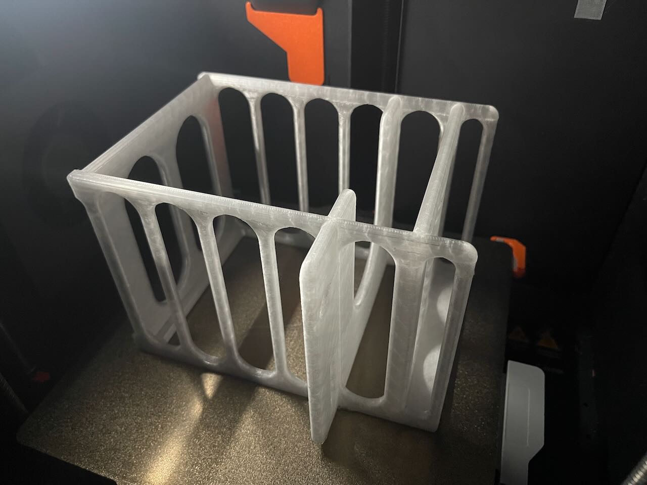

Transluscent PETG for ordinary functional parts:
This is a structured organizer for my AeroPress coffee maker.
