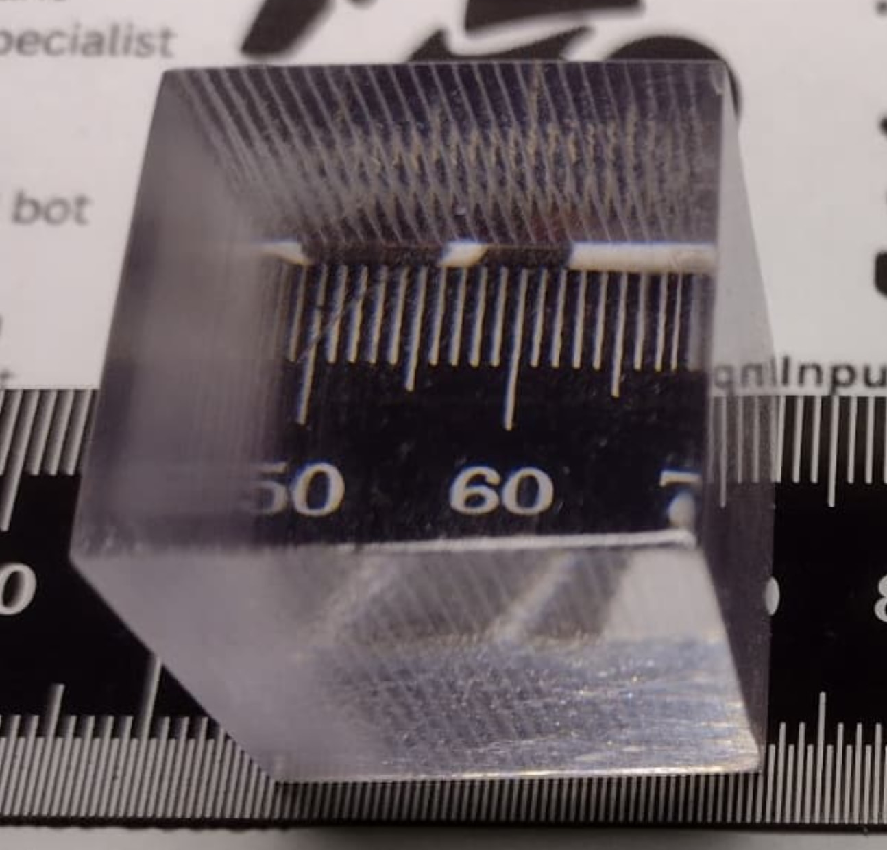

I’ve been printing prototype parts using transparent (see through clear) PETG a few years before Bambu. I’ve gone through at least 30 rolls of transparent PETG (as hobbyst), mostly no-name from ebay, like kingroon, sunlu or labeled as “3D printer filament” as brand name… You know, those are mostly for draft prints to see the internal if there is any weak area and of course usually get thrown away after that.
PETG originally is transparent, they just add dye or addictive to make it translucent or solid, which also change properties of PETG slightly, mostly I have to change flow-rate slightly from one color to another.
Maybe I print transparent PETG too much so that I prefer it over colored PETG.

Transparent and translucent are not the same thing. The sales and marketing folks may fudge some but think of transparent as like the windshield on a car.. Look at at an object through something with no distortion.
So-called transparent filament is a matter of who calls it transparent. My definition of transparency is optical clarity. Other filament companies mean anything that is not colored.

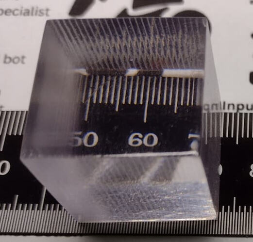

This was CC3D PETG printed using the techniques in the post linked above.
