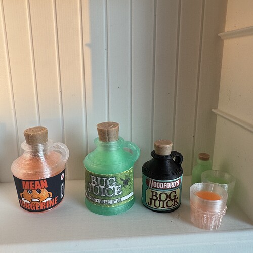

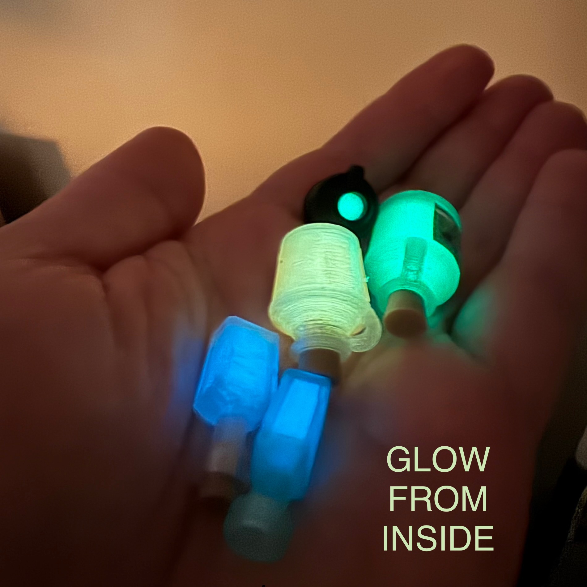

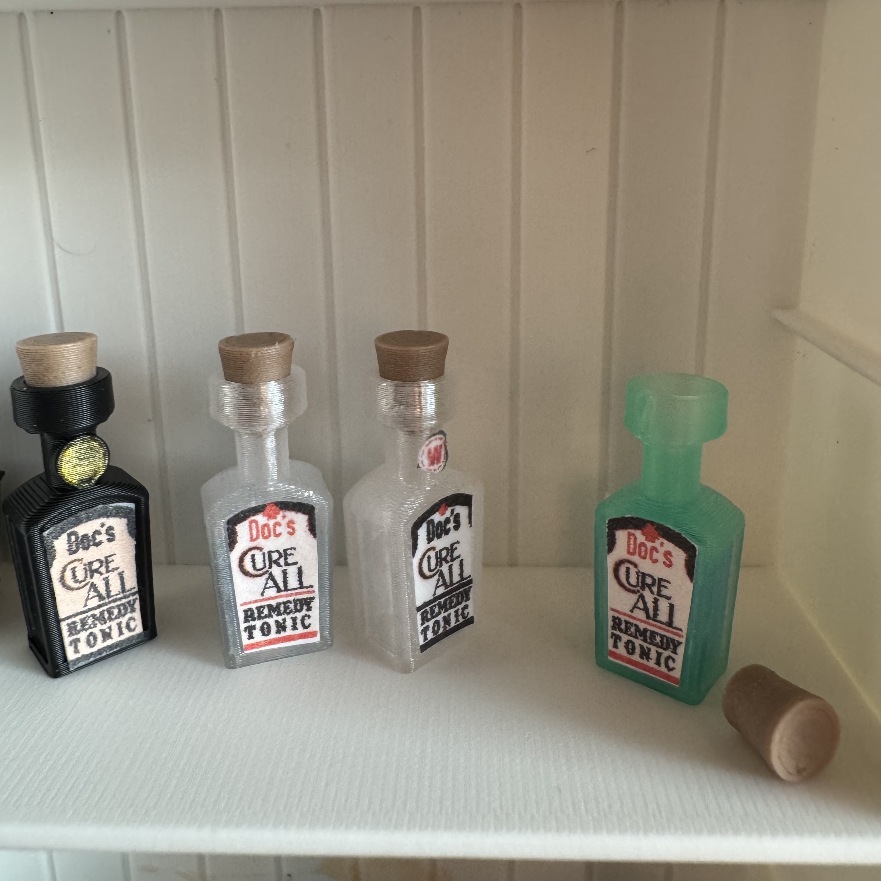

Here’s my translucent pla and petg examples. Miniature 1/12 scale bottles with translucent outside and glow pla inside. I use mostly Bambu but I did recently try a Ziro caramel translucent filament that was really nice. That example is in 2 bottles on the shelf one on the top with a w that says Woody’s Wine.

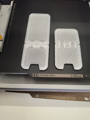

The one on the left was printed (previously) using standard PLA settings on the textured plate. The one on right was printed using the Translucent PLA setting you told me about, on the smooth plate.
