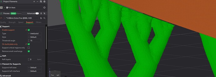

Saves time and material. Regular support does make more sense in this case but I use tree supports on everything and never have an issue. One Tree trunk would have done the job of 3 columns for two taller ones with smaller overhangs. And then it has the same supports on the other side of this model that you can’t see. No option I tried would give me a tree support. This model I don’t really care but it got me tinkering trying to figure out why its not generating tree supports at all.

You need to select organic as the type for it to generate like it used to.
That picture was with organic. That’s what led me to believe there was an issue with tree supports. This is BambuStudio 2.0.3.54
I was replying to OP, but now that I look at yours, that’s crazy. Not even close to tree supports lol. Anytime Bambu releases something new or does some new features everything gets all jumbled up. I’ll give it a few weeks and everything will be back to normal.
