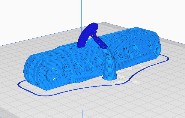

For example i wan’t support from bed only for 85° + ovehang
result on cura
cura

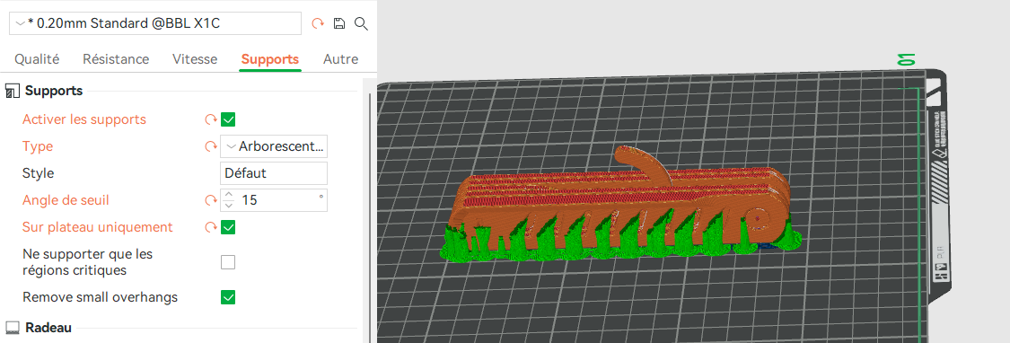

result on bambu studio (with parameter used for support) Tree(auto) , From buildplate only and 15° threshold support
I also try to change Tree support branch angle and set manually support part without success
For me if i tick from bed only support seem to be broken on bambu it support way below the threshold defined and not event (in picture look like overhang less than 45° seem to be supported for no reason and hook part not supported at all
did i miss some setting for getting something closer to cura or from bed only is broken ?
