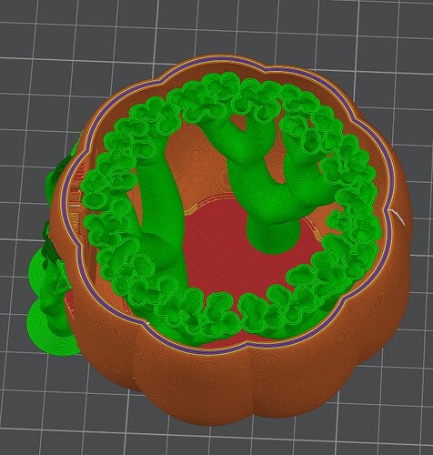

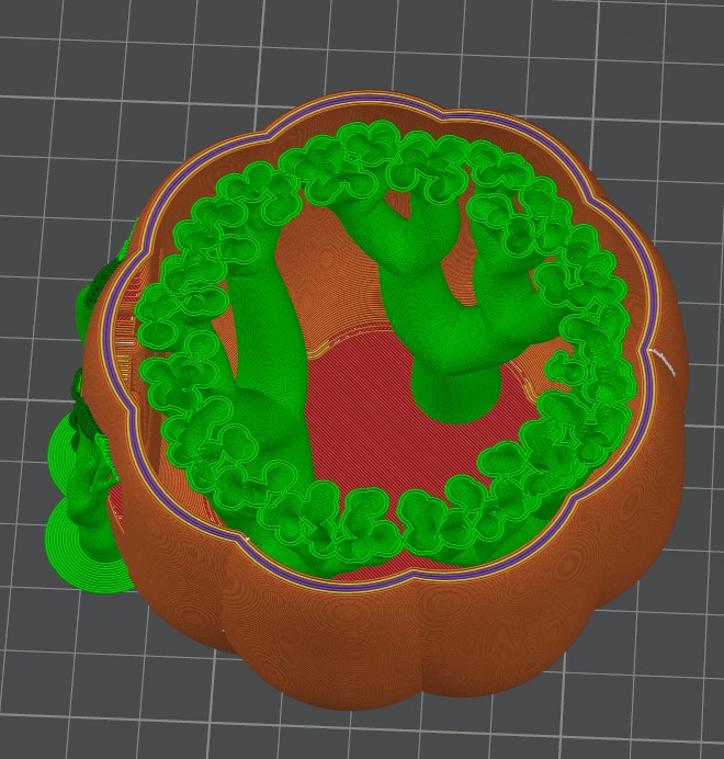

I’m stuck. I’m printing a object that need tree support so it will be easy to get the support out of the object once its complete.
However the tree supports keep falling over, I presume the first layer of the support doesn’t stick well enough. I have tried regular tree, hybrid tree and adjusted some settings to reduce allowance but to no avail.
Any ideas how I can get the first layer to fuse better with the support tree?

I am printing transluceant pla from bambu. but its not the bed temperature, because the model sticks perfectly to the plate… the tree support is starting on the inside of the model, and thats where it fails.
yeah the supports are for the inside of the model, not on the bed.
the model sticks really good to the build plate. I can’t find a option to squick the first layer of support closer against the object.
My experience for support on the part itself is still the standard support and not the tree support. The base of the tree support is too small to be stable.
Are you using specific support material (ie. support for PLA) for the interfaces?
