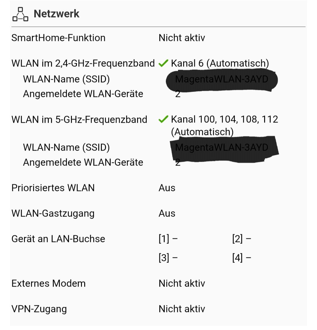

This should not be related to your anti-virus unless your traffic is somehow routed though the computer thats running it or the security software running on the router/AP.
Do you have both 2.4g and 5g with the same SSID? Do you have a wifi 6E router/AP? Do you have WPA3 only enabled? Do you have it on a DFS channel?
Reboot your router/AP just in case. I would separate the two/three bands into unique SSIDs. Also turn off WPA3 and/or make sure WPA2 compatibility mode is enabled. Its possible its trying to handshake with WPA3 and failing, then falling back on 2.4G or 5G with WPA2 and succeeding.

Probably not it, but does your router automatically assign channels to devices? like 2.4ghz, 5ghz or 6ghz channels? If so, one thing to try is to turn that setting off. Type your own ip address into a browser and it should bring up your router software. The login is usually admin and the password is usually password. Once you turn the setting off, youll have seperate connections for each channel. Connect your printer to the 2.4.

I had an issue also constantly connecting/disconnecting to my Asus router (several months actually) and only thing that fixed it was rebooting my router.
Soon as I disabled a smart connect from Asus, problem disappeared…
Yeah smart connect does have some issue (not only just with H2D, but also many of my other devices). I separated it soon after.
Yes band steering (its official name on most routers) should be turned off when you have legacy wifi devices on that network. Its will try to push those devices to an incompatible frequency due to handshake problems.

Try connect to the 2.4ghz one or reverse. You might have heavy interference or blockage or both
Basically it has own 2.4GHz.
Nothing Phone 2 has 2.4GHz because, testing purposes. :smiley:
Did you mean it like that or?
