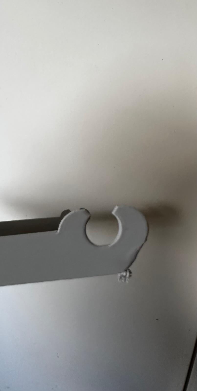

The issue is that I can’t get the curved part to come out fully smooth and round—it ends up slightly angular and uneven. The automatic supports generated in Bambu Studio don’t seem to help. The part also needs to be a single solid piece, as it has to withstand weight.

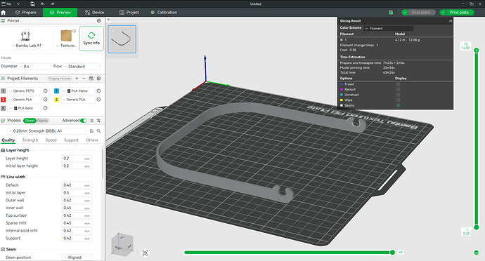

Could you send a picture of your item in the slicer when it is sliced?
Already tried it, it doesn’t help.
From what I see in the image… you item should not even need support. Do you have a picture of your build plate as is right now + of your slicer when the model is sliced?
Thank you for the welcome, and here is the picture.
(The wall thickness is 2.5 mm.)
From what I am seeing, you need to sync your filament with your printer. Do you know how to do this? I think you are doing everything right… but I notice the filament looks off. When is the last time you cleaned your bed?

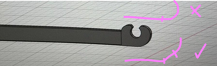

I don’t know the total scale of your object, but those rounded ends are more than 45° overhangs
I’d try taking a 45° tangent line rather than trying to build out 2.5 mm walls into free space.

Thanks to everyone who replied! I just performed the filament calibration and the K-value changed significantly, so thanks for that tip. The curved section looks much better now.
In addition to the calibration, I increased the wall loops, top/bottom layers, and infill density, and switched the sparse infill pattern to Gyroid. I believe PLA will be sufficient for this purpose since it won’t be exposed to the outdoors or temperature fluctuations.
Also, the overhang isn’t quite 45 degrees—it’s intentionally a bit steeper to ensure the bottom of the hook doesn’t hit the frame, while keeping the tip of the hook as wide as possible."

+1 on the CAD being not ideal. Anywhere you see a “Bottom of a softly rounded shape” touching the build plate you will have a problem - it creates worst-case overhangs.
Try to seperate that into two lines, one with a easier to print 45degree angle, then transitions into the arc
With this specific model, you may even be able to make the slicer do this for you all by itself. By selecting “Make Overhangs Printable,” but you really need to inspect the rest of the model in preview to ensure it didnt change anything unexpected.
