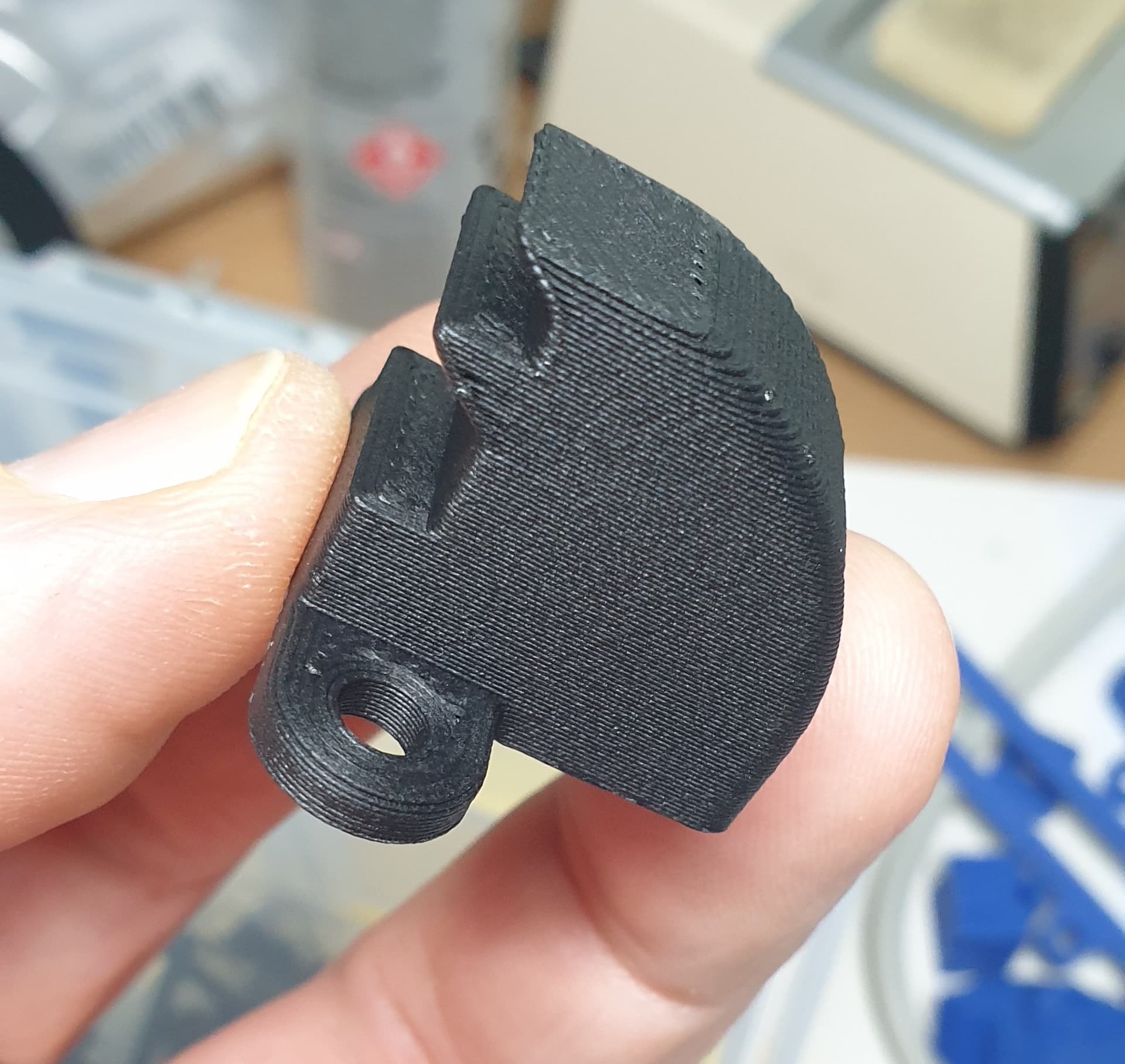

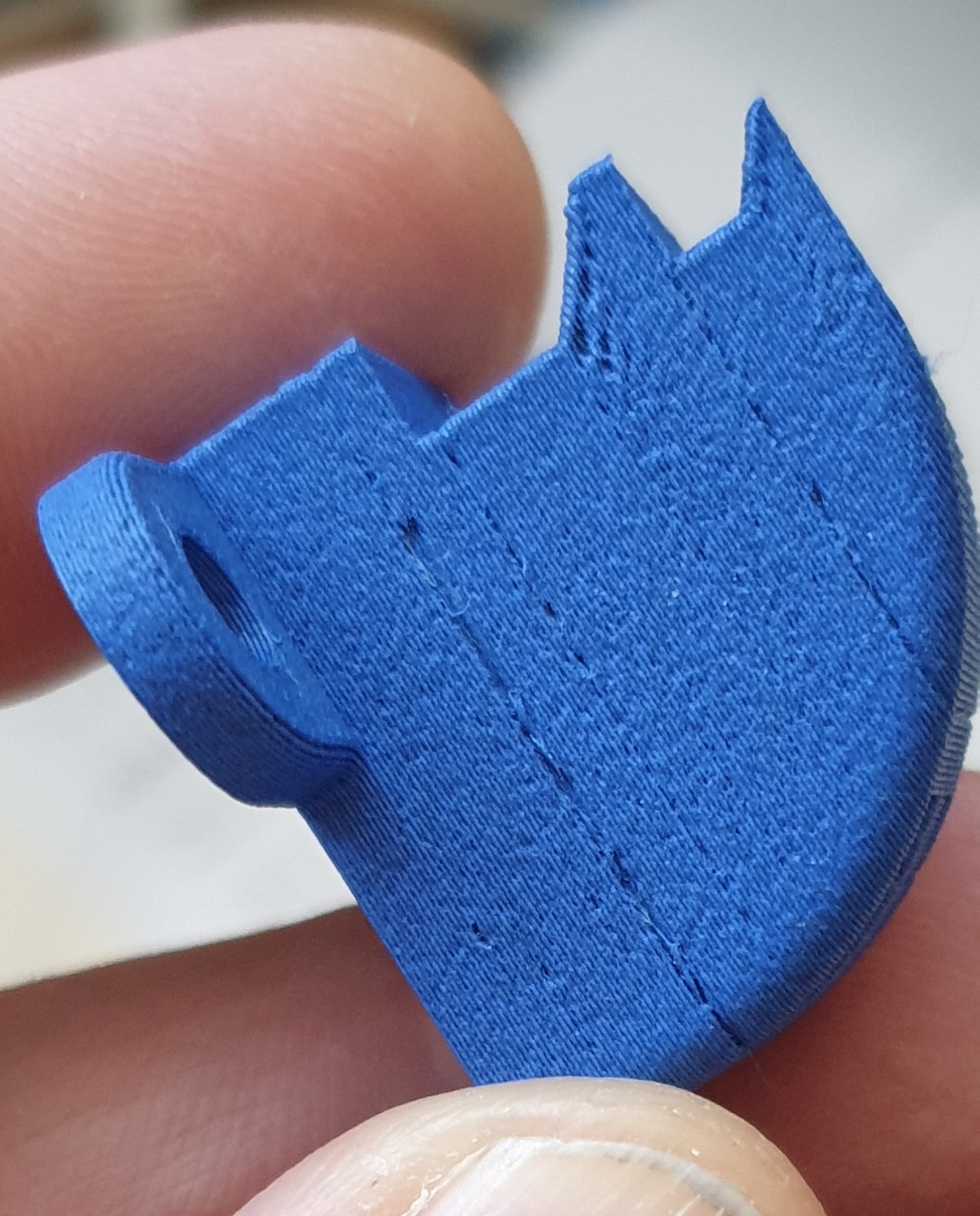

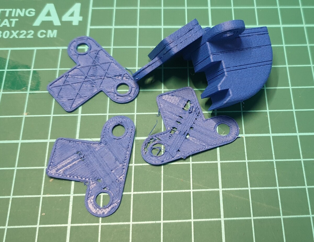

I’ve gone through a whole spool of PLA-CF black, without any trouble. When I ran out, I bought a spool of PLA-CF blue, and I’ve never had a single good print with it. I get missing sections, where the filament isn’t extruded, I get chunks and bits that don’t adhere properly to each other. I get stringing.
I’ve tried everything: 12 hours of drying, 0.4 and 0.6 nozzles, 0.2 and 0.28 layer height, lower temps (210) and higher temps (240), higher max (16) volumetric, and lower max (12). I’ve raised the flow ratio to 1.02 and down to 0.9. I’ve dropped the speed by half. Absolutely nothing makes a difference, I get missing lines all over the place, for no reason I can discern.
The black filament misses a beat once in a while, but the blue is totally useless.
I would very much love to know how I can make use of this expensive filament because I am stumped.

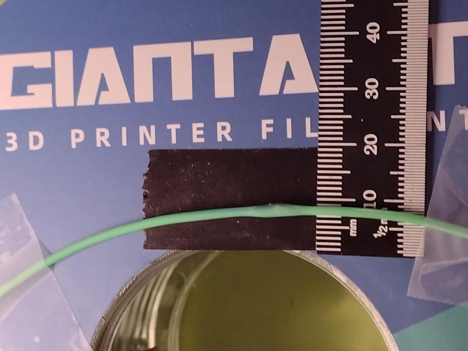

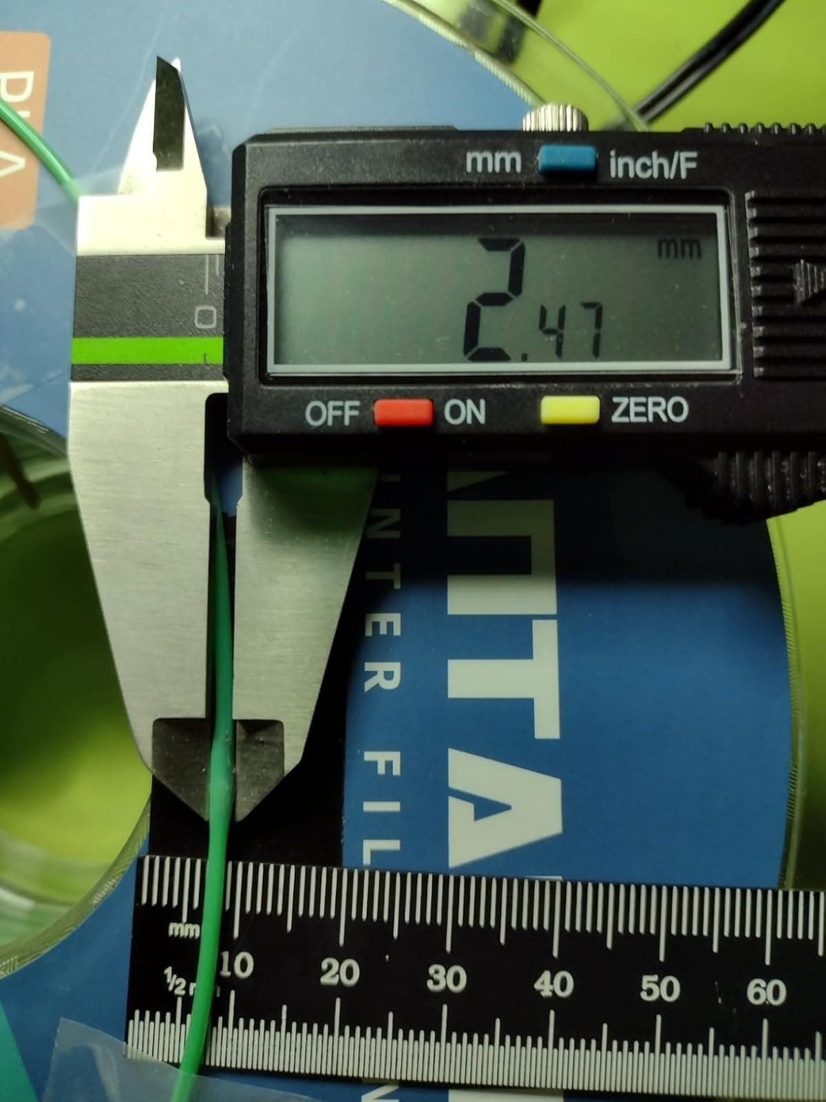

As an additional check - though this has only happened to me once, with a Giantarm multicolor PLA spool - have you measured the filament diameter? While most filaments aren’t perfectly uniform at 1.75mm, the extruder typically compensates. However, I once received a spool where color splice points had bulges up to 2.47mm, which caused jams. I ended up returning it.

You might be on to something with the overhang->wall shift, but while there’s a bit of thinness there, the missing lines and other gaps appear literally anywhere, and frequently. They’re happening on every external wall, in any location, and flat surfaces are likely to have gaps as well.

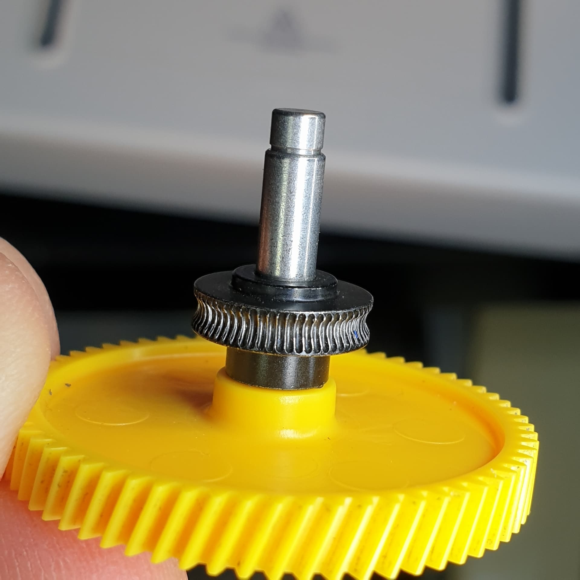

OK, so, an update, of sorts. Going back to the black PLA-CF didn’t really solve my problem, I was struggling to print it with any amount of consistency. What was really interesting was the filament hub. It was compressing the spring fully, as the extruder gear was pulling but the filament wasn’t coming through the PTFE tube. So, I took the hub apart, it was clean. The PTFE tubes worked fine with other filaments.

I’ve ordered a new extruder gear, 'cause it’s cheap and something has to solve the problem, right?
Yeah this is f**ked up. It’s happening to all my filaments now, whether or not I use the AMS, whether or not I use PTFE tubes.
This is PLA matte. It’s so bad it tears apart when I flex the plate to remove it.
Problem solved: it was the extruder gear. It didn’t look worn, but apparently it very much was. Ordered a new one, slapped it in, and all troubles gone.
