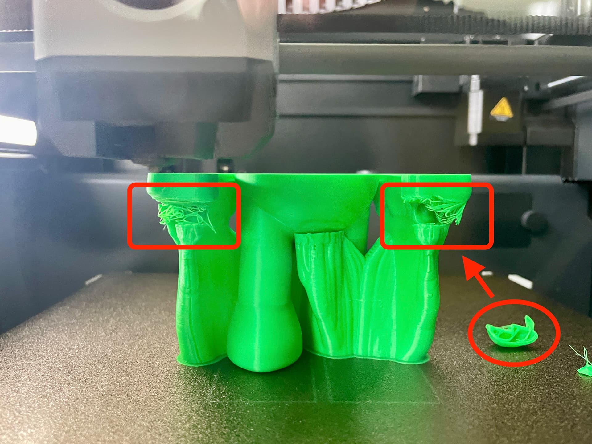

I have a doll of 15 cm high that has raised arms. Since the arms are ‘floating in the air’, I have activated support in Bambu Studio. First I used default tree supports, but when the printer was getting to the top of the supports, just under the hands of the doll, the supports came loose (both supports under the left and under the right hand).
First I thought it was the filament (Bambu PLA Basic), maybe already too moist. So I put it in my oven for 8 hours at 50 C. After that the print looked cleaner (so the drying did something), but the supports still came loose.
Then I decided to change the Support Style from ‘Default’ to ‘Tree strong’. This works much better, but obviously instead of several trees, the whole support has become one structure in this case.

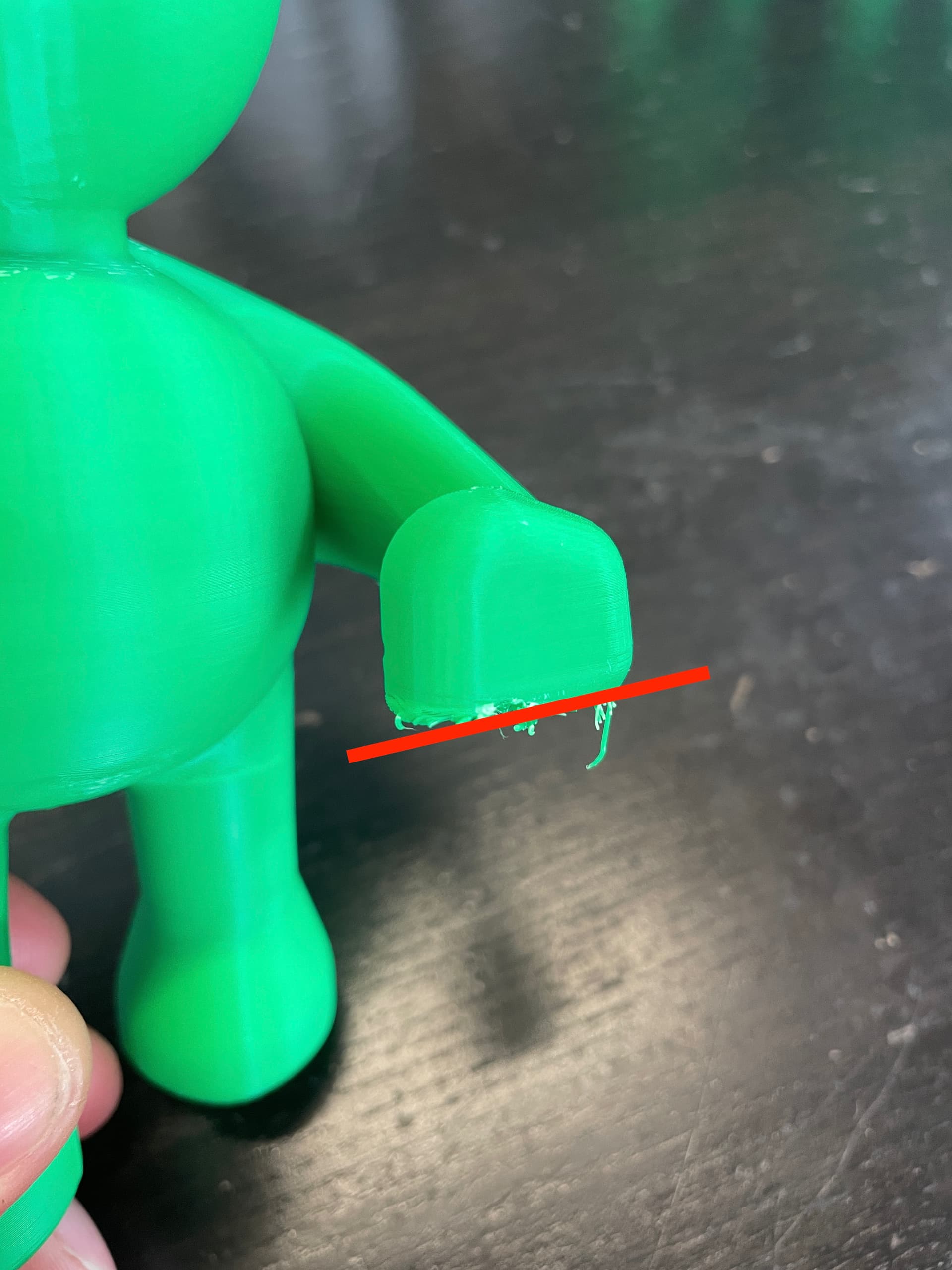

Although this looked like the solution, still something goes wrong. The bottom parts of both hands, still snap away.
The model with missing parts of the hands, while still printing the doll:

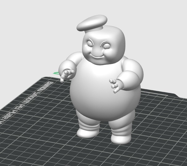

Two screenshots of the doll model in Bambu Studio:

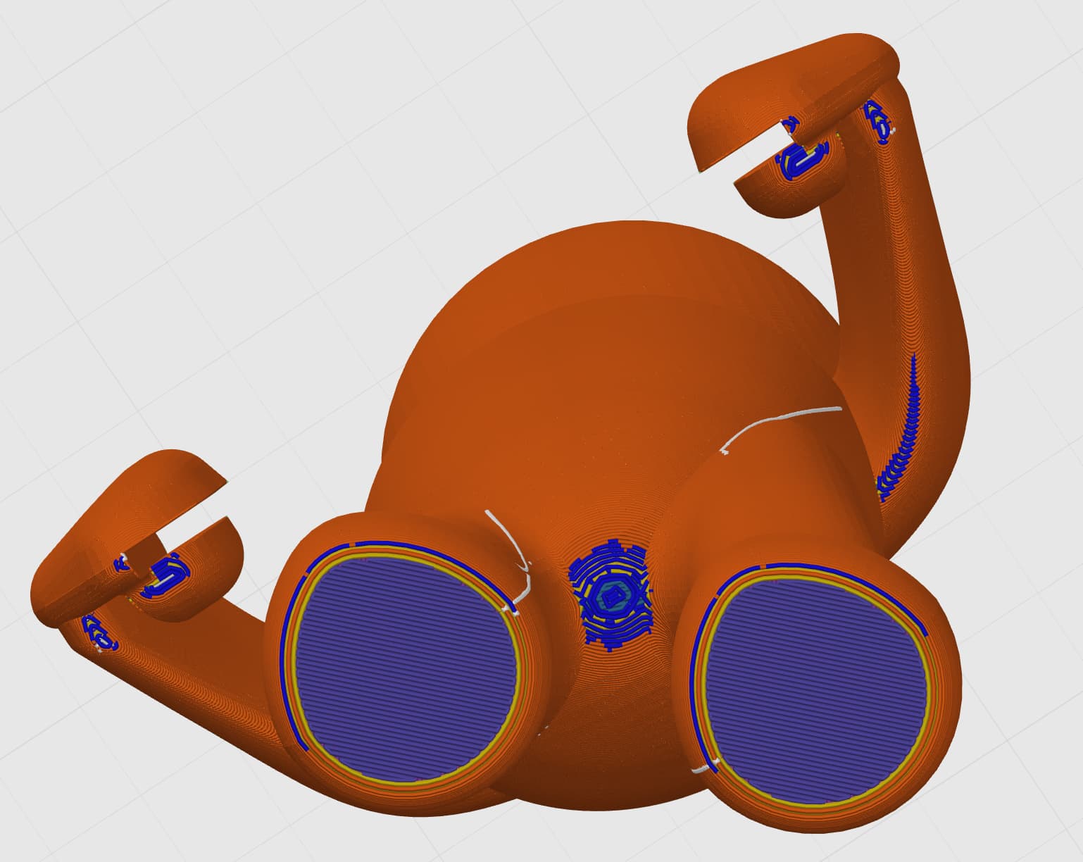

The sliced model without support structure looks like this from the bottom:
The sliced model with support structure looks like this from the bottom:
What do you think?

I found a model very similar to yours (Stay Puft from Ghostbusters 1) and fiddled with it to maybe give you some ideas.
This is Stay Puft, imported to my build plate in Studio.
From there, I enabled Supports and selected Supports Painting.
The checkerboard pattern is what Studio defined as requiring support. BUT…that is dependent on the slider bar for Highlight overhang areas. Looking at your first picture, the location and size of the tree support seems too small. I’m assuming the blue in crotch area, hands, arm are support locations.
With supports

The bottom side of the hand gets snapped away. That’s the part below the red line in the picture left, and on the other picture seen from the backside (the 2nd picture shows the hand part as it should be).
What I don’t understand is that this part of the hand is about 3 mm above the top of the support structure. So why does this part of the object also snap away?
To me, it looks like there is not enough support. Based on the small amount of blue at hands and crotch.

Painting the support areas made the difference. I could clearly see the effect during printing. The bottom part of the hands were now more encapsulated by the support structures. Not only below it, but also along the sides. I think this forced everything the stay in place during printing.
So, all well, issue solved!
