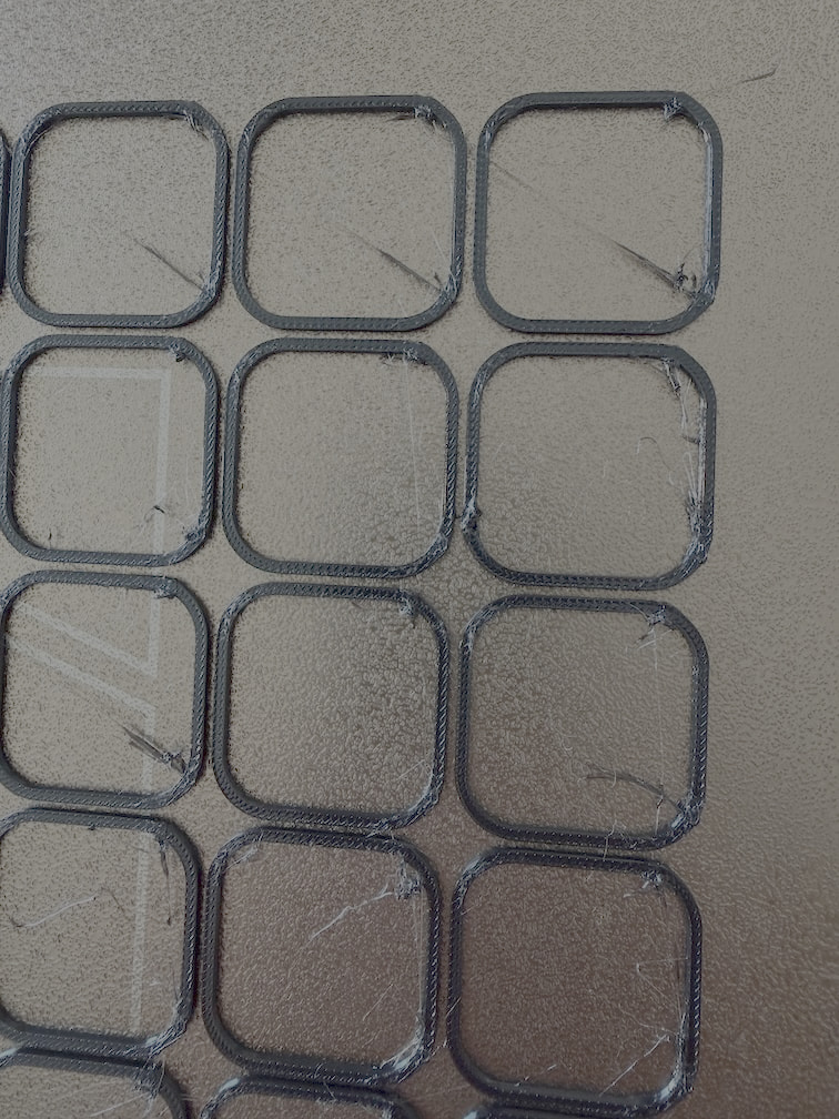

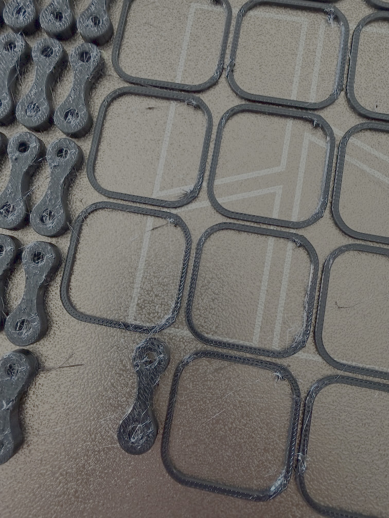

I am trying to print with TPU 95A HF on a P1S, using the textured PEI plate.
I keep getting these “noses” on each part (the rectangles are used as seals, so they need to be neat). Is there a way to prevent that?
I tried with both open and closed door.
Using all the defaults for the filament, 0.4 hardened nozzle.
TPU has been dried at 70 C for 6 hours right before use.

Dry it for longer, any moisture entrapped in th filament can cause weird blobbing.
Then you’re going to want to do flow rate and pressure advance calibrations for that filament.
Also could try increasing the retraction distance by small amounts and perhaps retraction speed.
And slowing down the print speeds in general, depending on which process profile one is starting from (low layer height “high quality” profiles tend to have slower speeds already).
-Max
I will also add to ‘print by object’. It may be slower but eliminating those “empty moves” can reduce the problem.
I dried it for another few hours and then did a calibration. Had to change the K value to 0.3.
Now the prints come out quite good, and without any noses.
I had not considered calibration because I did read lots of people saying that they used the default settings and had no issues.
Thank you.
