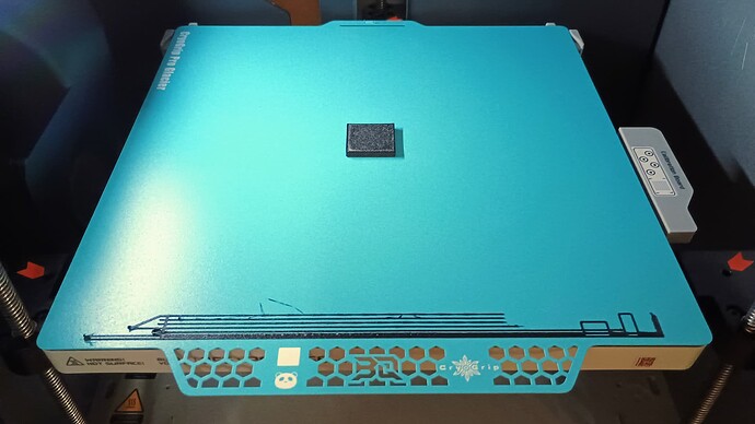

Plate came today, not as smooth as you would think.
But it does have a smooth surface on the print.
Purge line could’ve been thought out better.
@JonRaymond
maybe you have a gcode edit I could use :wink:
Well, that’s not good. On my P1S, I do see that the test strip is very near the front handle, but that’s not my issue. I lays the test strip down beautifully, but then it stick to the nozzle and gets pulled into the first layer of the print. If I catch it right away and pull it off, the rest of the print adhers very well. I’ve wash between prints, and I’ve tried various temps for nozzle and bed. I’ve made sure the nozzle is clean with brass brush, but it keeps doing this. I’ve done flow calibration tests (no issues, still .02 K value is fine). Anway, I’ve opened a support ticket with BIQU on this.
Have you tried increasing the bed temperature?
I think that might help the purge line stick a little better.
I have not seen this behavior with ABS but I run the bed at 100 degrees.

Yes, I tried 55C, raising it higher seems counterintuitive since this is supposed too be a “cool” plate (and the rest of the plate has good adhesion). I think the plate might have a coating issue near the front, but who knows? It looks perfect. If BIQU support can’t give me a solution, I may reluctantly return it and get the Bambu SuperTack.
I don’t have an A1 mini but looking at the start gcode, you need to move the Y location in 2 spots.
This will move the final line slightly into your build area (1.5mm) but in most cases it shouldn’t be a problem.
