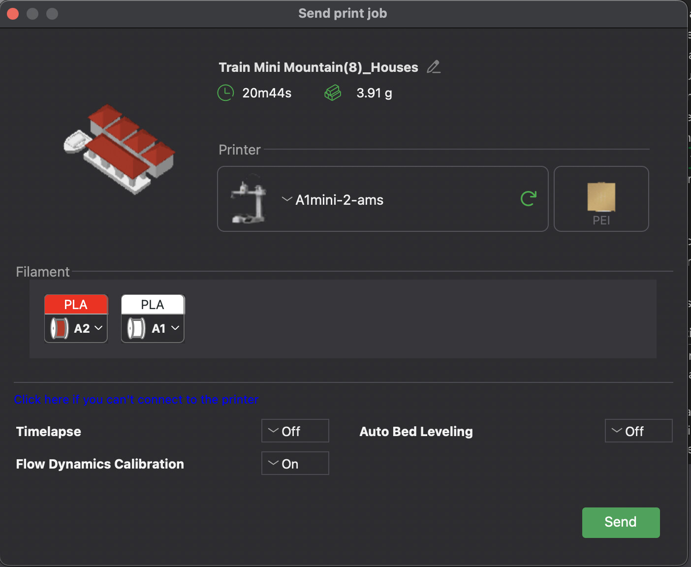

Since I’ve updated to Bambu Studio from v2.0.1.50 to v2.0.2.57, my A1 mini is unable to use the AMS lite.
The software and the printer can see the AMS lite and I can load filament on it but every time I try to print a multi colour print with the latest update, Bambu Studio tells the printer to use the external spool which is empty.
The only way that I’ve found to print using the AMS lite id to use the Bambu Handy app.

Screenshot of Bambu Studio before sending to the printer:
Error received
Error code: [0300-8015 184818]
There used to be a check box to say “use AMS lite” but this is now gone.

Hmm, I’m having this issue as well.
Looks like saving as gcode and printing via the sd card works fine, like you say.
Oh forgot to say I have an A1 which it is happening on, and Windows is what I’m running bambu studio on.

Just got an update for Bambu Studio and the problem has been solved.
What version of Bambu Studio fixed this for you? I had to downgrade back below 2.x to me able to use the AMS lite I added to my A1 (windows 11).
I got version 2.0.3.54 now and the problem is gone.

I can also confirm the problem is now gone by installing the newer version which is 2.0.3.54
