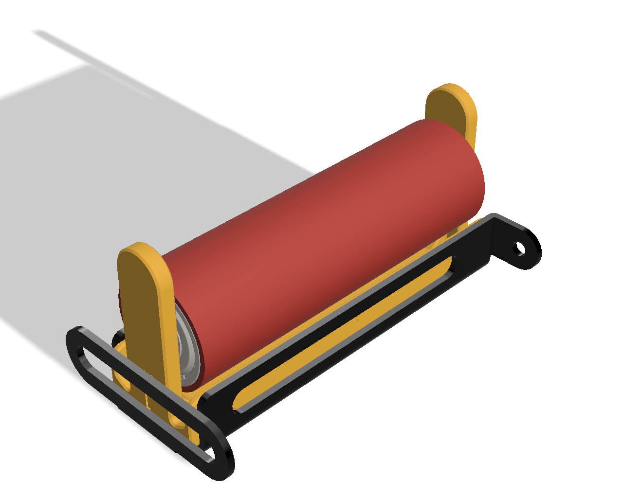

I printed a few kilograms of filament already and never had any problems, but for some reason my prusament spool kept getting stuck in that groove on the spool:
Turns out that you are not supposed to mount the holder like this
but instead like this
I am posting this in case someone else has or will have this problem, but I guess that is a rare issue
To your credit, many of the “roller bearing” spool holder modifications do mount the spool holder in this orientation.
