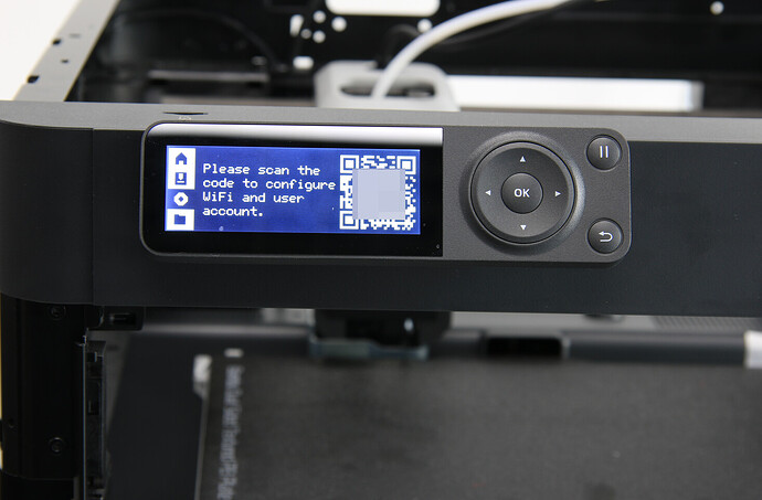

Unable to connect Bambu Handy phone app to printer
My X1C and my phone are on the same network. When I try to find the printer from the Bambu Handy app on my phone, it cannot find the printer. It then says to scan a QR code, but I cannot find a QR code anywhere. How about a hint as to where the QR code might be found?
Jon
It’s kind of hidden, sign out of your account via the display and a QR code will display to link with your handy app and log you in.
Thank you! Sign out of my account on Bambu Studio, on the Bambu X1C, or on Bambu Handy?
Jon
On the X1C. (20 characters)

Where is the P1S QR code for the Bambu Handy app?
Welcome to the forum.
Select Account Configuration from the system settings menu.
Does that work if I’m already logged on? I’m trying to attach a second phone.
