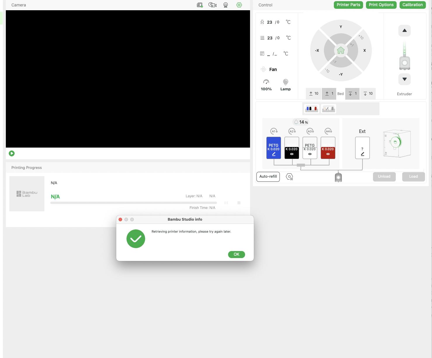

I’m not able to load/unload/move the bed or head, refresh filament in the AMS using either the Handy app or Studio app on the P1S

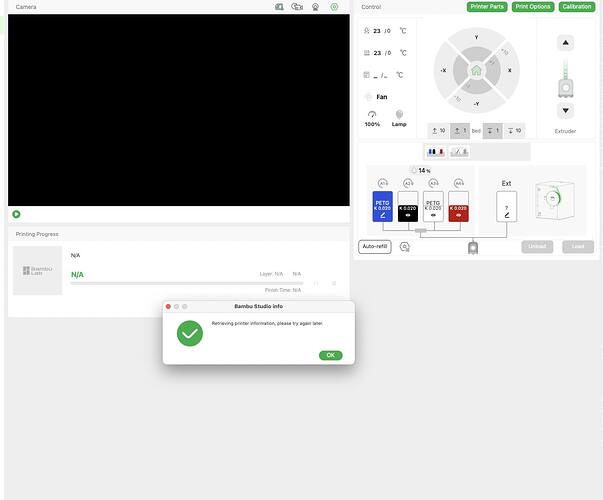

All Iget is this error “Retrieving printer information, please try again later” in the studio and a simple “error” in the handy app
I power cycled the printer didn’t solve the issue
I factory reset the printer and that didn’t solve the issue
I uninstalled and reinstalled the apps and that didn’t solve the issue
I downgraded to v01.07.00.00 and now I’m able to control my printer/ams
What’s interesting is that I noticed I was not able to raise/lower the bed, move the head, load/unload filament, but I was able to at least refresh the filament in the AMS. Now I can’t do anything at all except send a print and view the camera.
