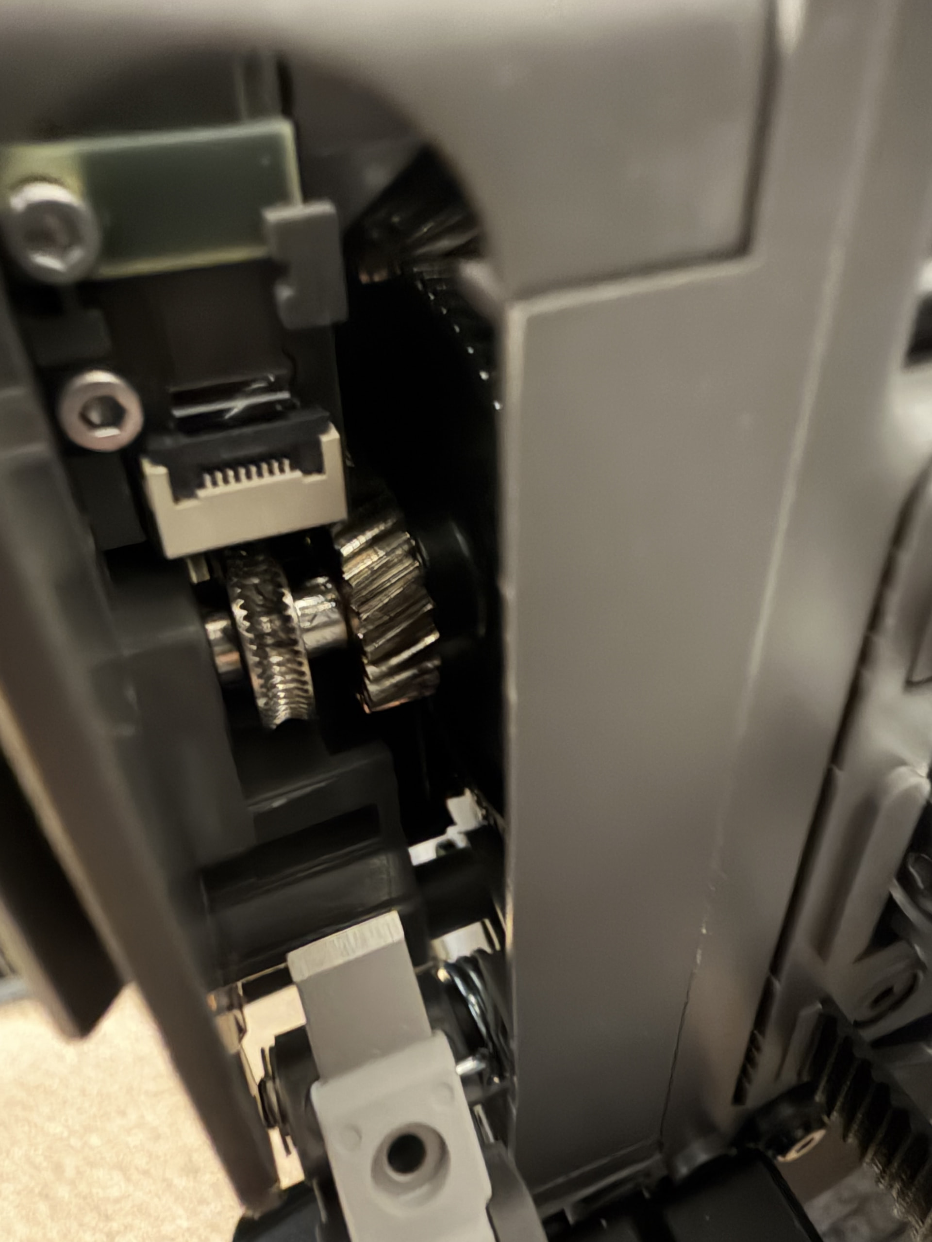

Assuming there must’ve been a clog in the extruder I followed everything up in this video (https://www.youtube.com/watch?v=R7Vteb8Lzw0&) until 1:10. Looking through the side the gears looked completely clear, no crumpled up filament and not even a normal strand of filament passing through them.

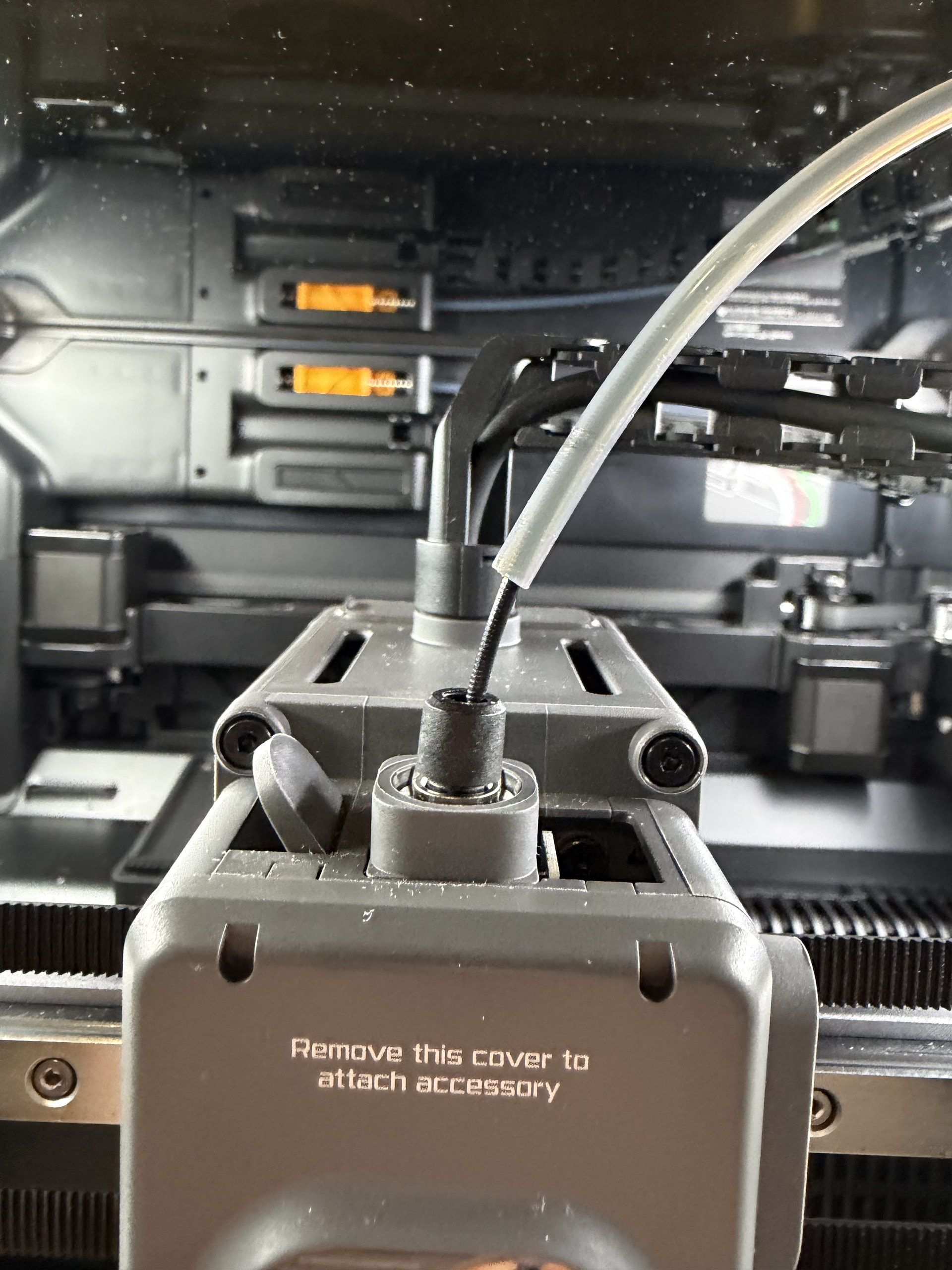

Would this mean it’s stuck in the filament sensor or can there even be a clog there? Really hoping I don’t have to mess with that as apparently the ribbon cable is super sensitive/easy to break and the filament sensor replacement video is overwhelming me just looking at it lol. So far I released the PFTE tube and tried pushing down and pulling up on the bare filament but it only budges about a millimeter, I’m not sure if I’m supposed to pull or push a lot harder on it to free it (have only tried using a few pounds of force) or if it’s supposed to come out gently. Any advice?

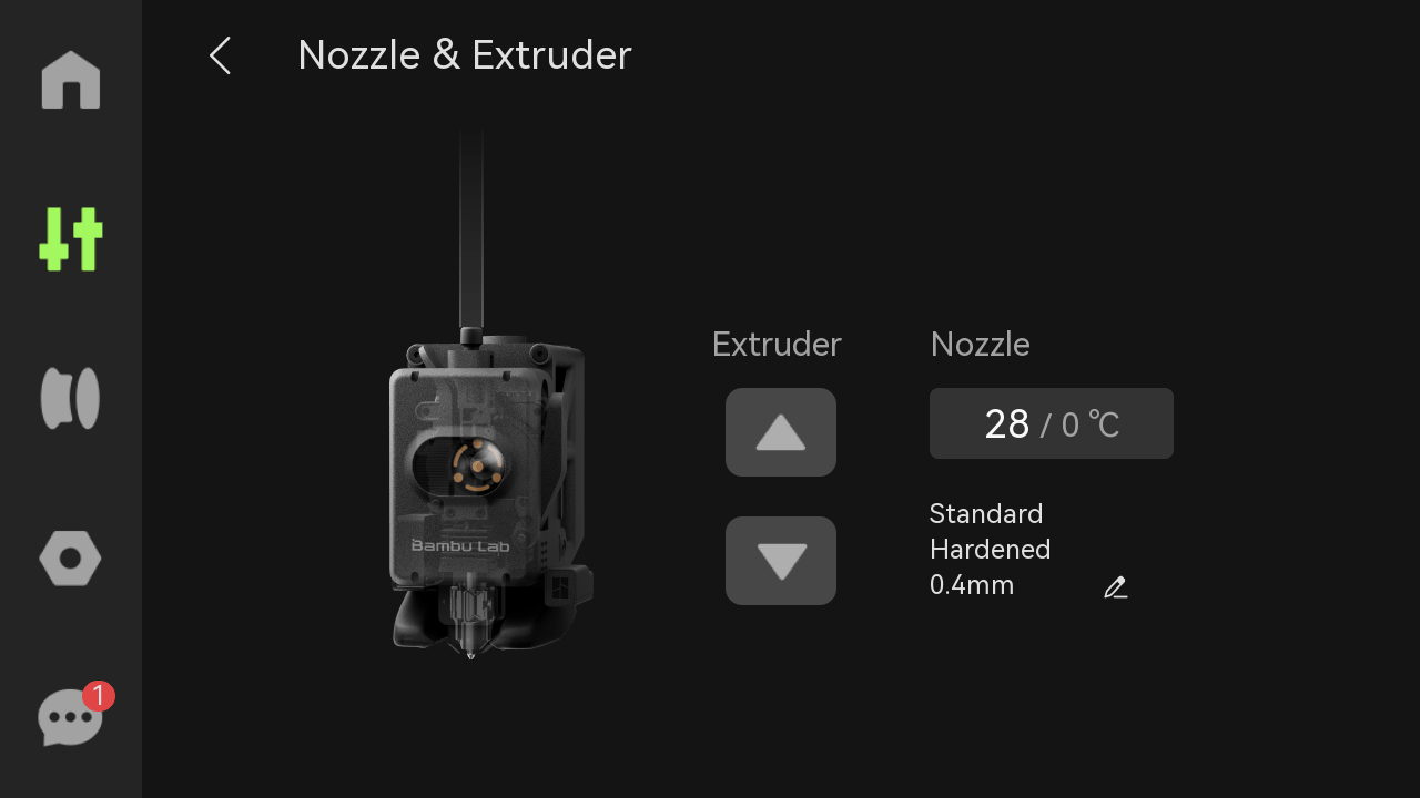

If you manually activate the extruder gears via the display, does the filament move?

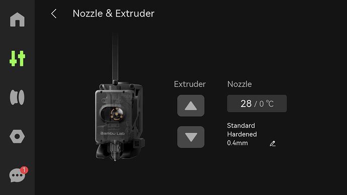

You may simply need to back the filament out of the gears. If there is a clog between the gears and the sensor you may be able to cut the filament above the extruder and use the display to push the filament out of the bottom towards where the nozzle would be.
Thanks! Yes I do have the nozzle off and the filament was successfully cut with the cutter early on, I did attempt to activate the extruder gears through the display before I took anything off and could see the orange wheel spinning but both the up and down arrows were unable to move it in either direction unfortunately.
Made a cut above the toolhead, was able to manually push it down 1-2mm then tried extrude down again and it worked, thanks!!
Sometimes the extruder can “eat into” the filament and thus lose the ability to grip it to reverse/push it. Moving the filament a little up or down can help the gears to grab the filament.
