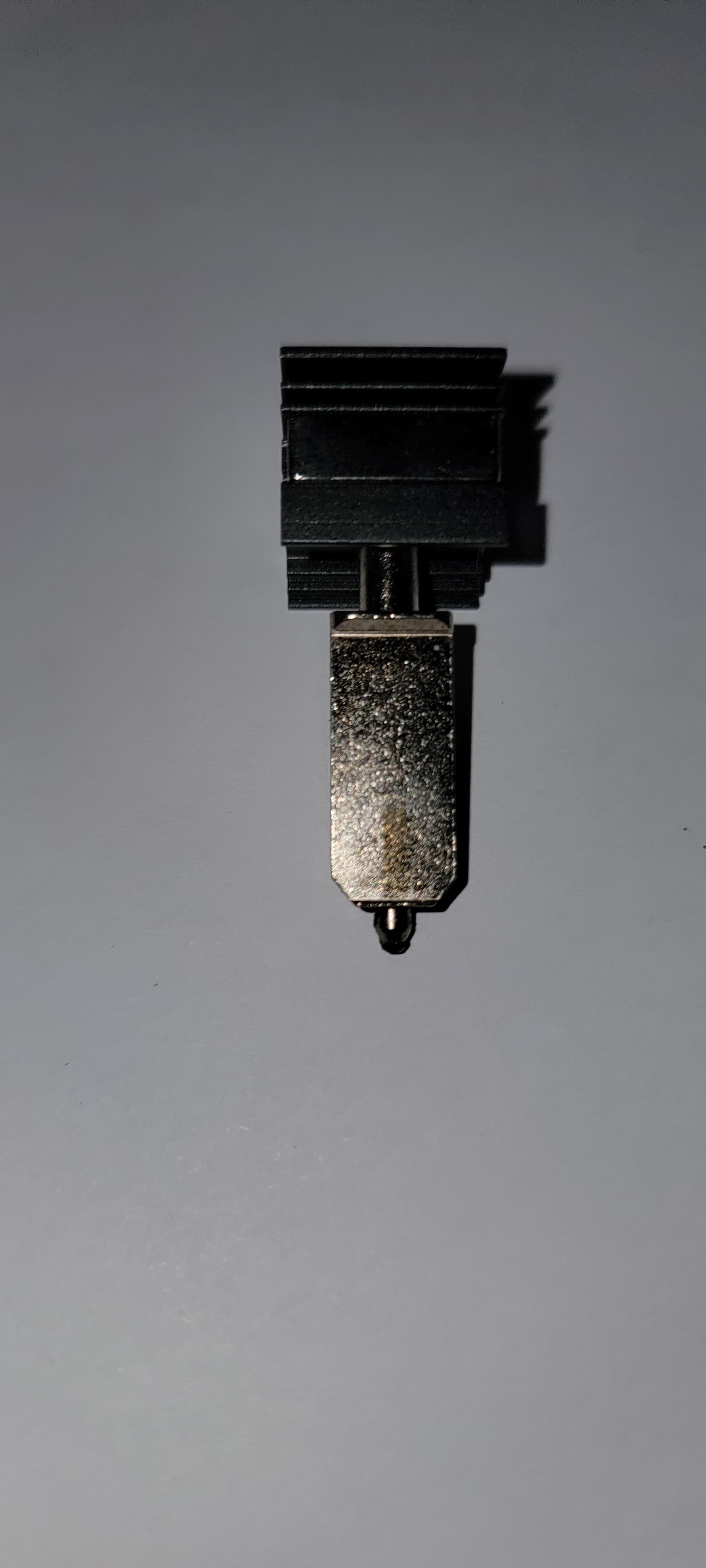

Unable to remove 0.4mm H2D nozzle hotend
Do you mean inside the printhead?
I mean this stuff on the tip of the nozzle, also check the back where it meets the heater block.

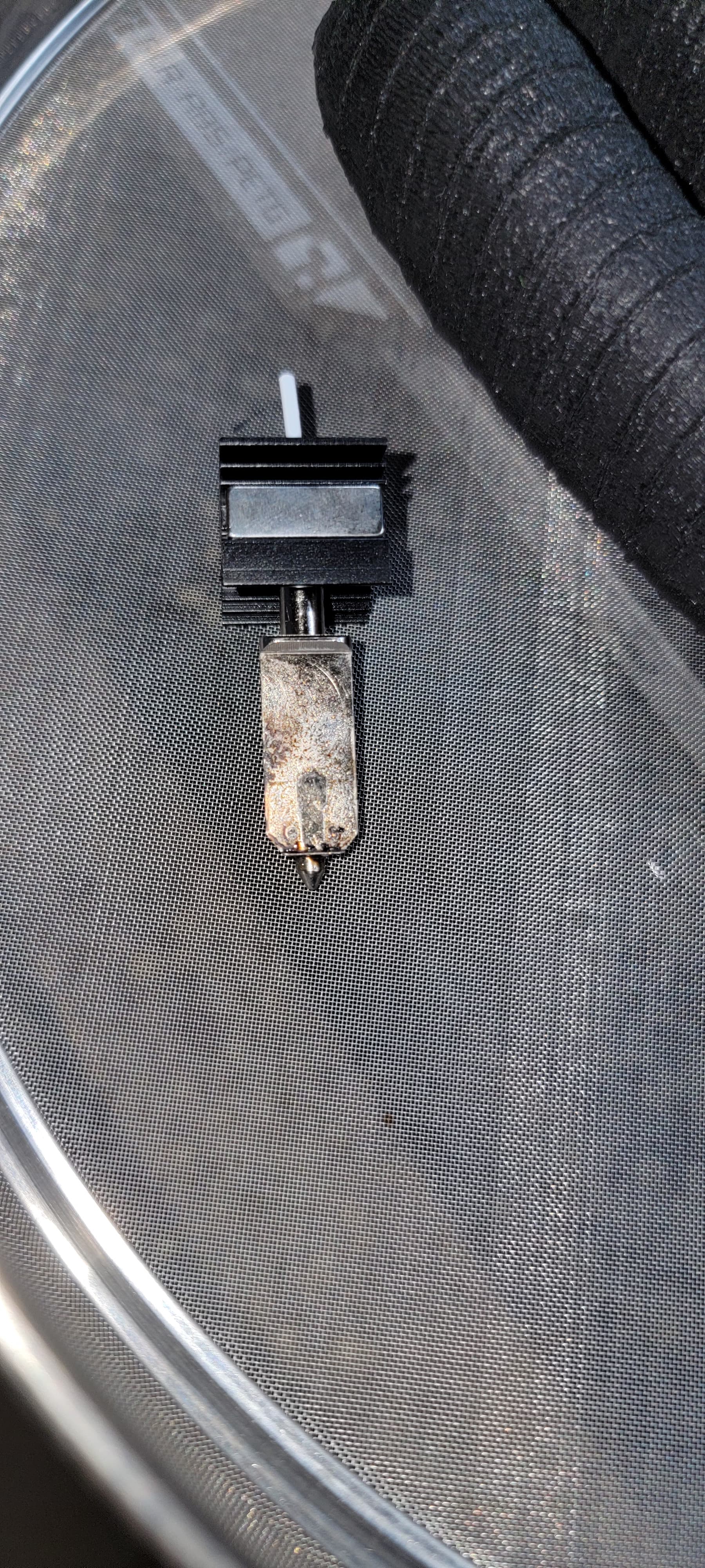

I have 10kg of dry ice coming on Tuesday with gloves designed to stop the burning from the other end of the scale!
I had 10kg arrive on Thursday without the gloves and lost some of the tip of a finger because I thought they put the gloves in with the ice.
Safety first.
From another glove making a similar claim:
Looks as though the dwell time figures into it pretty strongly.
Can anyone recommend a less “lossy” glove for this type of application? One that won’t leave part of itself behind on the nozzle/hotend?

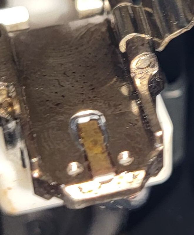

Well, now that you mention it, I took a closer look, and it does appear that maybe there was some kind of “crud” on both surfaces. Maybe it’s what was sticking them together? This was the original nozzle, installed at the factory. This was the very first time I had it off, so I’m assuming it was either crud from the factory, or maybe vaporized plastic found its way there?
What do you all think it might be?
Here, I cropped them to make them easier to see:
Dang. no good. At first, I thought maybe from abs and asa fumes, but I print mostly abs with mine. Maybe it wasnt seated perfectly and left a gap? Im lost on that one. looks like something made its way to the top of the seat. Have you had a giant blob lately?
That bottom lip on the mating surface side of the nozzle should prevent this
Could it have been PPS fumes or microplastics that found their way there from the left hand nozzle while printing Bambu’s PPS-CF?
I would check the other nozzle and see if it looks the same. I havnt printed any pps. Its still new to me. I havent even done basic nylon yet with the h2d
That was my thought, maybe clean it with some IPA and check it frequently to see if it happens again.

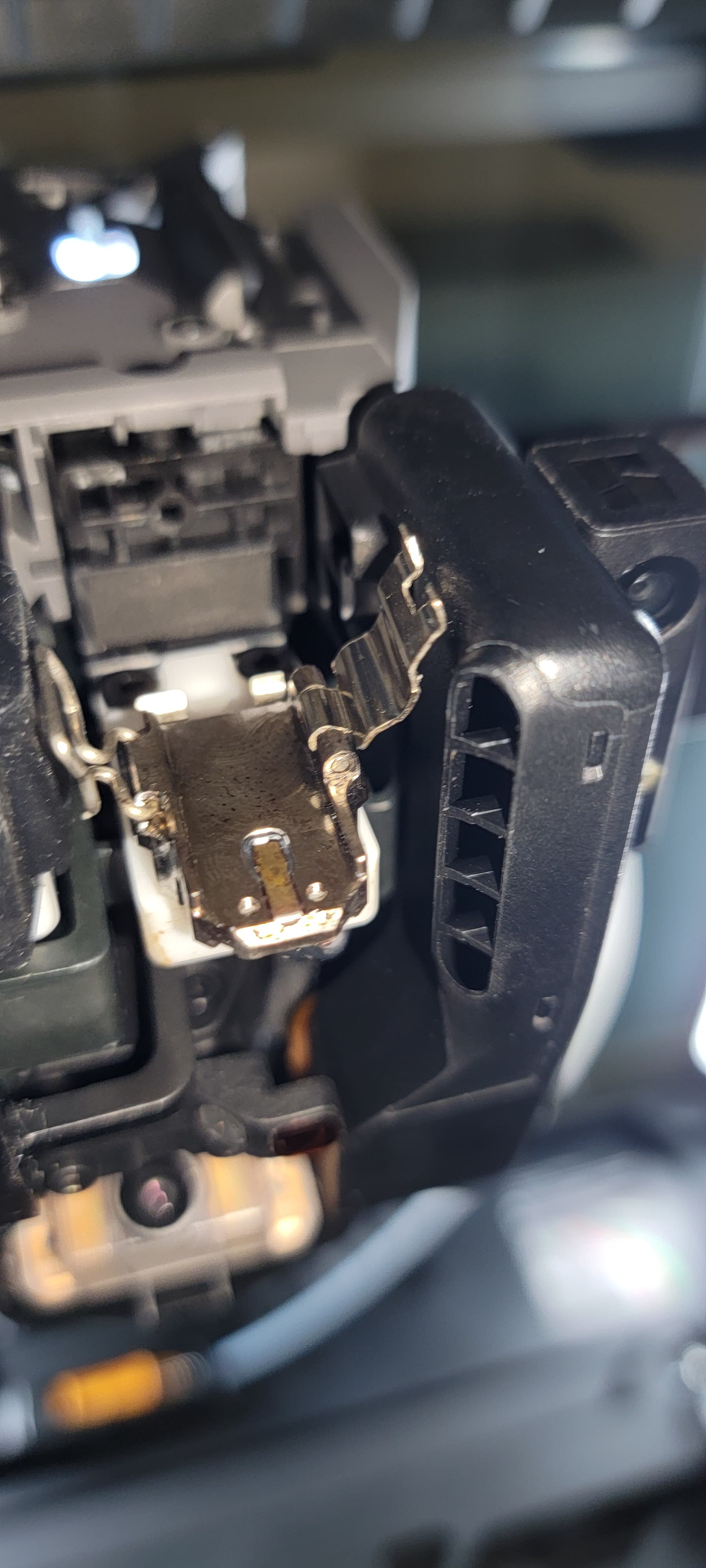

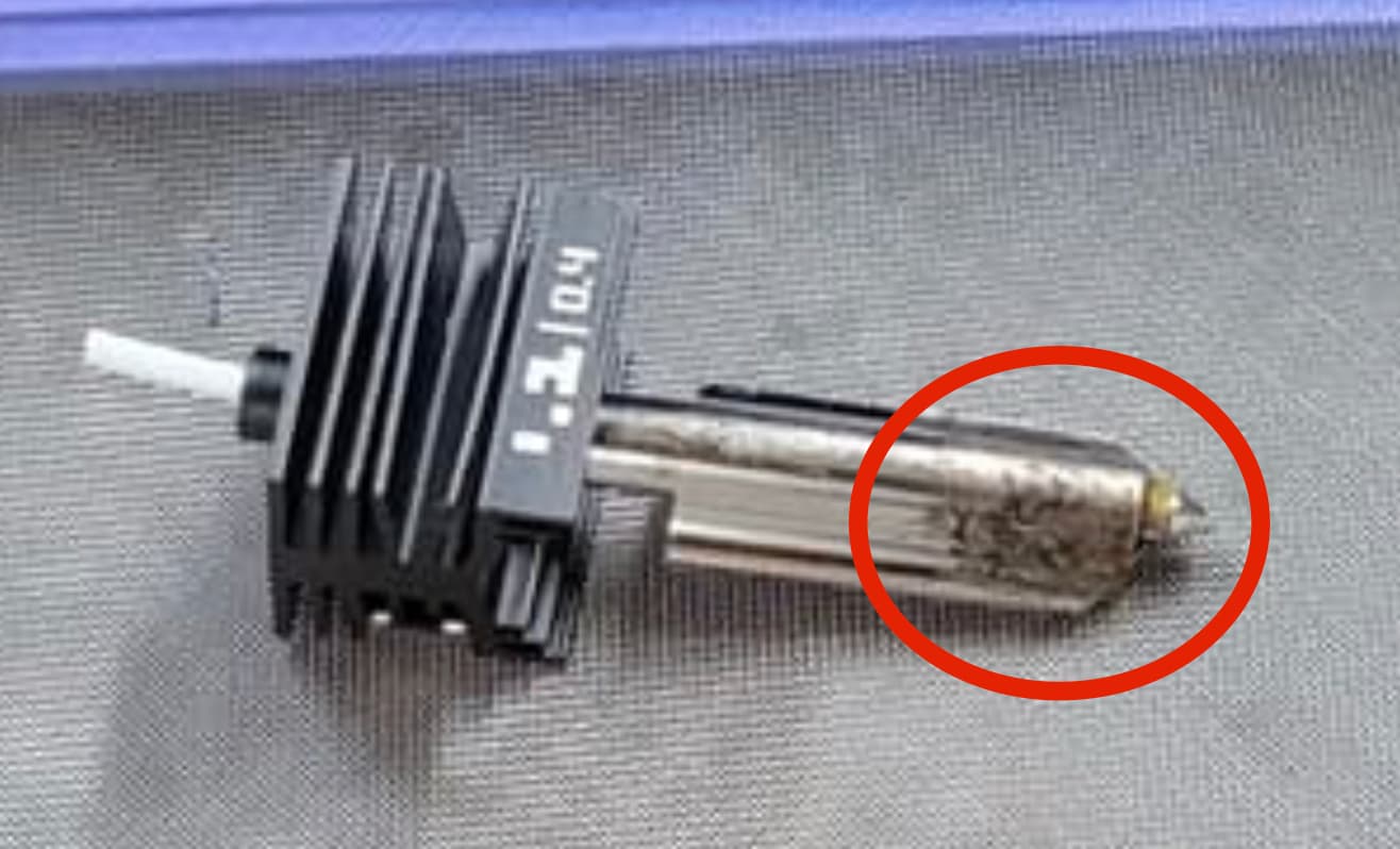

The left nozzle shows only trace amounts of crud, aligned with the bottom part of the melt zone:
but is otherwise pristine.
100% not PPS PMs and VOC film. I’ve seen this on other printers in one way or another. I’ve seen this on non hardened A1 nozzle and stock P1 nozzle.

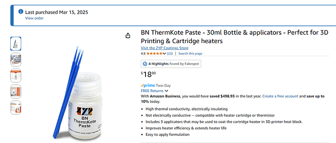

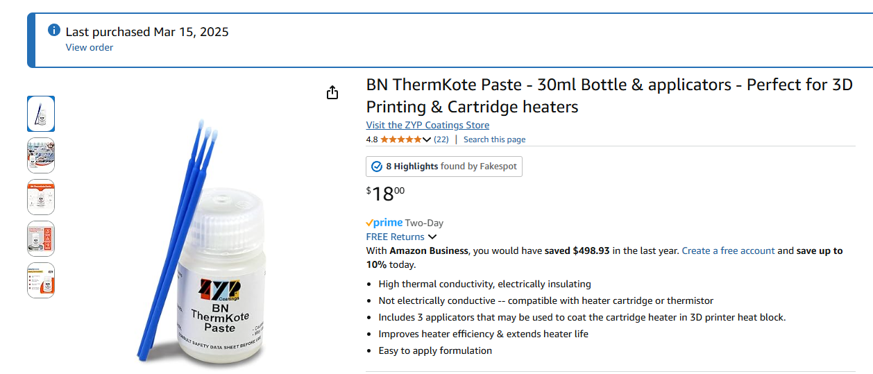

I really despise A-style nozzles as they are more prone with leaving insulated air gaps and leaking out. So what I did with my A1 is I actually used high temp TIM… but I don’t think it will work for you, since it pretty much means the nozzle is non-removable (removable, but it’s messy).
You mean something like this?
As long as it doesn’t drip down and create its own mess, I’d be open to trying that as a preventative. I mean, it should fill the gap and prevent the crud from building up and sticking the nozzle to the mating surface, right?

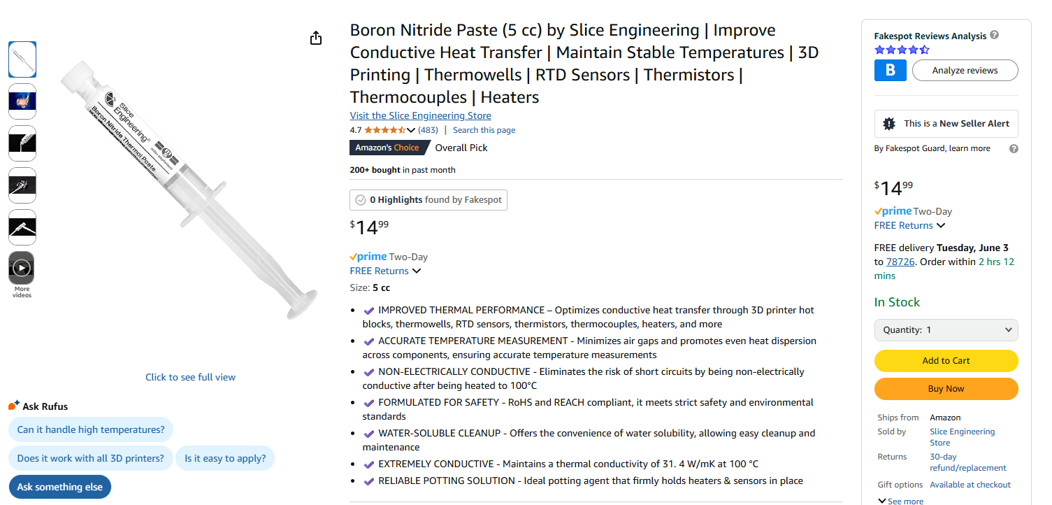

If you decide to experiment, I like slice engineerings boron paste
OK, sure, I’ll order it. As long as it doesn’t dry out, it should last quite a while I imagine.
They’re both boron nitride, but maybe Slice’s is better.
