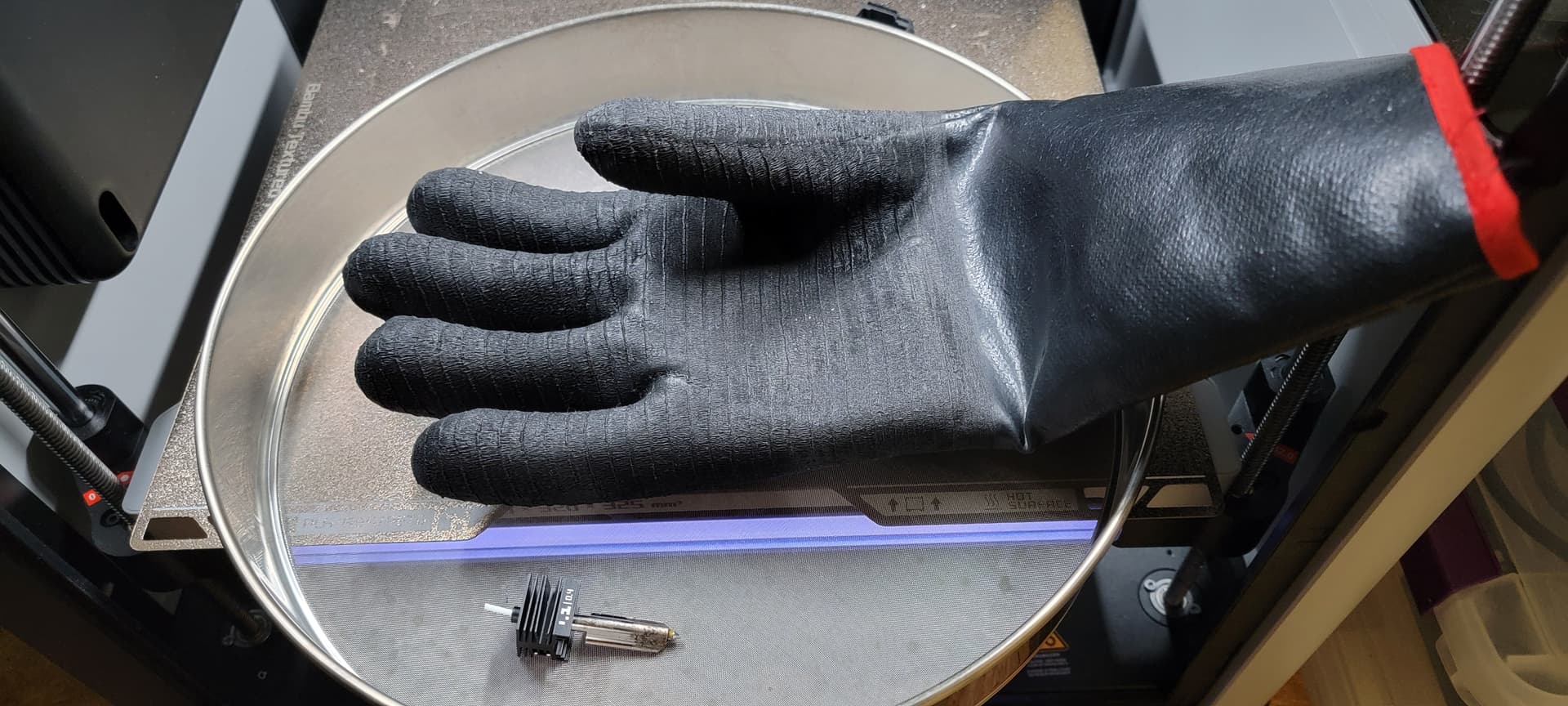

Is it OK to remove it while hot? I have special BBQ gloves that would avoid my getting burned. They’re clean.

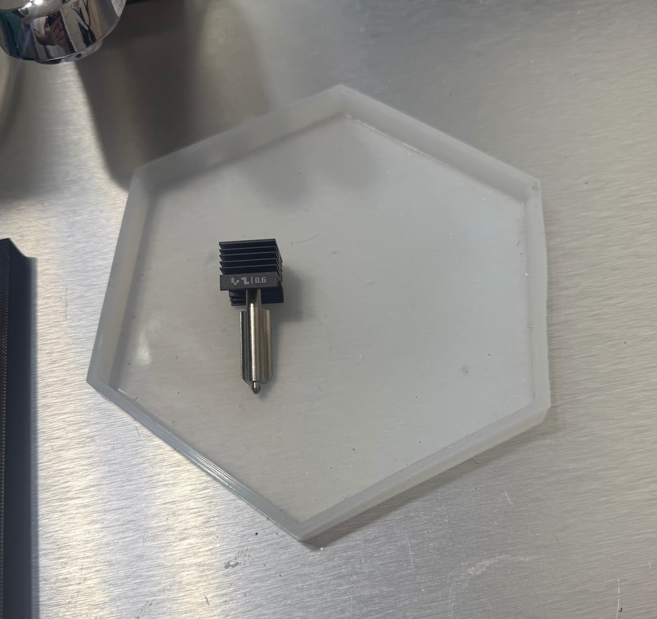

Ya its fine… I actually have a silicone mould beside the printer that I put hot nozzles into after removal so they dont burn anything.

Heated it to 260C and then pulled it off with the high temperature glove.
