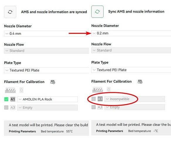

I think you are referring to the Bambu calibrations tab? Where the options are Flow Dynamics or Flow Rate ? Once you have your filaments proper in the Device tab, sync it from the Prepare tab. Then in the calibration screen below the text Filament for calibration are icons representing AMS and External spool. Once you select the external spool it will change and show you only a single drop-down selector labeled EXT.
What do I do if the filament for calibration says it is Incompatible.
I’ve not seen an incompatible message before, but playing around I was able to cause it, so there may be other reasons / ways to see an incompatible message.
First, be sure to have your AMS and nozzle information sync’d. I have a custom profile for Amolen PLA Rock. This profile is for a .4mm nozzle only. There has been no profile created for any other size nozzle. In the calibration screen, selecting a nozzle diameter for any size other than .4 it reports back incompatible because I only have a profile for the .4mm nozzle.
