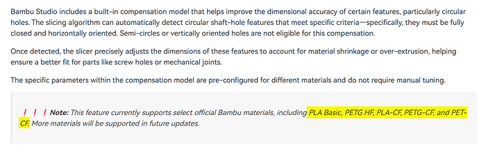

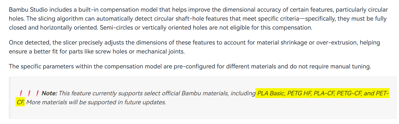

When printing circular holes, there is a feature in Bambu Studio that can help achieve higher precision.
For more details, please refer to the link below.
Auto Circle Holes-contour Compensation | Bambu Lab Wiki

According to the Acadamy, the automatic hole compensation only works for a limited set of materials.
Only other option you have is using the other compensation paramaters.
See this chapter of the academy: Bambu Lab Academy - Course Chapter | Bambu Lab

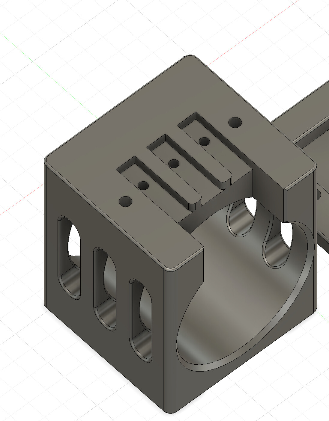

Just found this thread… Yes my H2D prints undersized holes, and even not to the right depth. I have a few models that use 2.5mm verticles holes at 5mm deep. On my 3 X1Cs and 2 P1Ss they print correctly (by correctly I mean the holes are oversized by .25mm diameter to begin with as that is what I found to work on those printers). But my H2D is not getting to the correct depth or size. Honestly, this is easy, just change the hole in my cad program, but now I need a model for the H2D, and then one for the rest…
well, maybe upload your 3mf file…?
What’s your layer height?
And what is the depth you are measuring?
I guess that’s why @hotellonely is asking for the .3mf file.
Hole depth is 5mm, layer size is 0.2mm. Hole diameter is 2.25mm. Ends up slightly under 2mm in diameter on my X1Cs and P1Ss. I have a P2S coming that I will test on that as well. Ends up under 1.5mm on the H2C. I screw m2.5x5 screws into these holes.
Like I said, I have been printing a varaition of this model for years, starting on an Ender 3. Hole size and depth have not needed to change until meeting the H2D. And, depth really can’t change, the holes are above a circular cutout and can only be so deep before they would protrude into the cutout region. Which can cause some print defects.

I would stay away from the xy hole compensation. It can mess up other parts of the print. As an update (since I picked up an H2C and need to fix the issue for it as well), the auto circle contour-hole compensation has been working well in the H2 series. Interesting enough, the P2S prints holes like my X1Cs.
Back to the auto circle contour-hole compensation, that is a mouthful, it corrects quite a bit. Now the hole sizes are even closer to my CAD files, requiring less oversizing in CAD.
