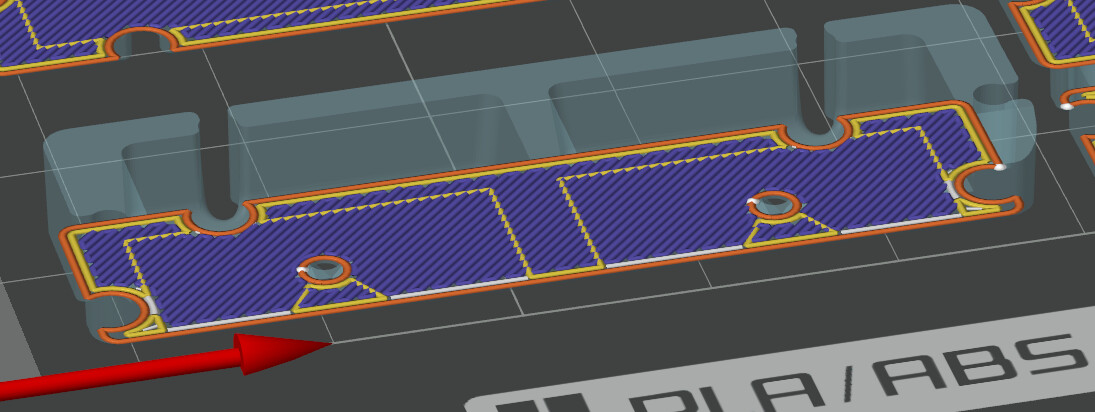

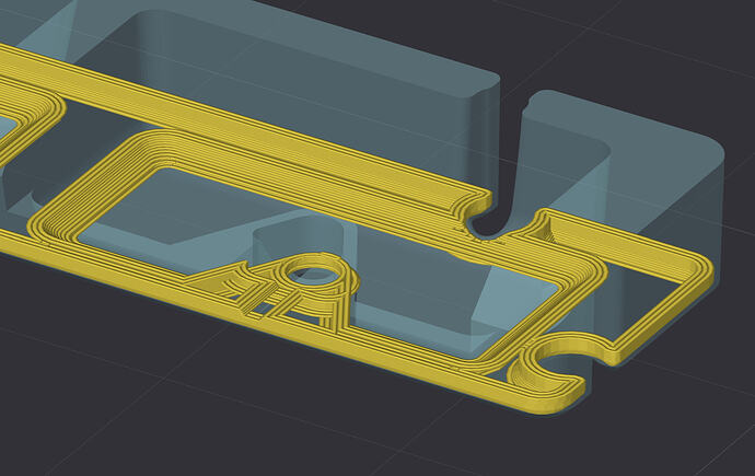

I’m starting a new project printing TPU on my Bambu Lab H2D, and while it seems to work in principle, I’m getting strange artifacts in the first layer preview.
The problem:
Features from higher layers are appearing as internal walls on my bottom layer (see image). This creates unnecessary structure and overhead that shouldn’t be there.
What I’ve tried:
  • Imported the model from Fusion 360 as both STEP and STL format - both show the same issue
  • Toggled “Detect thin walls” on/off in the slicer - no difference
  • The model itself is a solid body in Fusion 360 with no internal features or pockets
What I expect:
Just a simple inner wall, outer wall, and bottom infill - nothing more.
Question:
Has anyone encountered this before? Is this a mesh/export issue, or a slicer artifact that I can safely ignore? Any suggestions on how to fix it?

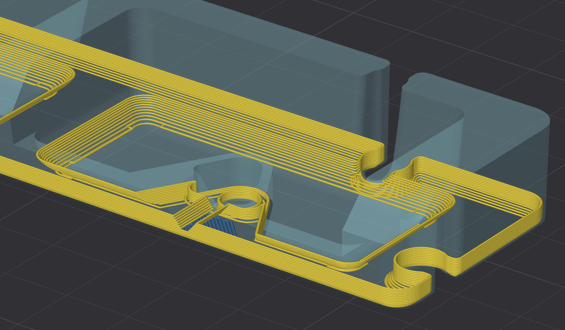

Okay, then let’s take a look: This is how it looks right now. This is what the inside of the wall looks like:

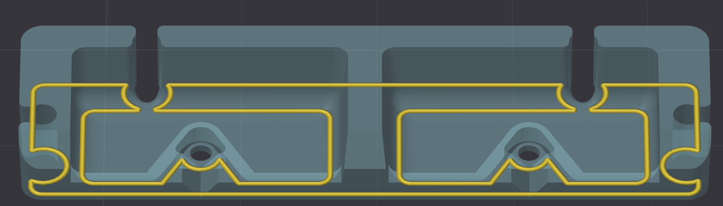

That’s our goal; this is what it should look like:

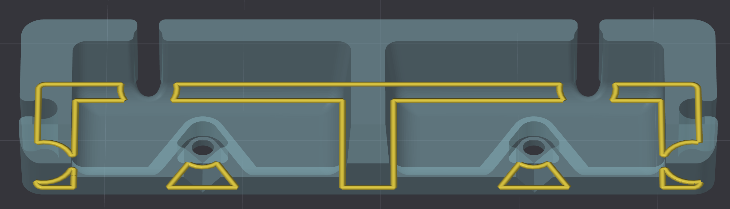

Then I enlarged the model to see what was going on, and that’s when I noticed the problem: Your inner wall isn’t straight - it’s rounded and slanted: It’s just not that obvious with the small model, but try enlarging it:
So that’s exactly what the slicer does - with this small model, it tries to recreate the curved walls as well, which was, of course, difficult, so it ends up looking more like a step in the inner walls.

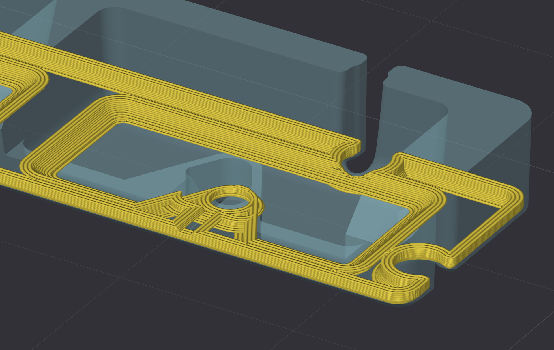

Solution: Design the interior walls straight in Fusion.
Alternative: Use a 0.2 nozzle and lower the layer height. Now, this isn’t a good idea when using TPU, but it might be worth trying if you ever want to print with a different material.
To sum it up: There’s no export error; the model is simply too detailed, or rather, the inner walls are too curved. Like I said: Enlarge the model a lot, and you’ll see what I mean:
The slicer simply can’t reproduce the extremely high level of detail created by the vertical curves - at least not with the small model.

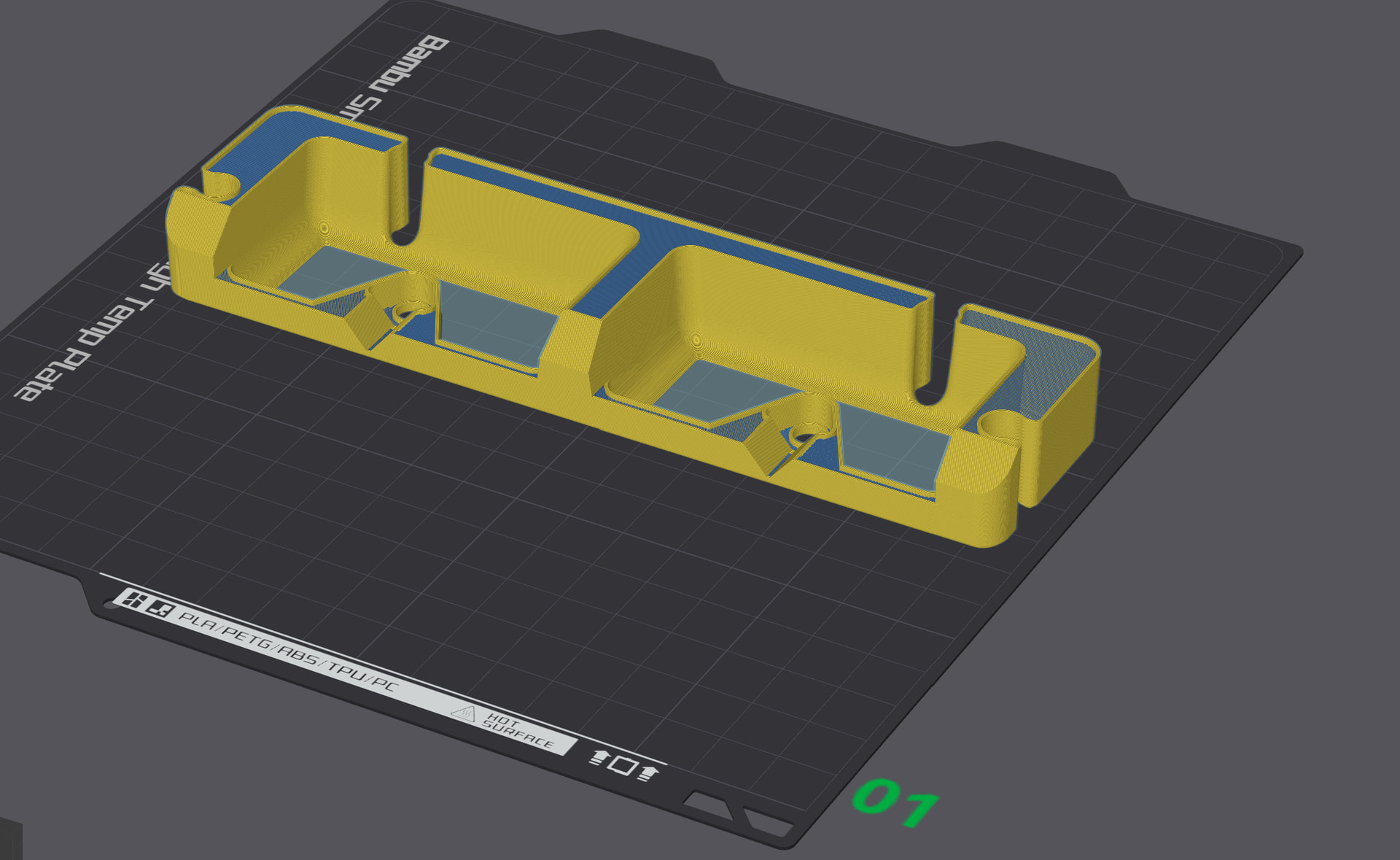

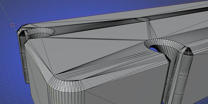

In addition to my detailed initial comments: I opened the file in Blender and zoomed in:
What you see in the image is the bottom side, so, upside down: Take a look at the rounded holes: The slicer simply can’t reproduce them that small - not with a 0.4 nozzle.
Those are exactly the places you mentioned in your post. Even with a 0.2 nozzle, it would be almost impossible to print that, or let’s just say very difficult, given how small you want it to be - total width only 5 cm of the print.
