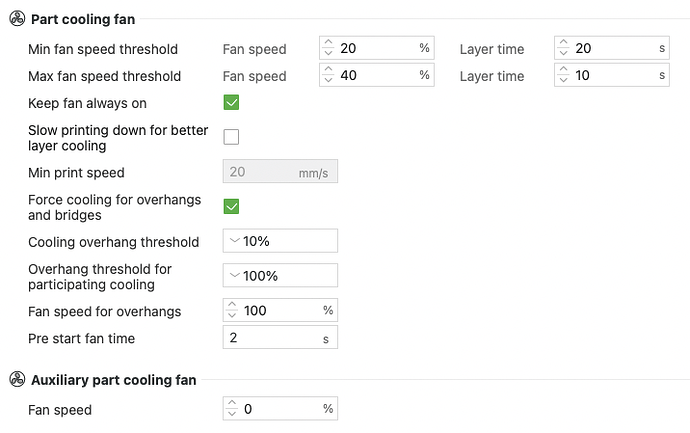

I’m newbie so I cannot create new topic. I finish demo bambu PLA reel and try to play with PET-G. I read and change some basic settings, detail look’s not so bad, but printing take much time. I see that at my "tower’ filamnet flow rate goes down much- from 16 to 0,2mm3/s. I’m not sure that is necessary and I wonder to know which settings define this speed.

O, finally, is ulocked. So, any idea which setting made my upper layer (almost all layer) with low flowrate?
Take a look at the “cooling” settings within the filament settings. If the layer time is short, the slicer will give the filament more time to cooling and reduce the speed.
Hmm, I set cooling for 100%, but ok… at right is layer time. Something happens when I set 3s instead 12. In your opinion, I can try to print it with layer time at 2…3s, or it’s unsenseles
Deselect “Slow printing down for better layer cooling”. At the end you had to play with these options to find the best settings for the model and filament.
You can also try to clone your model. Print 4 or more copies at the same time brings up the layer time and gives a higher speed. Sometimes the print quality of such small models is better if you print multiple parts at once.
