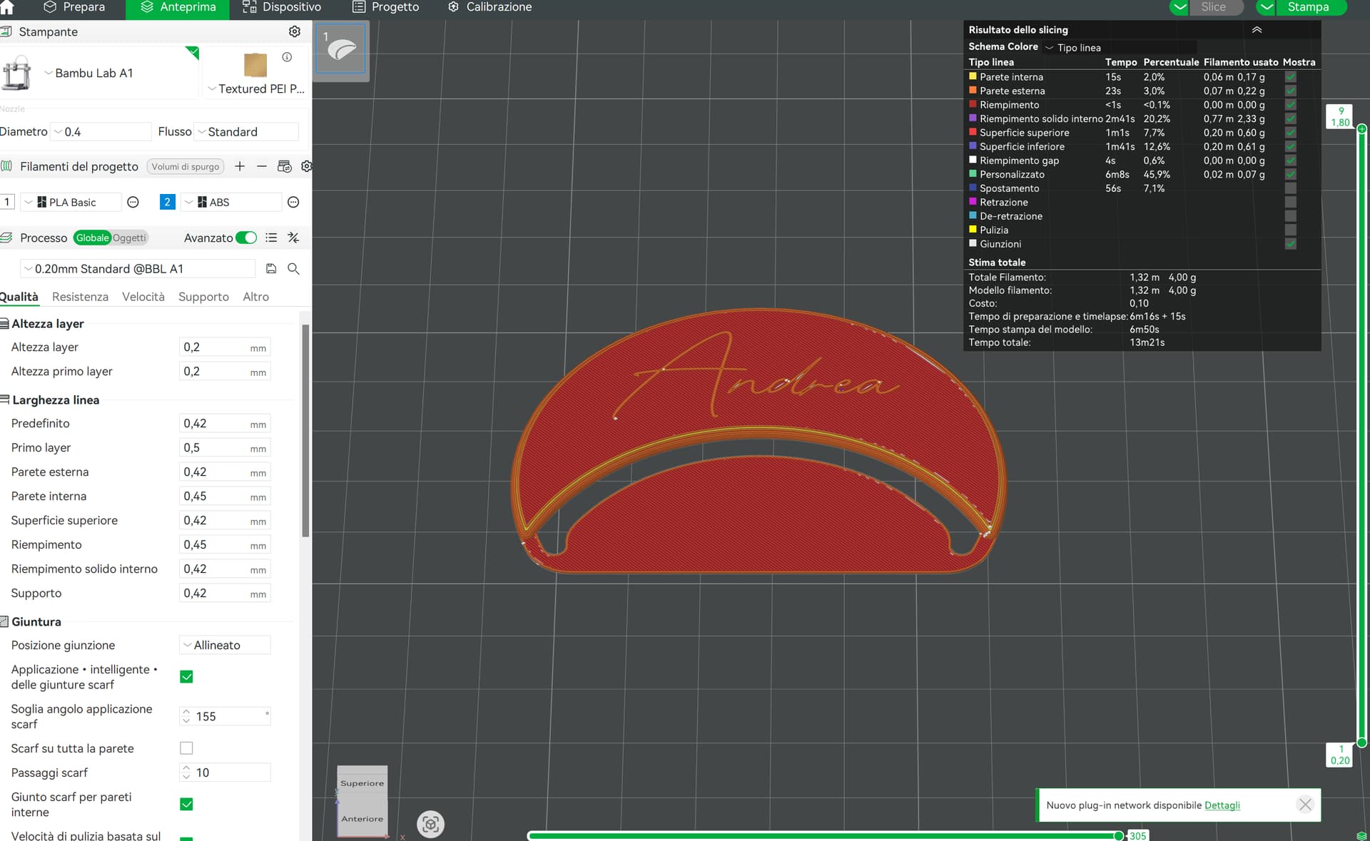

Hello everyone, I’m writing to you guys because strange things happened… When I sliced my item, a very simpe item, modeled with Fusion 360, i’ve noticed that in the middle layer, the path is similar to the top layer. I mean, this is 2 colours print, where only the top layer is white and every other layer is blue. My question is, it is normal?
I’ve noticed this thing, only when the font at the top is in italic, if the font is a classic sans, the path is ok.
I don’t know if this can “damage” my items, but i don’t know why this happened…

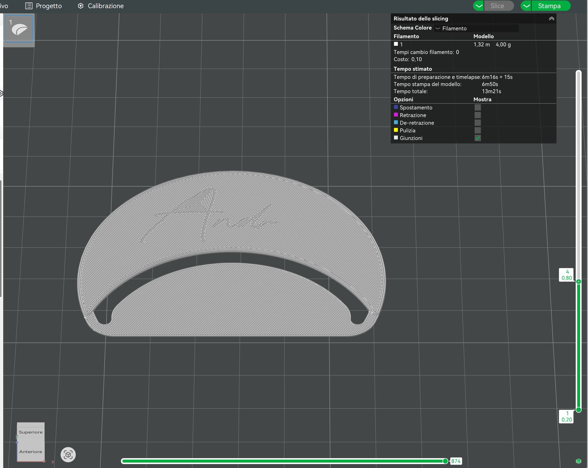

On the preview screen. Change the drop down menu in the top right from Line Type or Summary (cant read the language on your picture) and change it to filament. It will show you better what it should look like in the colors you chose. See how that looks
Sometime if you don’t make the engraved part deep enough in F360(or the same height as your layer lines) the slicer will do weird things
Thanks, sorry it’s in italian!
So, this is how it looks at level 4
So what do you suggest? I have 0,2mm layer height, and a total height of 1.5mm
Make the lines thicker, deeper, and use arachane wall generator
