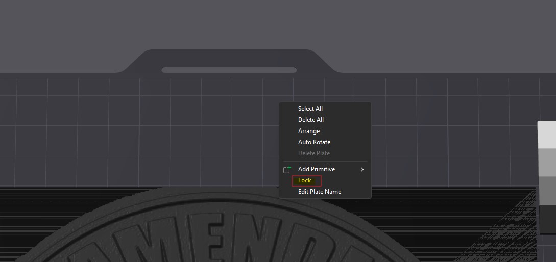

Have a P1P and learning the tricky stuff. I locked a plate to see how it would react to the other plates in the build. Now I cannot find how to unlock the plate?

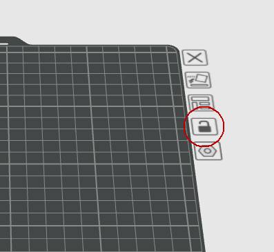

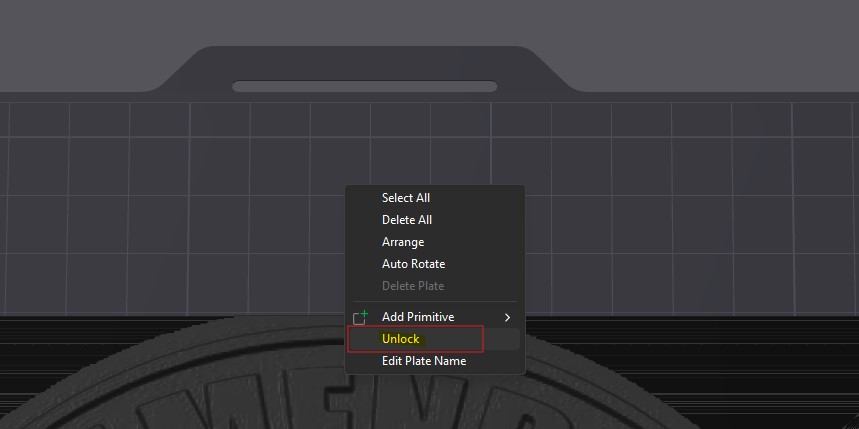

What do you mean lock a plate? Locked in Bambu Studio slicer? If this is the case, right click the lock, and select “unlock”.
Or click here:
