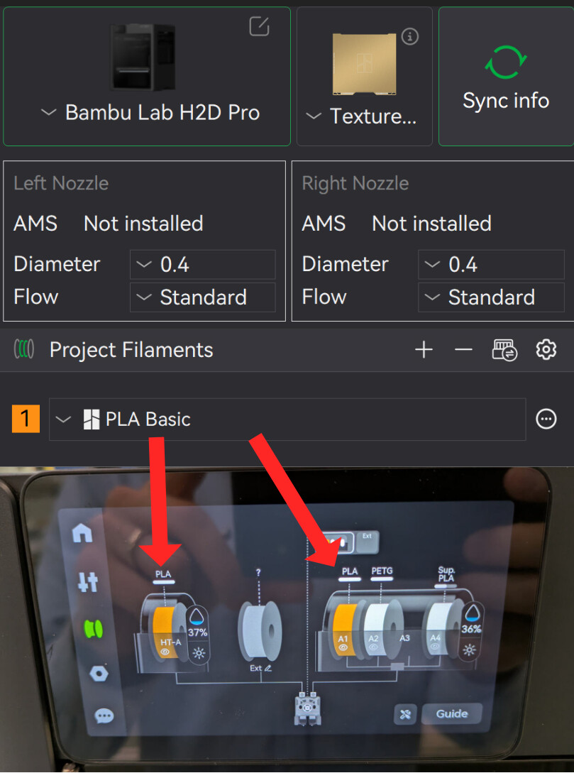

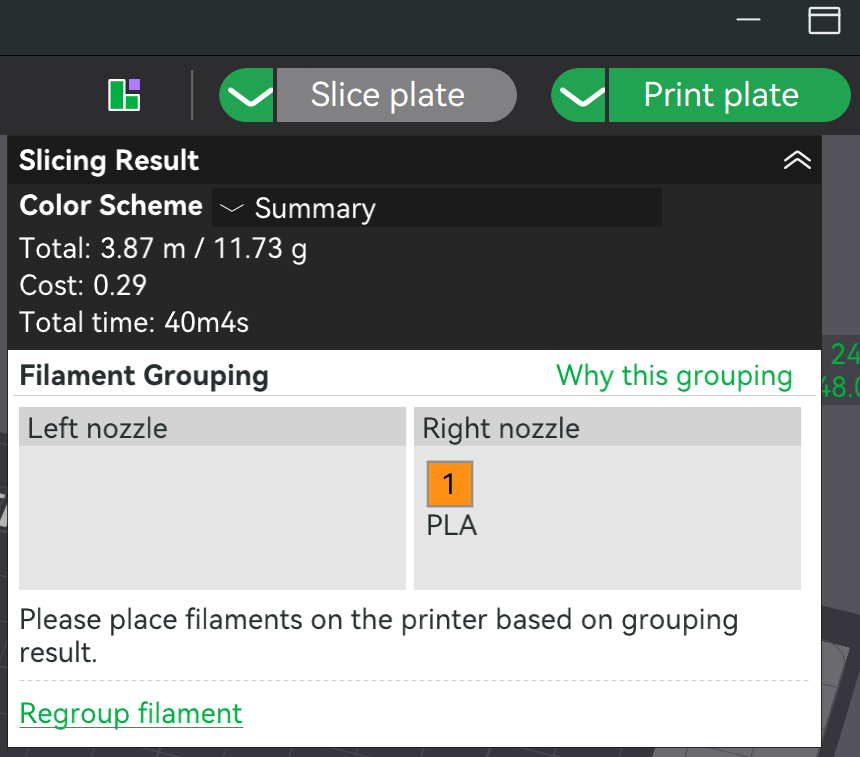

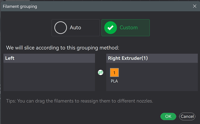

EDIT:When Im printing something from the internal stored models of the printer everything works. So I believe it has to do something with the BambuStudio settings. But what could it be? On the device I have 2 different nozzles installed (0.2 mm left and 0.4 mm right). Everything is well recognized by the printer. On BambuStudio one cant select two different nozzles in the settings. Therefore both nozzles are defined as 0.4mm, because I want to run the print job on the 0.4mm nozzle. During slicing I choose customs slicing and tell the slicer to print from the right nozzle. Other than that I have defined the filament same as it is in reality in the AMS 2 Pro. Also ich told BambuStudio that on the right nozzle there is one AMS with 4 slots and on the left nozzle there is one AMS with 1 slot. Did I miss something that forces the printer to change the filament?

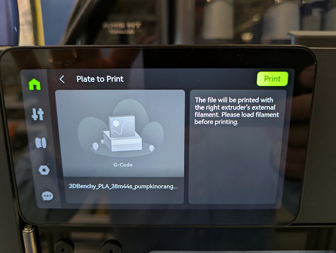

I have done so because before I wanted to start the print there is a information shown that I should load the filament before I would like to print. But I also tried to start the print without preloading the filament but still the same error message appears. I really dont understand it.

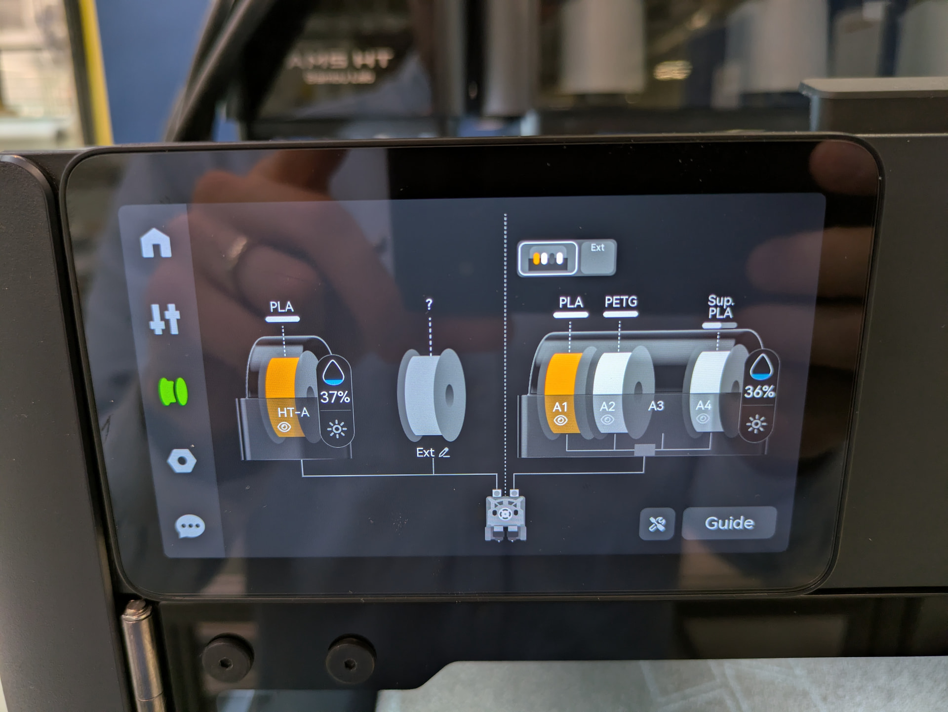

I do use an AMS 2 Pro. I then used the automatic recognition which worked perfectly well. The printer was showing me all the spools I had inside.

I think I’m starting to understand the problem: Something isn’t synced on your end.
Are you using “LAN-only mode,” or have you not connected your printer to the network at all?
Your AMS is completely different from the project:
  • Is this intentional - that both nozzles are assigned the same orange PLA - and is exactly the problem with the assignment?
  • Why haven’t the other filaments been listed? Even if you don’t need them right now, the project differs from the AMS.
When you created the project and sliced it, did you assign it to the correct nozzle?
Is it also displayed correctly in the summary in the upper right corner?
Sure, there could be other causes - I’m not ruling that out at this point - but what I see right now is a project that doesn’t align with the AMS.
