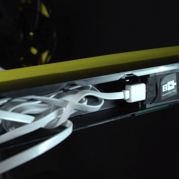

I was hoping someone could tell me if it is possible to toggle the power on and off to the USB port that is located at the top, from, inside, of the P1S?
I recently printed a riser for lighting and used this port, assuming it would toggle with the onboard system LED. It does not. Nor can I find any settings for it.

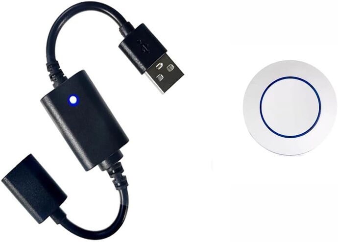

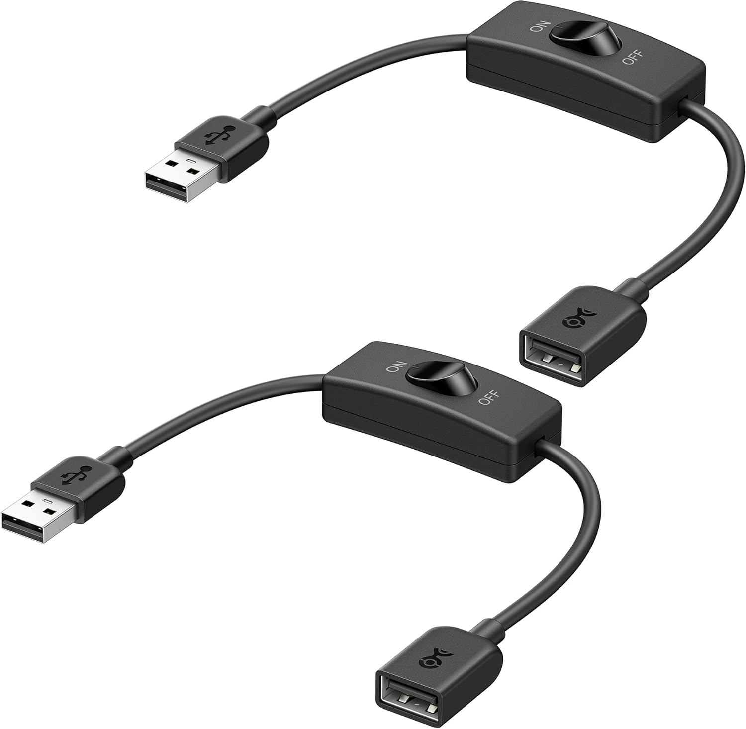

They also have USB on/off switches if you just want to avoid having to plug and unplug it.
and remote ones:
Yes, and thank you for the references.

Power from that port is rated 1.5A @ 5V. But normally, you should give at least 30% head room for electronics. Overdraw power from that port will end up in weird glitching AP board at best, or releasing the magic smoke at worst.
Just be aware that, chinese manufacturers do not care about your safety operating of your 3D printer. A year ago, I tested a led strip for x1c and the current draw was 1.7A @ 5V, such led strip was designed to be direct replacement for dimly built-in led lamp. Unfortunately, a few people suffered for this bad product.
My suggestion is to leave that port alone. Use a phone charger to power up your led strip instead.

Tapping power from that port comes with some risk. People have tapped that port and caused themselves heartache.
USB Port Troubleshooting Guide for P1 series
As mentioned in that article, the 6500k white led strip is fine. That’s what I’m using without problems, just straight up connected without relay yet.

I guess you cut it to length because I don’t think 5m of that led strip will stay below 1.5A. These are generally rated a little below 1A per meter, I wonder why bambu is selling it as being compatible without saying it is only when cut to the proper length to fit the printer (about 1.2 to 1.5m). There is a big risk someone will just plug it it as it is to test it and fry the board if left connected too long.
That’s a very good point.
I thought about doing that, but just assumed the best of Bambu and assumed the port would work and the lights would work. Though, I bought a 6 ft COB strip, only about 1.8m full length.
