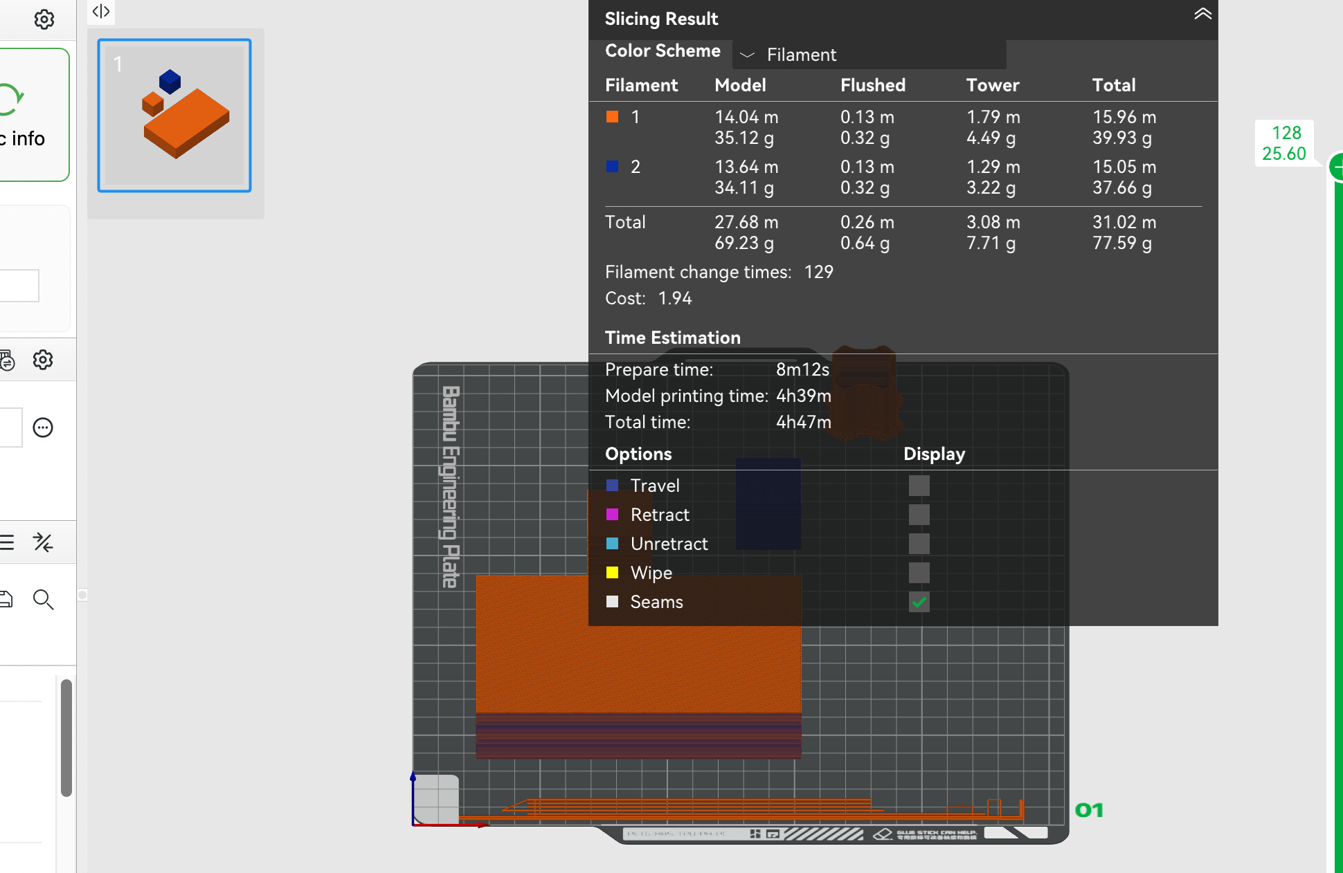

just tried a test
Without flush into - 29g of waste - flush ratio nearly 300%
with single flush into object - flush waste reduced from 29g to 24g
with huge flush into object - big enough to take pretty much all of the waste
Turning off prime tower - flush waste comes back again

Take a close look at Ukdavewood’s example. The slicer doesn’t really allow it and actually uses much more filament. I was surprised myself when I tested it. Without prim tower, filament consumption is higher. That should never be the case in this scenario, because it suddenly refuses “infill in object” - because the slicer somehow fails to fill the waste into a flush object nor use it to build presure.
Others are welcome to test it too, maybe Ukdavewood and I made a mistake. :+1:
