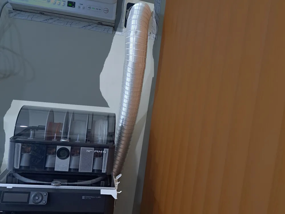

Hi both, new here and to printing. Setup my printer in my office, I don’t have a workshop and noW starting to worry about fumes, microplastics etc. I am a layman when it comes to this technology, but I can build something bespoke if needed. Is there a definitive answer to the sort of system that I can add to make this safe?
Oh, and I have a Bambu Lab P1S with no add ons, therefore currently only using basic spools.
@MattDoes3D
I showed my setup in the other thread you asked the same question:
How did you vent the exhaust out of the AMS 2 Pro? The nanoparticles are killing me! they fill my Entire studio overnight.
