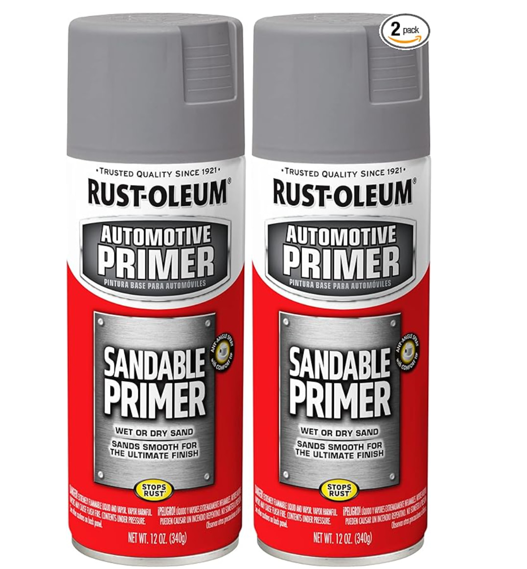

First apply a primer; otherwise, the paint won’t stick. Then apply the finishing protective coat.
Not acrylic paint - Use the stuff they also use to paint car parts. Here’s an example - you can actually buy it just about anywhere, and it comes in various forms. This isn’t meant to be a recommendation for the brand, just an example:
If you want to know exactly what I use: Nitro combination resin primer - so not acrylic paint, but a solvent-based primer. Contains solvents and cannot be diluted with water. The advantage of this is that it bonds perfectly with PLA, whereas acrylic falls short in this regard.
