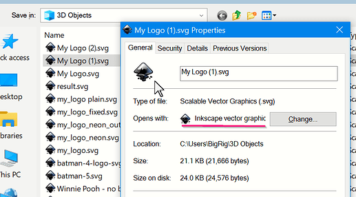

The other thing that is helpful to understand that in Windows File Explorer, “Right-click” and “open-with” is your friend. If you are simply clicking on a file, you’ll get Microsoft default and anyone who’s been around Windows long enough knows that the first thing you want to do with a new computer is purge Edge as the default for everything. So next time you right-click on a file name in Windows File Explorer, note the properties and a open-with options.
Open-with will give you a choice of apps on your machine that have registered with the OS as being able to open that file extension. Sometimes you’ll have to manually locate the file.
The real cherry is the properties menu. There you’ll be able to permanently open a file in anything else. I’ll use this example and change the default handler for SVG file to orca Slicer and watch the icons on my system all change to Orca(not a good idea for SVG files but just an example.
And this is when the magic happens. Once I change that default program, all the icons in Windows Explorer will change to the icon of that format and in this case, that is Inkscape.
You can always change it back if you don’t like it.

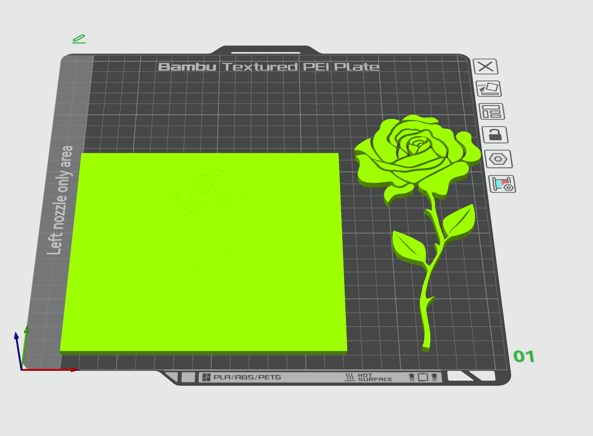

Turns out after throwing SVG and Bambu Studio at YouTube, that Bambu Studio can semi-natively use Studio to work on SVG’s.
This is a work in progress as I dig in to the process.
In the event you did or do not know of this, like me, here is a screen shot.
It appears to default to extruding the flat SVG to 10mm in the Z axis.

I tried to import SVG files into Bambu Studio, but they appear as a large flat rectangle. What am I doing wrong?
Your svg likely isnt in the right format, and is describing itself as a background fill as the background, instead of leaving a transparency.
Try for yourself with these examples that show this behavior:
