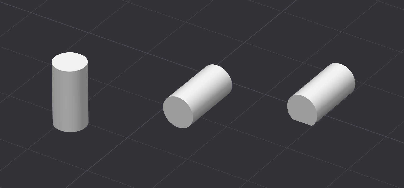

I suggest dowel pins be printed laying down for strength otherwise your model relies on the layer adhesion of a few very small parts for staying together. “Sink” them into the plate a little by performing a “cut” so they print clean.
BTW I would love for these two steps to be automated.
