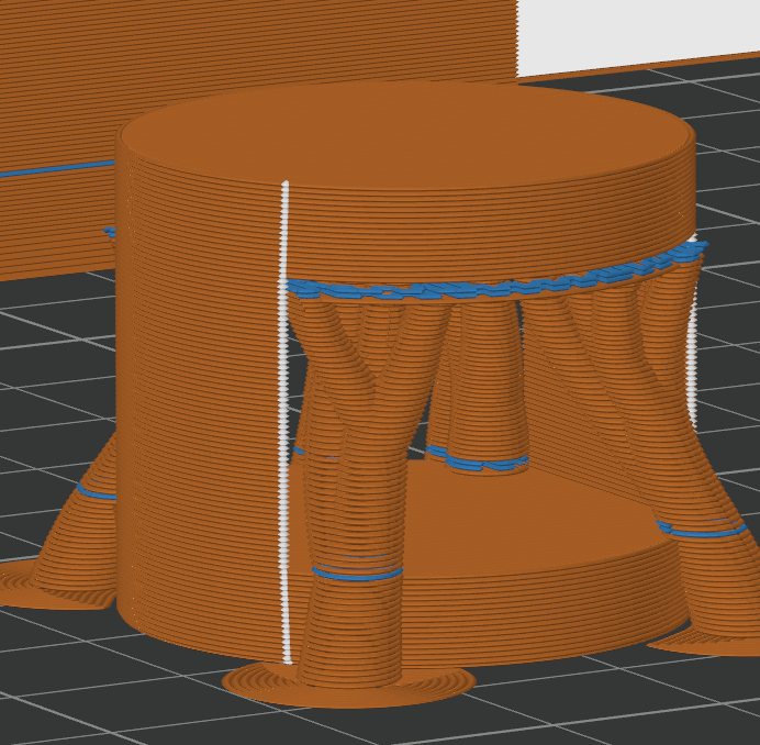

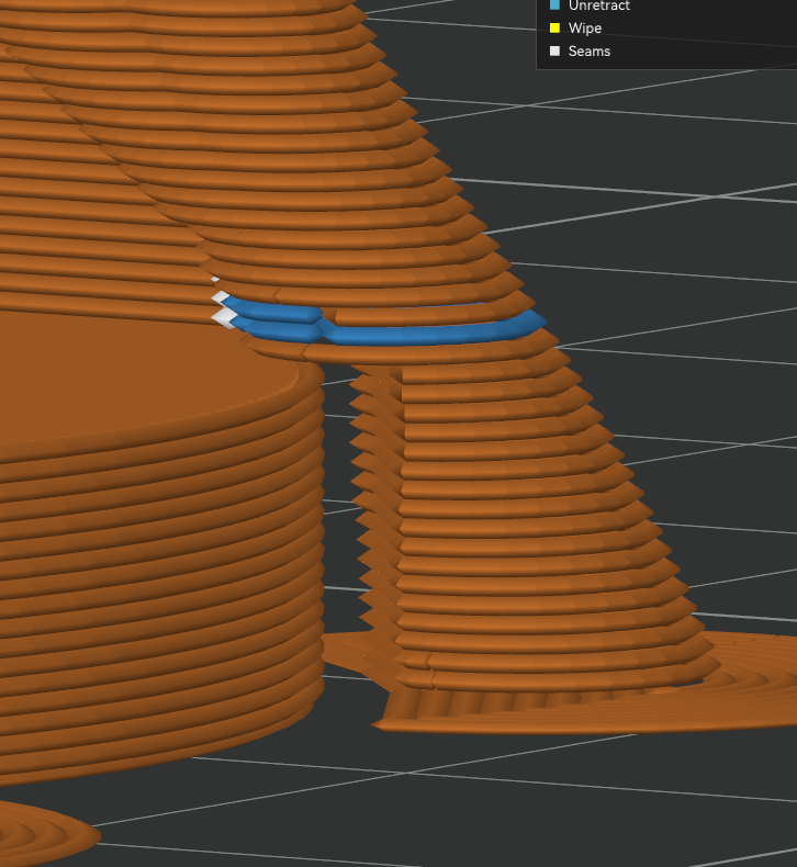

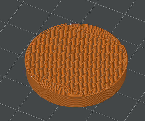

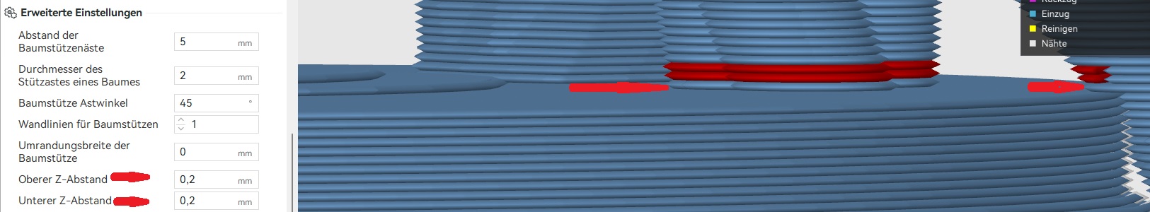

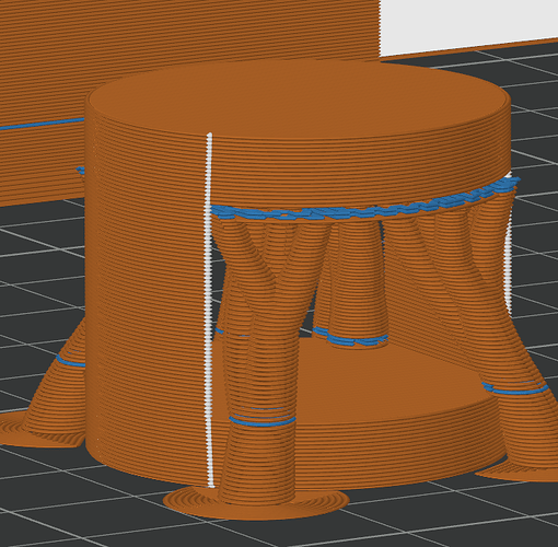

I was messing around with using PLA on a PETG print as the support interface since there is a large area to be supported and just using PETG as the full support makes that interface very difficult to remove. However, when I’m slicing the model, it’s putting an interface layer (blue) down low. Even more odd, there’s a layer of PETG right on the surface of the model and then two layers of the PLA (blue). The first image is a more extreme example. I did try printing the second image but it still has that odd layer of PETG on the surface below two layers of PLA. In the end, the subsequent layers of PETG on top of that PLA in the middle failed on several branches which caused a mess. Third image is just an exaggeration showing how it places a “shelf” on the model before the interface layer.
So, here are my questions:
How can I avoid those interface layers in the middle?
Why is it putting that “shelf” of PETG on the model before the interface layer (which essentially is worthless)?
Should I just go with normal supports here and just have the PLA as the interface on bottom and top? I was hoping to keep the amount of support minimized so using tree supports worked pretty well except for the interface layer.

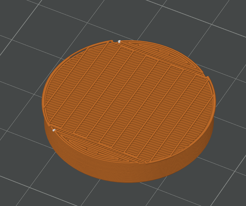

Edit: Added a 4th image showing the first support layer using Tree Hybrid. Shown in orange here for PETG and then the next two layers are PLA. Is this a bug or is this how it should work? I’d think the interface layers should be printed first on the surface.
Another Edit: If I just do normal(auto) it doesn’t appear to add that layer in the 4th image and just starts laying down the interface layer directly on the surface. So a bug with how the tree supports are done?

I suspect that for the interface layer that a different filament is used, the rest of the support structure end up using the same filament. That’s causing the support structure to break during printing.
Do you think this is a bug in the slicer?
I created an issue on github #2658. (I can’t paste the link since I am a new user. :-()

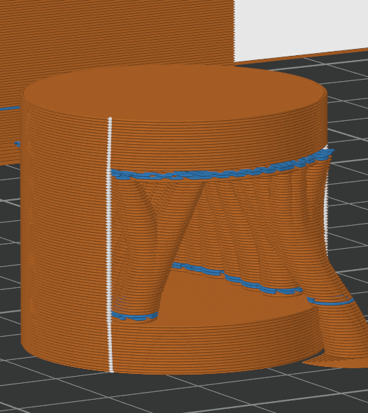

Yes, normal supports work shown in the 5th image.
Well, it appears to be two bugs. One is the interface filament being used in the support structure and it looks like JonRaymond has reported that. The second is how tree supports are using regular filament as a first layer below the interface filament shoe in the 4th image.

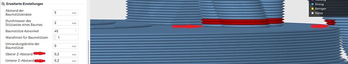

Das liegt einfach nur an den Einstellungen.

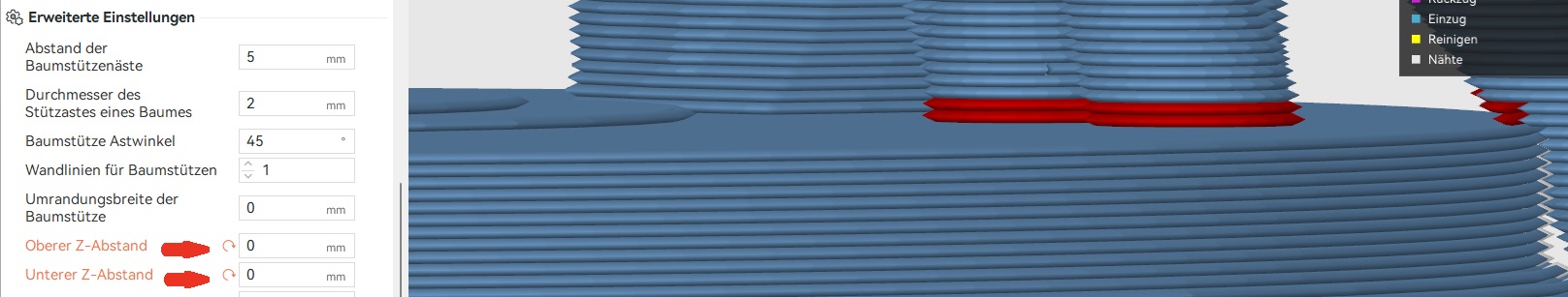

Dann setzen Sie unter “Erweiterten Einstellungen” den oberen und unteren Z-Abstand auf “0”!
:sunglasses:
Ah, it looks like having a layer height of 0.2mm and also an interface distance of 0.2mm causes the slicer to put down a model filament line to fill the gap?
That’s an interesting point. One thing I did fail to mention was this was sliced at .28 in my original images. I’ll have to check the settings that Kannekaffe shows as well.
