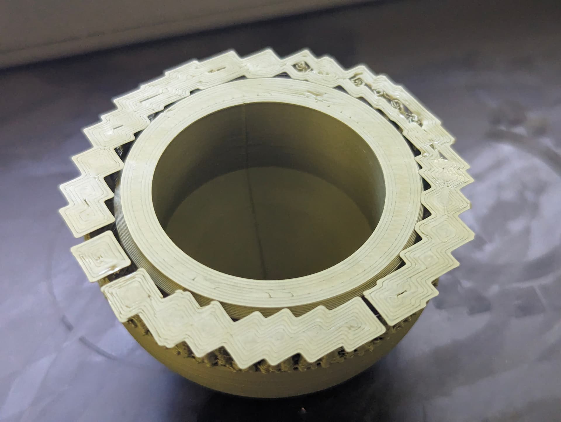

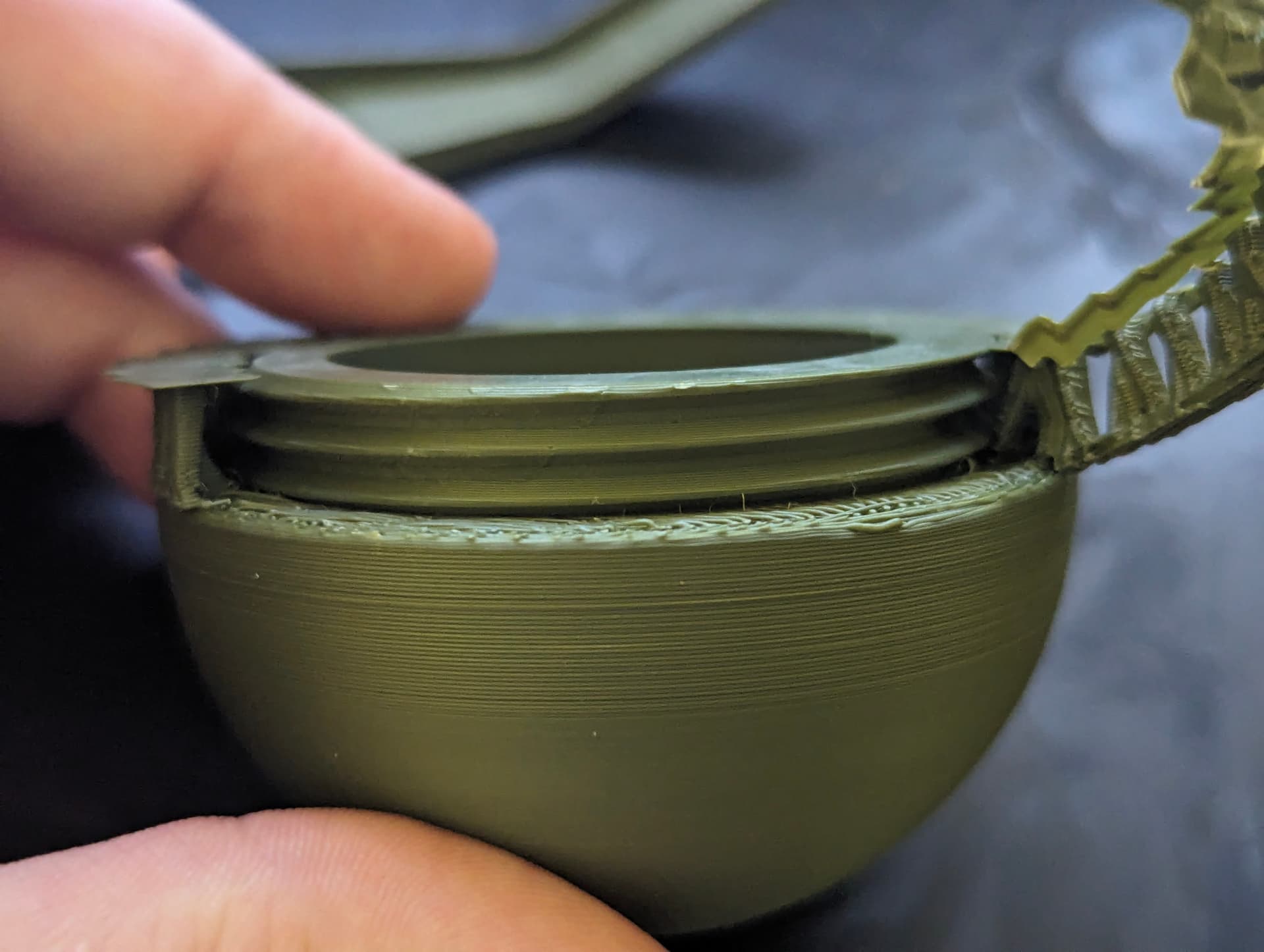

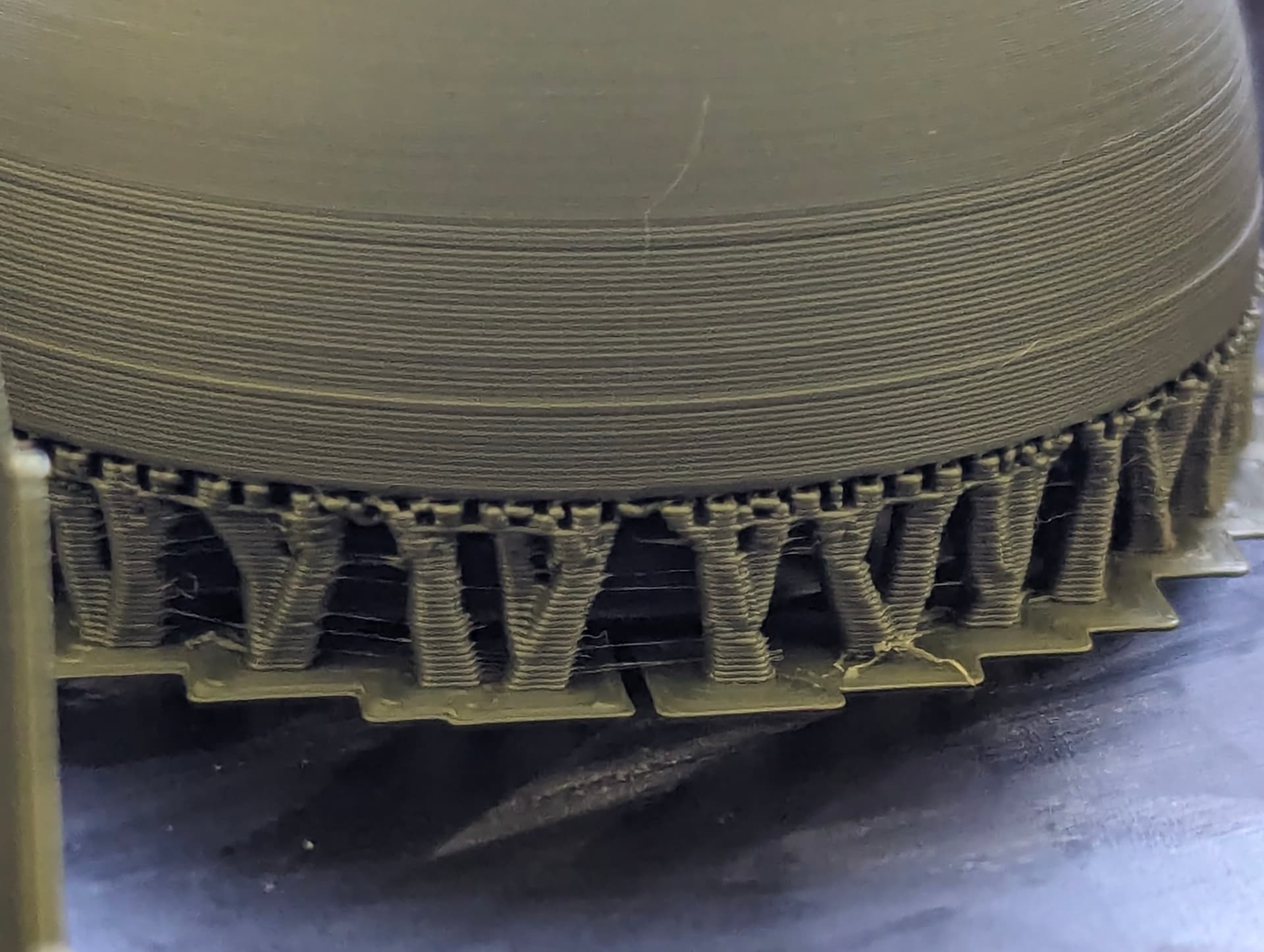

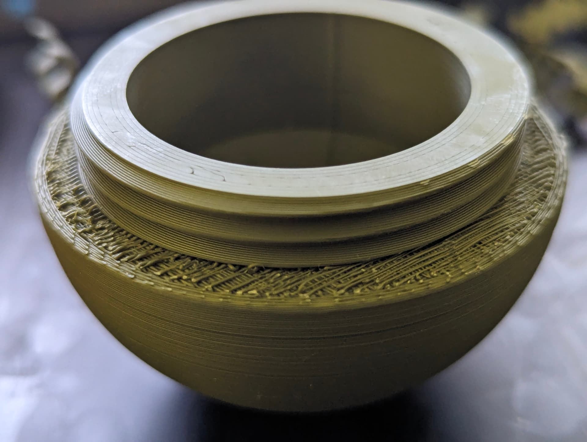

Does it technically ‘work’ ? …yes…
But, it does not look good. Take for example something I printed tonight - I used tree supports and it tore up the surface pretty bad… But… technically, it worked, but the part was still in one piece (minus the support waste).
I’m just a novice at printing, so maybe there’s a better way… but, these things don’t exactly come with a how-to manual.
(Just saw this in X1 Carbon directory - This is a P1S print, for clarification)

Another thing that I found out was that using a thin, metal object to separate the top and the bottom or rather the object from the supports also helps a ton! You just have to make sure that it’s thin but not too sharp as it’s easy to injure yourself. Breaking off the supports using pliers without this prior step doesn’t work well.
