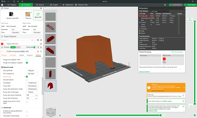

Hello,

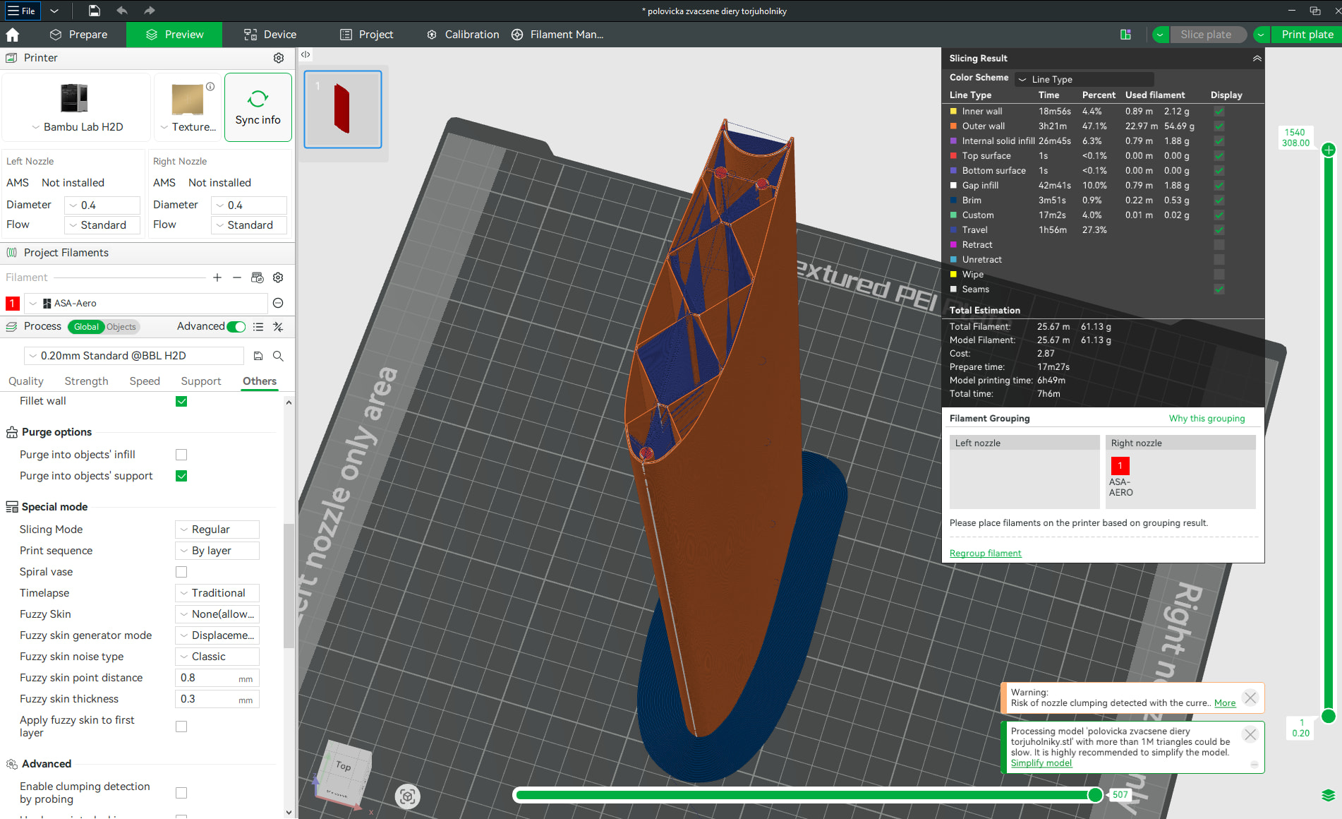

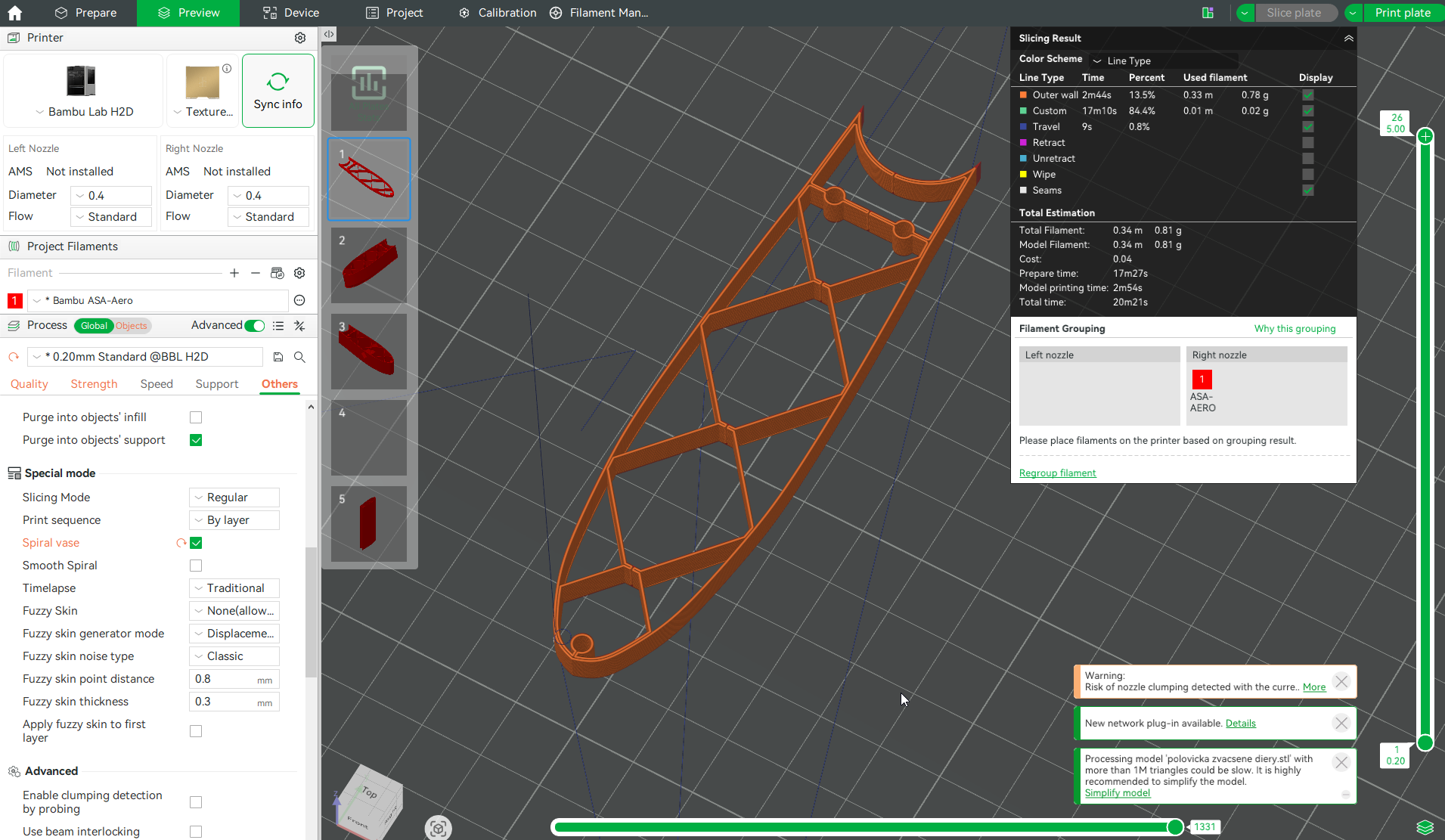

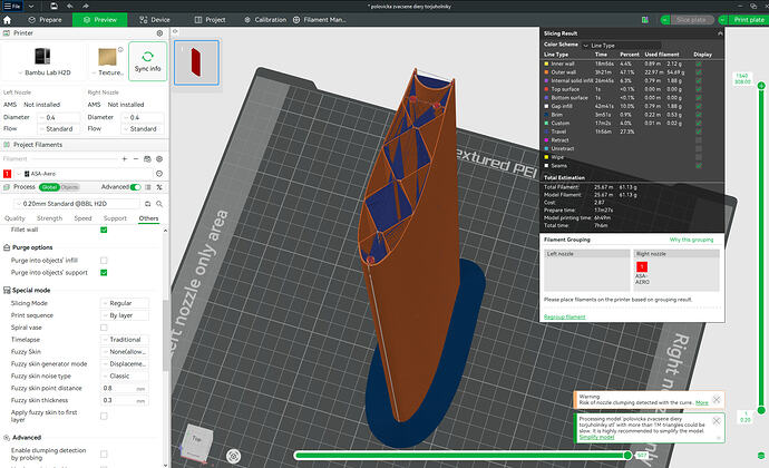

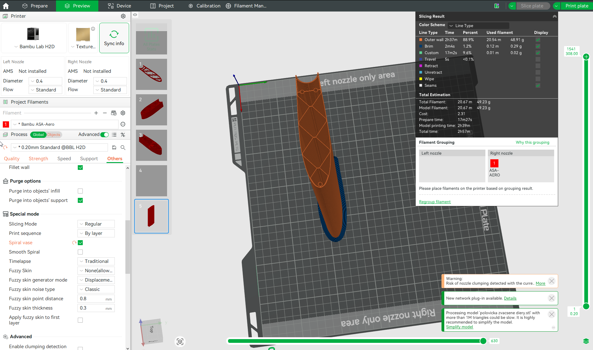

I am testing the use of Spiral Vase mode in Bambu Studio to produce thin-walled parts for RC aircraft models (elevators, wings, and fuselage). When printing an elevator profile with a height of 308 mm, I achieved fantastic results:
  • Print time: 2 h 39 min (compared to 6 h 49 min with standard slicing).
  • Quality: A significantly smoother surface with no visible Z-seam.
CAD Workflow Used
To get Bambu Studio to recognize the model as suitable for vase mode, I used the following workflow:

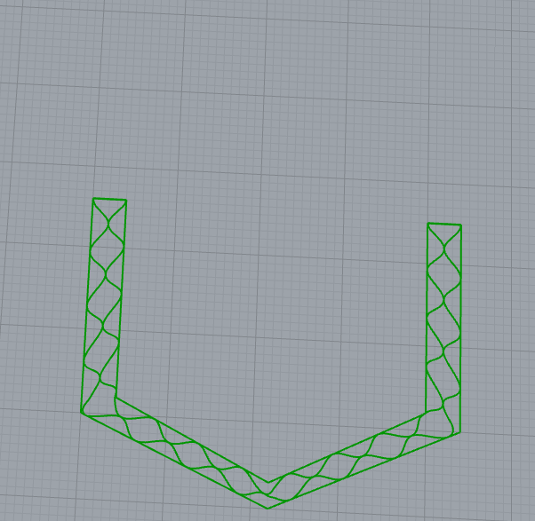

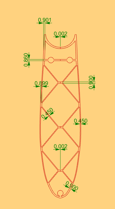

  1. I drew a profile with double the perimeter width.
  2. I split the interior of the model longitudinally and introduced a 0.002 mm gap.
  3. This gap runs through almost the entire inside of the profile (except for the leading edge/nose tip), creating a single continuous path for the slicer.
Reason for My Query and Future Plans
I plan to use this method for a complete aircraft build—specifically for complex geometries like tapered wings with variable chord and thickness as well as fuselage sections.
Since preparing and parametrizing these models in CAD will take several dozen hours of work, I need to gather as much information beforehand as possible and understand the slicer’s limits to avoid unnecessary errors and rework.
Questions Regarding Limits and Parametrization
  • By what exact criteria does Bambu Studio evaluate whether a model is suitable for Vase Mode?
  • What are the boundary CAD parameters (e.g., minimum/maximum internal gap width, maximum overhang angle, curvature radii) for the slicer to accept the model smoothly?
  • Are there specific geometric shapes in variable wing profiles or curved fuselages that cause the slicer to break the continuous spiral or fail?
I have attached sample files and screenshots for better illustration.
I would be extremely grateful for any advice, documentation, or recommendations on how to properly design these models in CAD.
Thank you!
Bambulab H2D
Bambulab Studio 2.8.2.61
P.S.: Upload stl is not allowed :man_shrugging:
None - it will always offer you vase mode, no matter how sensible or how absurd the model might be. That’s why you really need to keep a close eye on the slicing preview. It may not throw an error, but it will introduce many problems in the printed object.
Using vase mode for something other than its intended purpose is absolutely fair game - especially for this particular application - but you’re definitely pushing the slicer right up to its limits.
Some people here in the forum have had incredible success, while others have become frustrated by it. I’d try entering “wing” or “wings” in the forum search - you’ll find quite a few results.

Ahoj,
fortunately I have done it. Now is comming time to tunning in BS.
There’s a setting for seams to be placed to the rear of a model. If you turn the print to put the trailing edge to the rear, that will hide the seam along the trailing edge. Where you have essentially two trailing edges - like where the ailerons or flaps interface to the wing - you might turn the wing a little more or less where one trailing edge is closer to the back than the other and the seam should be placed just along one of them with the lower edge probably being the one you want at the back.
