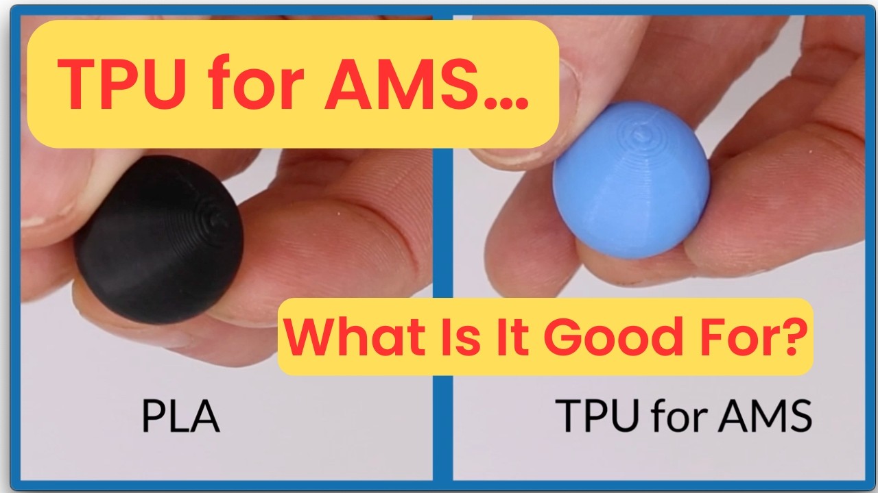

TPU for AMS is not soft. But it does bounce. Here is a good video comparing TPU for AMS against regular TPU and PLA. Spoiler: TPU for AMS is probably closer to PLA than regular TPU.

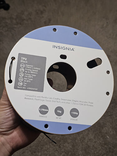

Hi Max ThreeD, well certainly I’ve tried it. It is Best Buy’s house brand, Insignia. The only TPU they had. $19.99 a spool. 95A shore hardness. I didn’t fiddle with any of the slicer settings. So I recon whatever the model builder put it, or the printer put in was what it was. I wouldn’t have a clue anyway. I’ve barely got brims down. :laughing: (Love brims, BTW)

I am more blown away that nowhere on the box or the spool says what shore hardness it is.
This is a white label for the polymaker tpu 95. It is not HF.
Its actually not that bad. Bestbuy had it on sale for 9.99 about 6 weeks ago, so I went ahead and bought 3.
I like how they used the same spool but printed in a different orientation… :laughing:
Oddly the PolyFlex 95A product page lists 20-40 mm/s print speed while this one claims “up to 100”. The PolyFlex 95A HF says “40mm/s - 100mm/s.” The print temperature range matches PF 95A recommendation, while the bed temperature range matches the HF variant. And HF comes in 1kg rolls while regular only in 750g. Maybe it’s a new mix? :smiley:
And 3mm retract length? Their own P2S filament profile I just downloaded has it at 0.4mm, like other generic TPU.

Thanks a lot for that video, Clogged Jet. That is a great example. And a really good comparison I think others could relate to. Like every other hobby I’ve gotten into, just throw money at it. :laughing: An AMS HT now. :rofl: I do have other options, two heated AMS2 Pro’s I’m presently drying my TPU in one of. So maybe in a week or so I can run it. Building alternative spool holder as we speak. Not that I mind, oh, far from it. This 3D printing is a lot of fun to me. Kind of mind boggling, but not so much I fumble the ball a lot. Trying to ease into the nuances of the filaments. (And not have a ball that took 3 days to print broken immediately.)
