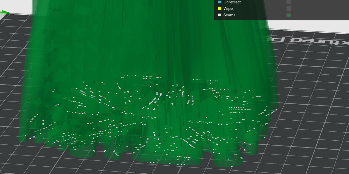

I’ve printed some great objects in vase mode before but I always get several seams on the first 2 or 3 layers so the first layer is not part of the continuous spiral.
The spiral starts eventually, but because the first layer is lots of separate extrusions instead of one continuous spiral, it can lead to poor adhesion and then spaghetti.
Am I missing something? is there a setting I need to change to get the first layers to be part of the continuous spiral?
You can see in this image that there is lots of seams on the first layer…
Ah… Arachne slicing mode fixes this!
In case anyone else has the same issue!
