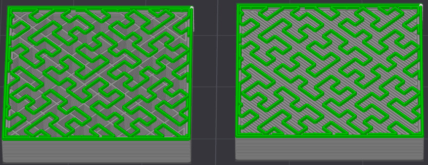

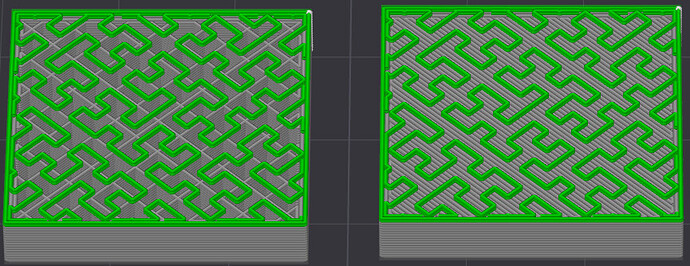

In the picture, the object on the right is the way I want it to look. Nice smooth bottom object with infill design printed on top. The object on the left is what it now does because it ignores the ‘top shell layers’ parameter.
I have also tried splitting the object into 2 pieces and leaving them merged. I get the same results.

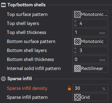

Bottom object ‘Strengh’ tab:

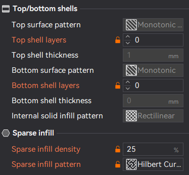

Top object ‘Strength’ tab:
