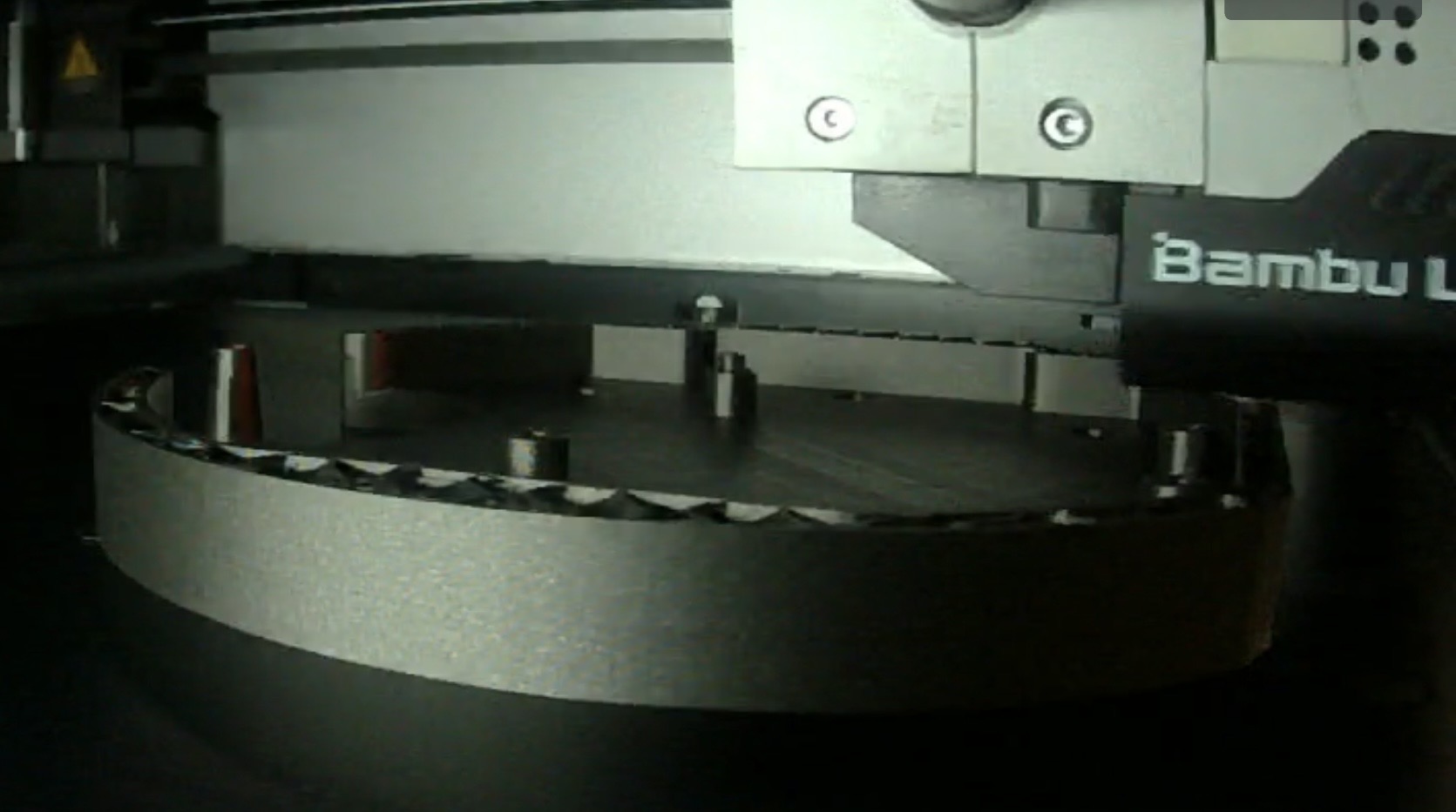

Hi guys I have an X2D that’s done about 500hrs and I’m trying to print a dual colour model that I’ve done many times before with no issues, in fact it always comes out perfectly. But now I’m getting some really bad stringing from the right auxiliary nozzle, and it also leaves a mess on the model itself. As a test I even swapped the filament over to see if it was the filament that was an issue but it made no difference. Not sure if this is anything to do with it but I usually use Bambu PLA Metal in the RH nozzle?

So you still got stringing after swapping the filament which eliminates the nozzle choice as culprit but maybe focuses more on the filament itself? Have you tried a test with a different spool of filament?
Besides the stringing, that print is showing other issues. The filament looks like it’s cutting across the inside of that circular part so and there’s other weirdness in there too.
How are you drying? And how do you know your filament is dry?

My apologies I may have been unclear. I had the Metal Pla in the RH nozzle and was getting the stringing from the Metal PLA after drying the filament which I always do with metal and the black PLA was in the AMS so I swopped them over so the black was in the RH nozzle and got exactly the same problem so it must be the RH that’s the issue. I’m beginning to wander if there’s a buildup of metal particles in the bowden extruder gears?
Ah. Well, hope you get it sorted but there are some issues with that print that can be caused by water.

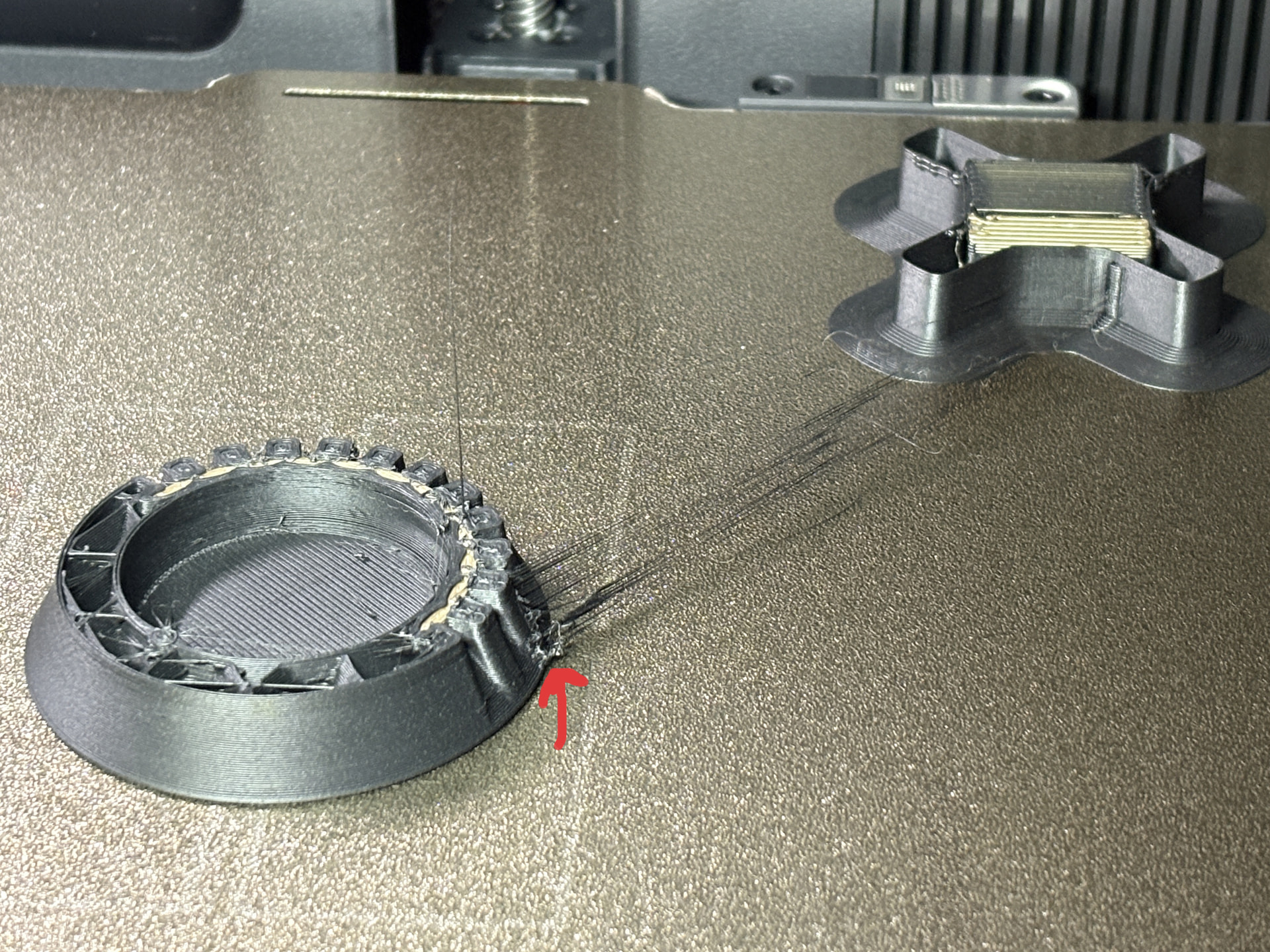

I’m having a similar stringing issue on my X2D, as shown in the attached photos. The brown half of the box was printed with the auxiliary nozzle, and that’s where the stringing occurs. The middle section was printed with the primary nozzle and has no stringing.
Has anyone found a cause or a fix for this?
That’s exaclty how mine was. So far I’ve cleaned the Auxiliary Extruder, not that it seemed to need it as it looked really clean as you would expect for a printer that hasn’t been used much. I also thought I may as well give the rods etc a clean and lubricate everything, again it wasn’t long since i’d done it, then recalibrated the machine and for now it seems to have worked but couldn’t say exaclty what has helped, for now at least…

Wouldn’t this be a retraction issue? So bowden extruder issue?
Mine is not so bad but close, white was on the main and brown matte on the AUX.
