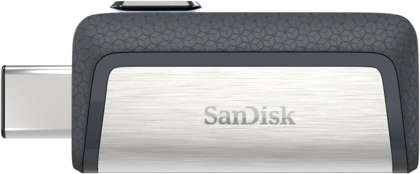

My USB Specs are:
Memory Storage Capacity 64 GB
Hardware Interface USB Type-C and USB Type-A connectors; USB 3.1 (Gen 1)
Additional Features Retractable Connector;Encrypted
Write Speed 150 MB/s
Read Speed 150 Megabytes Per Second
Connectivity Technology USB
Flash Memory Type USB
Compatible Phone Models Google Play
Can it just be it is full and cannot record more videos? 64 GB will only hold about 15h of 1080p videos. How do you access your videos?
Interesting that USB stick has both usb and usbc.
Bambu Studio. I formatted it so it was empty.
I’ve had some SanDisk drives with two partitions before. This USB stick might have an interface board, especially since it includes both USB-A and USB-C. Do you have a plain USB-A stick you can test it with?
It also includes an encryption option, so you might see two partitions on your PC.
