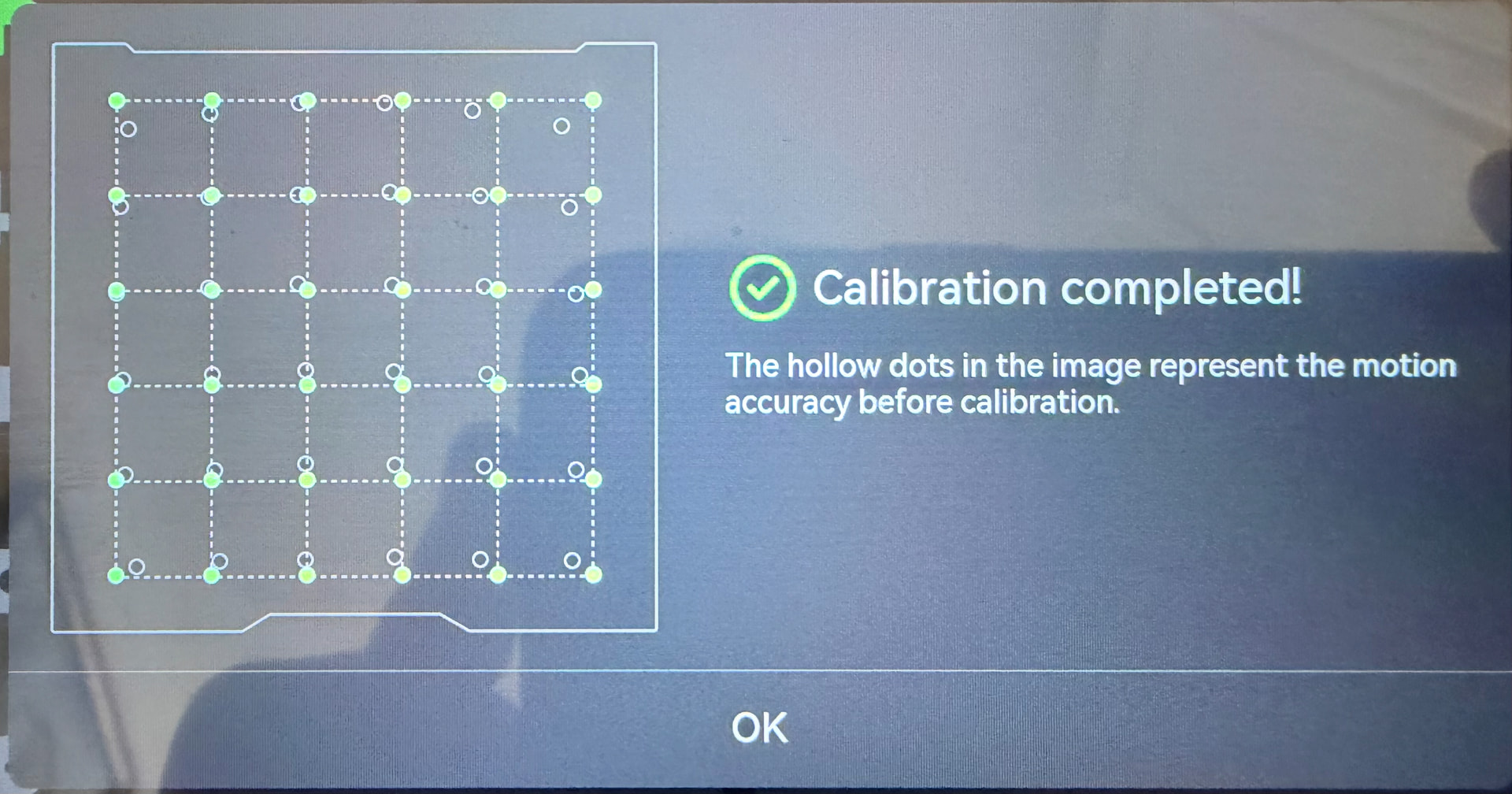

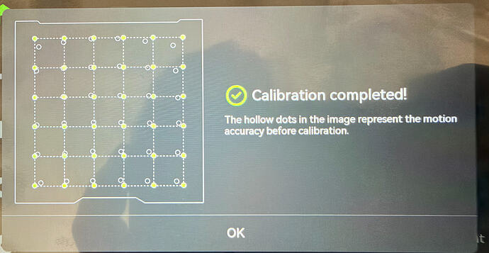

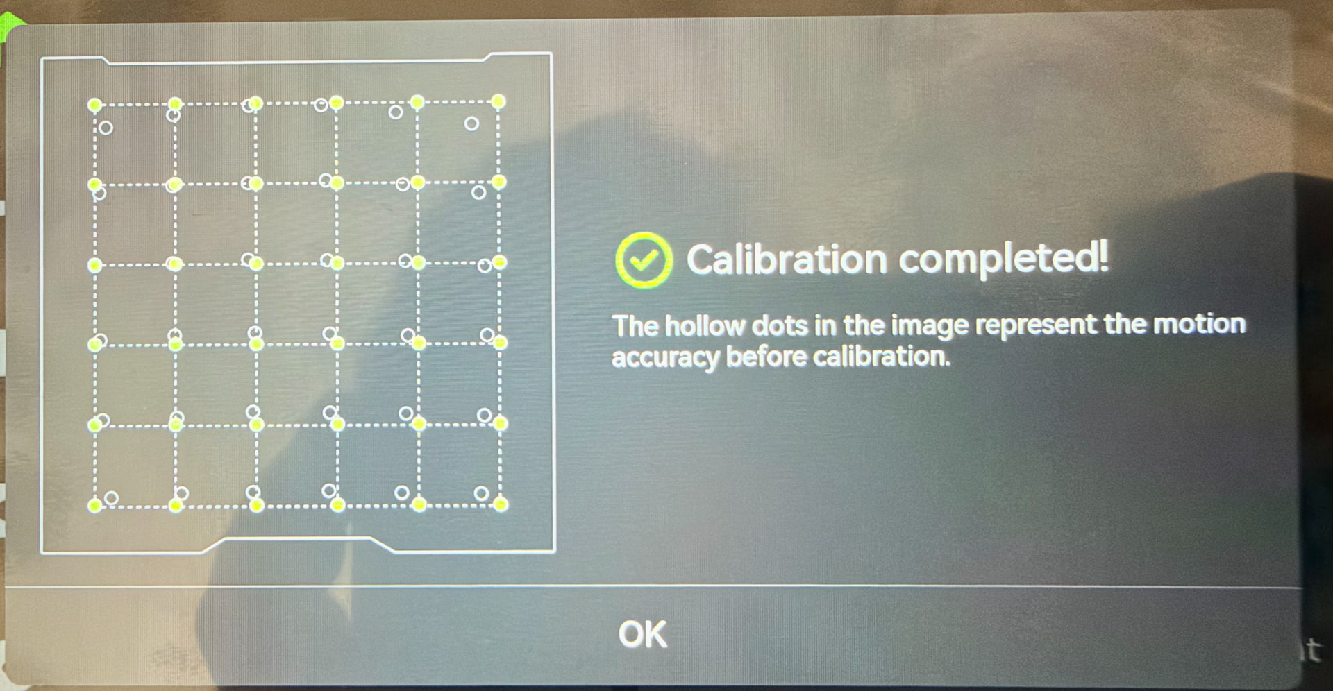

I just bought Vision Encoder for my H2C printer and run calibration 3 times one after the other and same errors on all calibrations has been discovered by device.
So I consider; any of calibration does nothing and keeps same error if there is really.
But it clearly described on wiki;
After each calibration, the system compares the results against the uncalibrated initial state, rather than against the previous calibration state. Therefore, if the overall operating status of the printer does not change significantly, the results from each calibration will remain basically consistent.
So the displayed data a bit open for misunderstood. It is good to share to be understood for everyone.
This result shows how the printer corrected the geometry compared to the factory state. So when you get the same result every time, it means that calibration consistently detected the same deviations and corrected them. I would be worried if it found different deviations each time.
