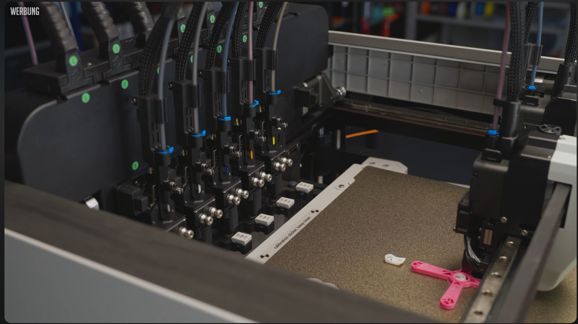

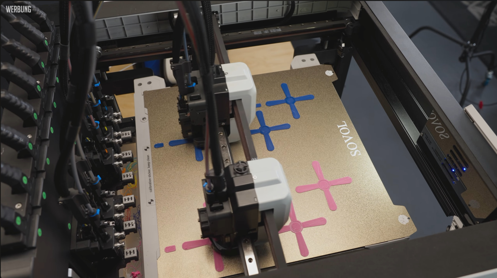

Returning to the main topic, the first review videos for the Sovol M1D IDEX & Toolchanger were released, tying back into this topic.
Two heads and 7 nozzles. Whether it’s necessary is another question, but it’s an interesting development - companies are certainly trying to put their own spin on it.
Edit: One of the advantages - I didn’t realize this at first - is that if someone only use two types of filament, the switch takes just 5 seconds (including prime the tower) - inlusvie zero wait (except for the prime tower)

I’m psyched that the sovol looks like its actually gonna launch, and not in too horrible of a beta buggy state. The second full toolhead on the rails is an extra 100 layers of complexity, far above a second nozzle riding on the toolhead. Im still not sold on it being necessary or even beneficial. But hard to argue with a thing that works.

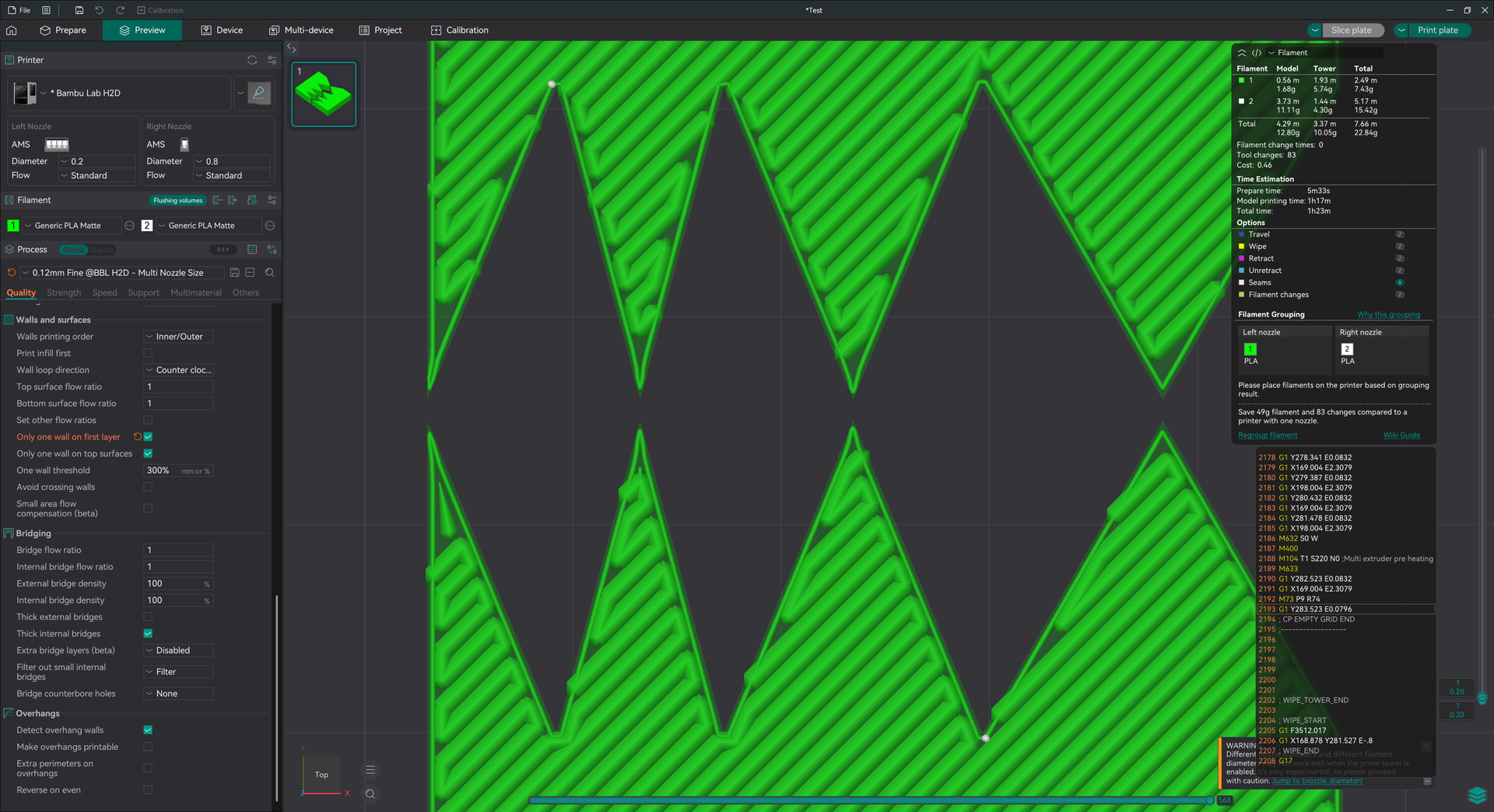

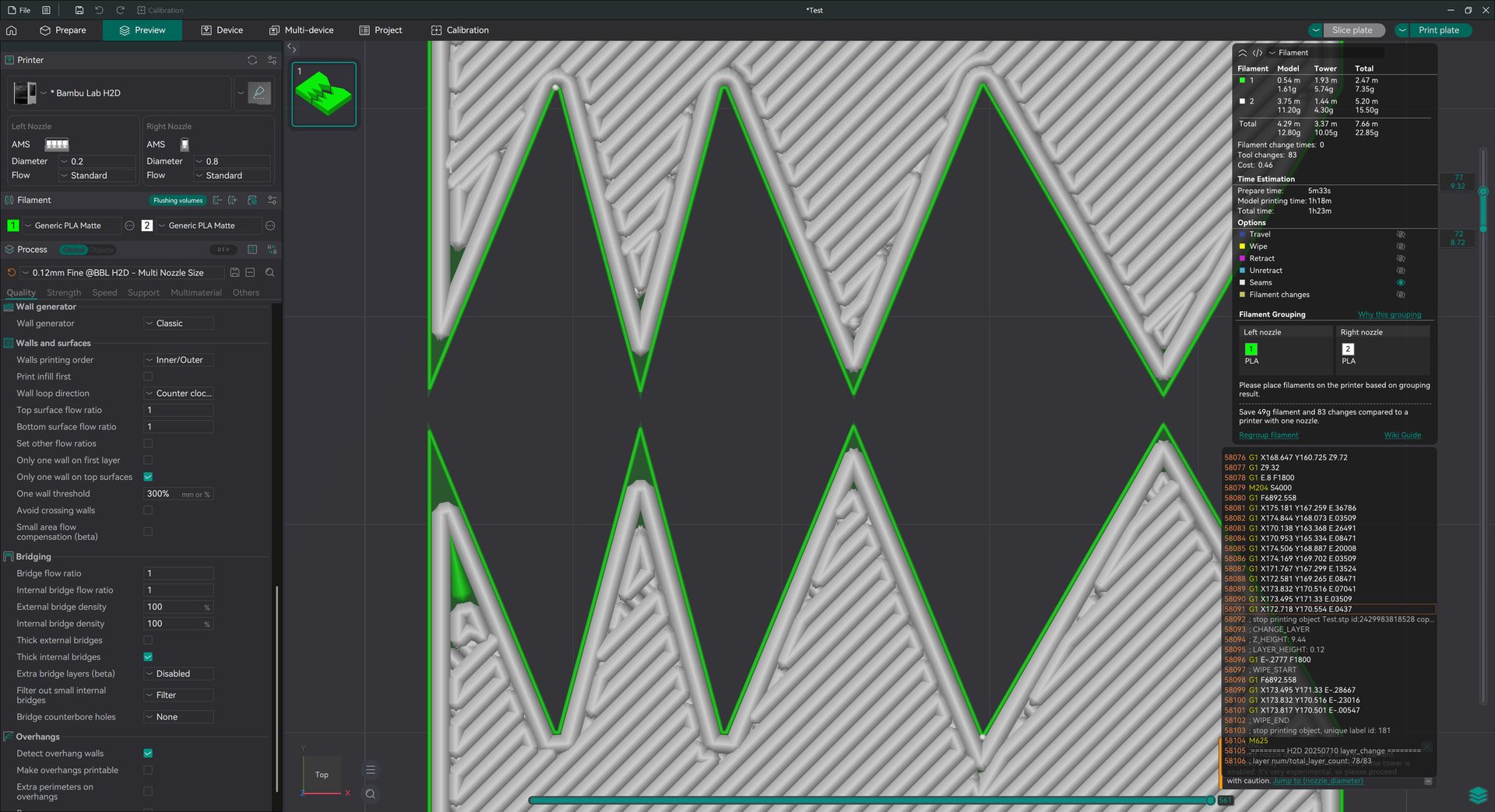

Consider the extreme use case where you decide to print the outer wall with 0.2mm and the rest of the walls with 0.8mm.
And you have a 45 degree sharp angle in a wall.
Imagine how to combine those paths and keep them properly adjacent to each other.
The slicers have already some algorithms to handle that for equal nozzles, but imagine the solution required when the diameters are different.
1st and last layer should look like this (Arachne on top part, and Classic bottom part) when having one wall:
But the slicer decides this for the bottom layer:
Other layers would look like this:
And this is just one example.
