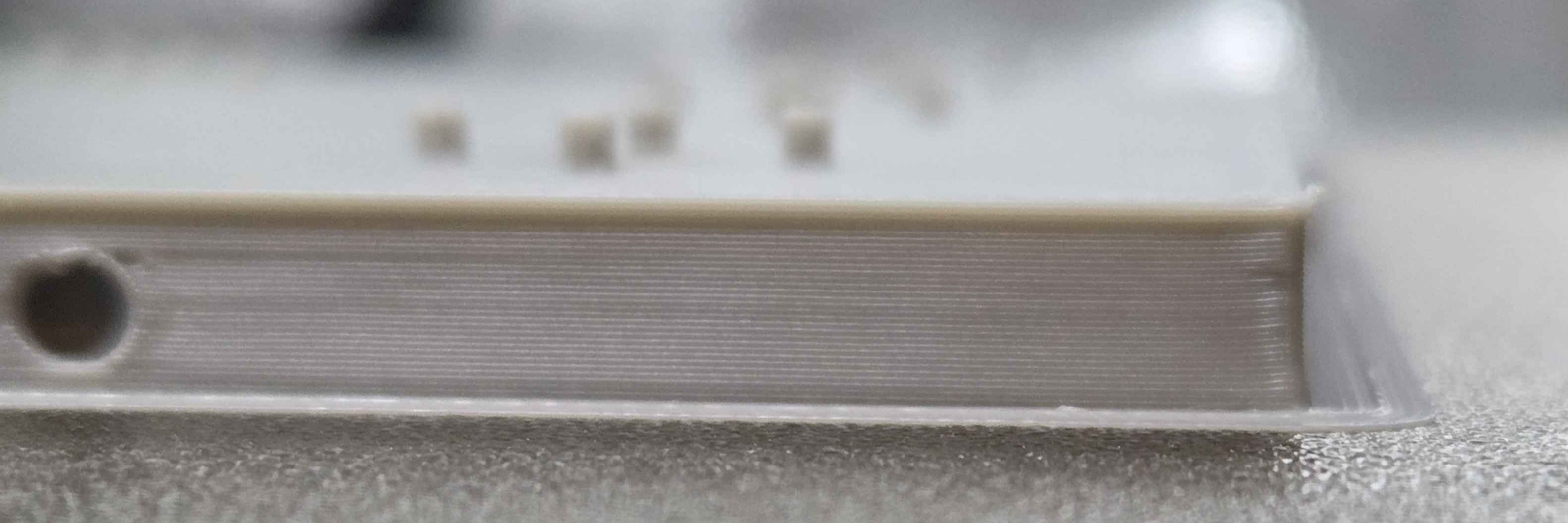

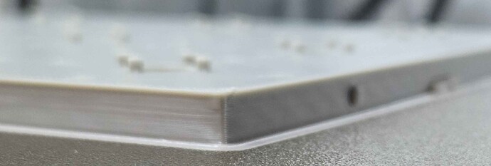

Warping and a weird lip around top of my print
Hello again Eno. It has been a hot minute, and I finally got some regular PLA and the time to try printing this again. Here are my results:
So for some reason that stupid lip still appears on on the top. But the warping is completely gone! I will call this a win. I can run a deburr tool across the top and its perfect. I will likely attempt some more infill setting changes but other than that it is good enough to do the job I need it to, so I am calling this one finished. Thank you again for the thoughts, ideas, testing, and patience!
Have you enabled Ironing in the slicer?
Image is not very good, but it feels like an overflow of the Ironing.
