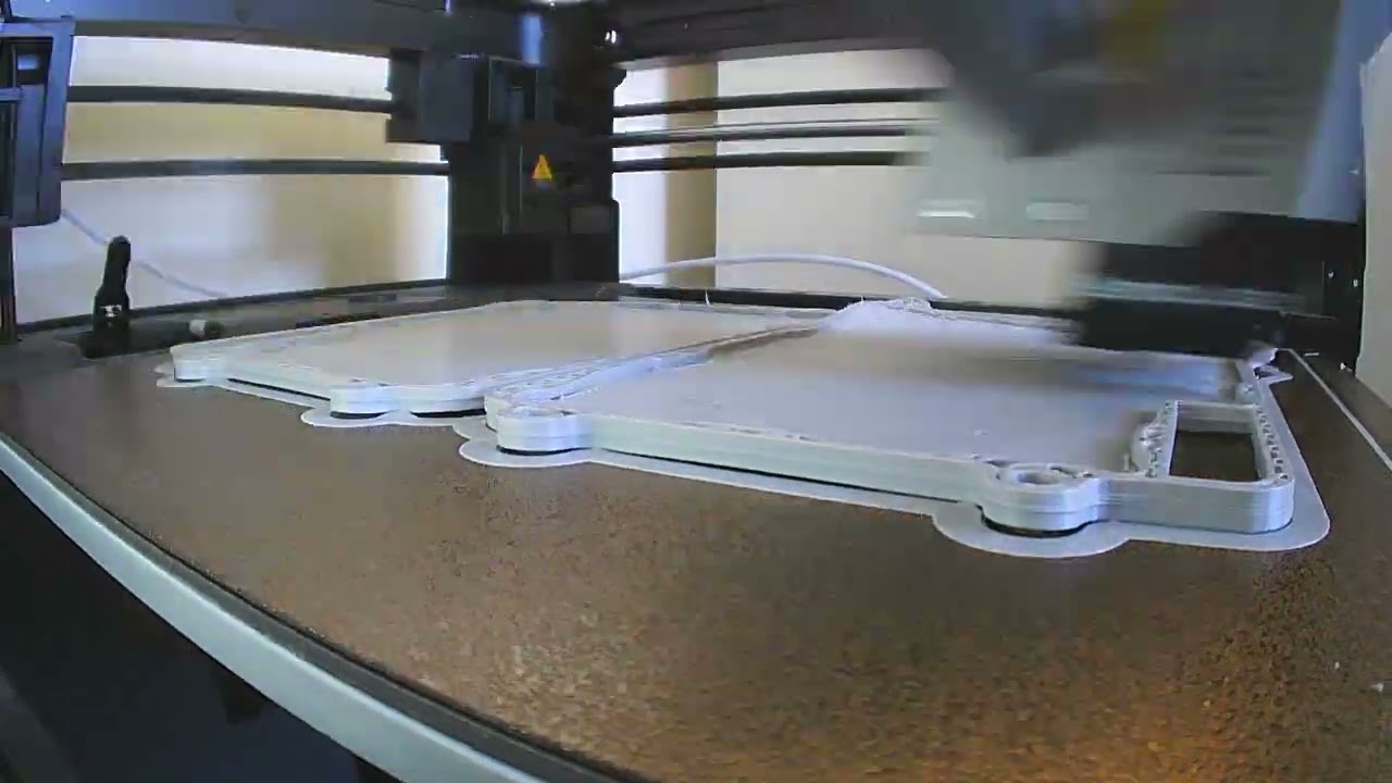

I bought some PETG-HF for my P1P and I’ve tried cleaning and leveling and it continues to warp
I have dried it in a Creatily dryer for 8hrs @ 60 Deg celcius
I have tried cleaning bed with Isopropl alcohol and dish soap and water ( one with each, and once with both )
My latest print had:
Cleaned with dish soap and water, then isoproply alchohol
5mm outside brim
Being heated again by creatily heater
Fairly generous layer of magigoo adhesive
  • Warping off of bed
  • P1P
  • Default settings, bar adding brims and changing infil to gyroid
  • Grey PETG-HF
I’m in the UK, approximately 50% humidity right now, thought it’s in the creatily dry box drying ( again ) at 13% Relative Humidity
What is your “brim-object gap” set to? Try it at zero. That should help to keep the part attached to the brim.
How many walls and how thick of infill?
Ensure your wall count is <3. Add brim width 10mm or use tabs at the corners alone. Also turn off your aux fan on the filament setting window. Looks like it could be wall count issue or the fan is rapidly cooling your print.

When cleaning the build plate, it is usually a good idea to get deep into the grooves of the textured plate. So dishwashing liquid + warm water is good, but you may want to add a stiff, clean brush and plenty of muscle grease. You really want to get everything out of the grooves. Literally, rinse and repeat a few times for best effect.
As @JonRaymond noted, reducing the brim-object gap will have a big effect. In my experience, it makes more of a difference than increasing the brim size beyond 5mm.
You could also increase 1st layer (only!) bed and nozzle temps by 5 and 10°C respectively, but
PETG will usually stick extremely well to a really clean build plate. So much so that a part as large as this can easily lift the build plate off the heat bed when warping.
In that case, you can address the root cause by keeping the build chamber warm (while avoiding heat creep!) and slowing down and/or decreasing the layer height. It’ll take longer to print, but I prefer a single slow successful print to two fast but failed prints.

The walls are the default, the “Wall loops” is set to 2, are you saying I want it to be above 3 ? Or less than
I did notice the brims didn’t actually touch the print, I’ll reduce the gap to zero and try that

That is indeed a start. I did do exatly that for initial PETG prints on the ancient Tarantula back in 2016. If it is not enough, people tend to get creative and put the printer in a cabinet, buid a tent, build an initial enclosure,… at least until the sidewall panels available for download are printed.
But the 1st issue seems to be build plate adhesion. On a really clean plate, a large flat but warping PETG print is very likely to pull the build plate off the heat bed. If you have printed PLA on that plate previously, it can be a bit tedious to get into the valleys of the textured plate. But you really want to get any residues out: PETG is frequently used as a support interface for PLA because they really do not like to bond.

Pic 2 looks like a very different problem than Pic 1.
I get that kind of underextrusion and tearing when I have a nozzle or extruder clog. Other root causes can be more benign (PTFE tube end not sitting properly, bound filament, unlucky filament calibration, wrong plate setting, thermal paste degraded) or more serious (faulty pins/board/extruder,…).
Since you just moved your printer, it may also be rather benign and you just need to push in all PTFE tubes again and try from the rear spool holder rather than the drier to minimize friction.
Usually however, it occurs due to a nozzle clog. Since you printed with PETG initially, is pic 2 also PETG? If it is not, it is quite likely that there’s a partial clog.
The “Simple clog” method does not work well in my experience as it just pushes contaminant up. I usually go straight for the “hex key” method and do that a few times in a row.
:crossed_fingers: and :four_leaf_clover:
It is very evident that there is something on your build plate. In my opinion, I wouldn’t use Isopropyl after washing the plate. There are differences of opinion on this forum about the use of it but I have always found that it introduced more adhesion issues than it solved. When you wash it, really scrub it with a brush.

Solution
  • Magigoo
  • +5 on first layer bed
  • +10 on first layer nozzle
  • 5mm brims with 0 gap between object and brims
  • Could either be nozzle temp/bed issues, I shall try without isopropyl and see how it goes !
