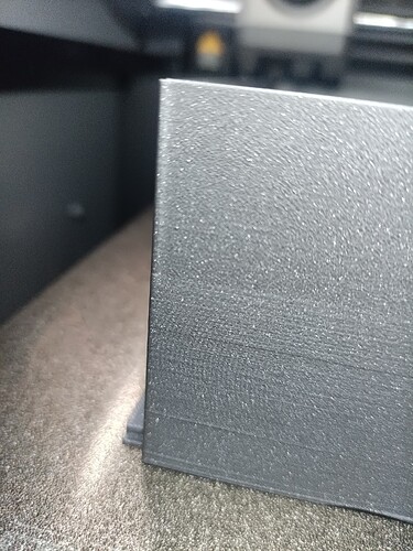

Dried the filament for 12 hours and set all parameters to default. Eliminated most of the warping. I’m printing a litophane light box and since the printer is only going in circles around the edges I decided to switch the print speed to ‘sport’ (124%). Funny enough the layers in sport mode look much smoother and cleaner. What is is that needs to be tuned here? Don’t know if the picture is clear enough but the first layers still have some layer lines and speeding up the print totally eliminated that.
Excellent :heart: Glad the key issue was easy to fix.
I would not really tune anything further as it lools quite good :+1:
If you do however want to run another print, the right bottom of the pic appears to show a little detachment from the plate (maybe a fingerprint?) and the 0.2mm layer height is always out-of-phase on each layer (0.08, 0.16 and 0.24 are in-phase).
Particular layer effects can however be extremely difficult to resolve. Layer time effects like the “benchy hull line” are really vexing and from the pic, I do not think it is a serious enough defects to merrit going down that rabbit hole. Or entire cave system :joy:
As for improvememts from sport mode, I myself always slow down in case of issues. However, it.may very well be that you had to speed up to catch a sweet spot for the resonance compensation.
