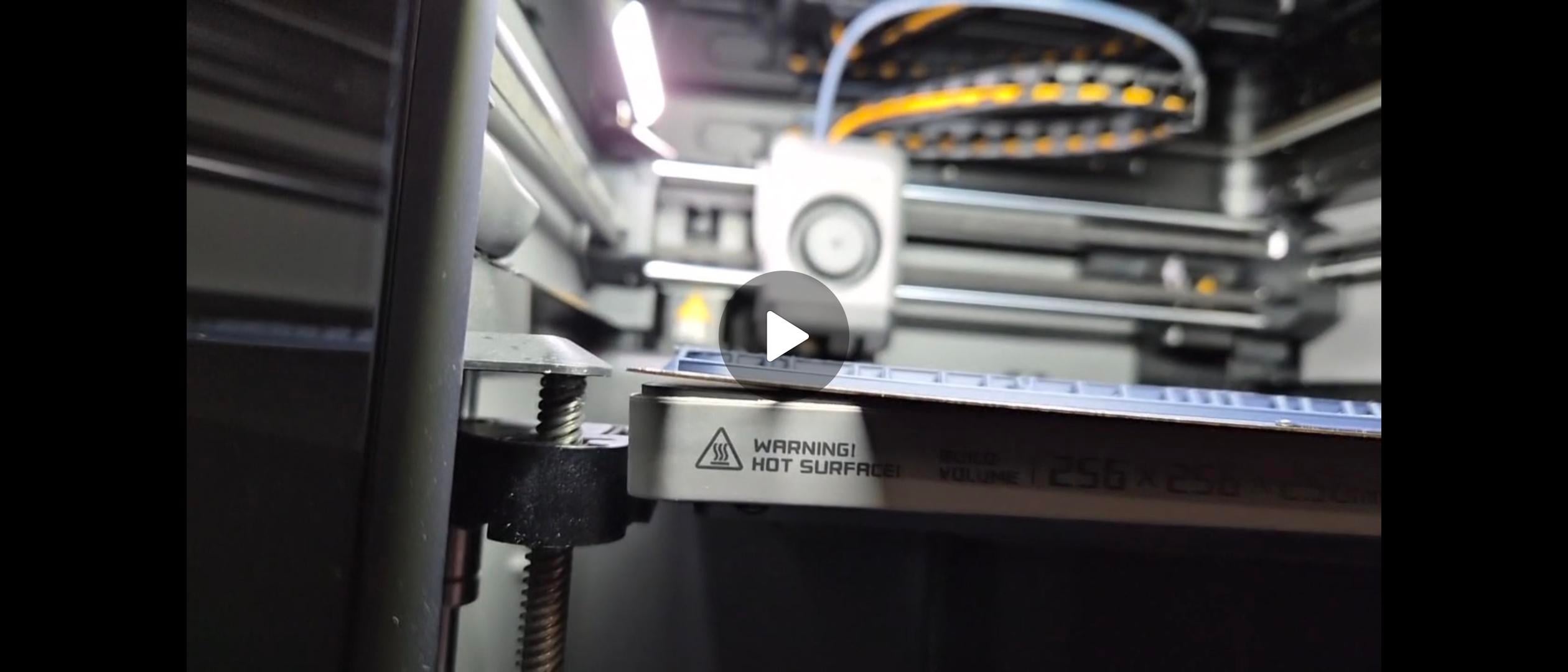

  • Second Attempt: I suspected low bed adhesion and low chamber temp. I used liquid bed adhesive, added a brim with “mouse ears,” and waited for the chamber to reach 50°C. The adhesion was so strong that the print didn’t peel off the plate—instead, the cooling ASA pulled the entire magnetic PEI sheet up off the heatbed.

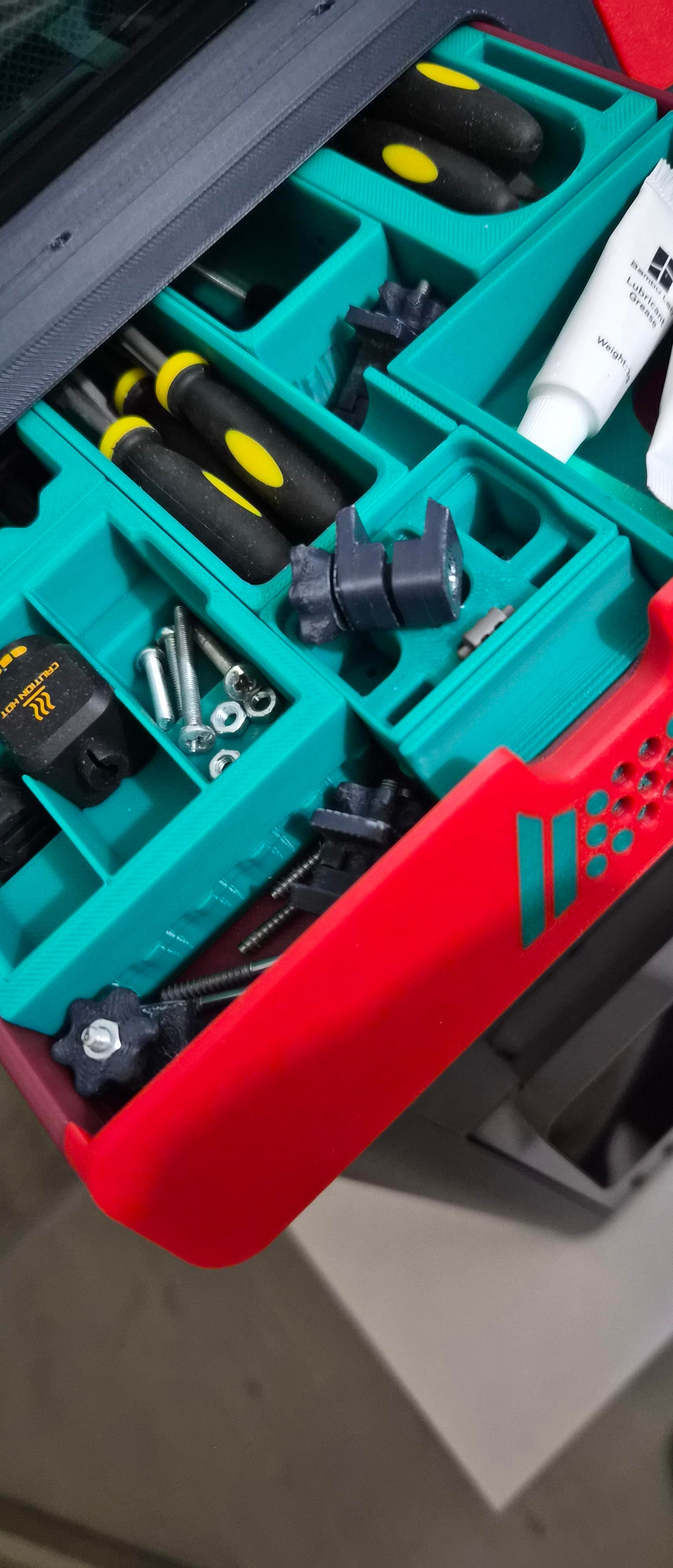

  • Third Attempt: I printed some bed clamps to keep the PEI sheet secured to the heatbed.

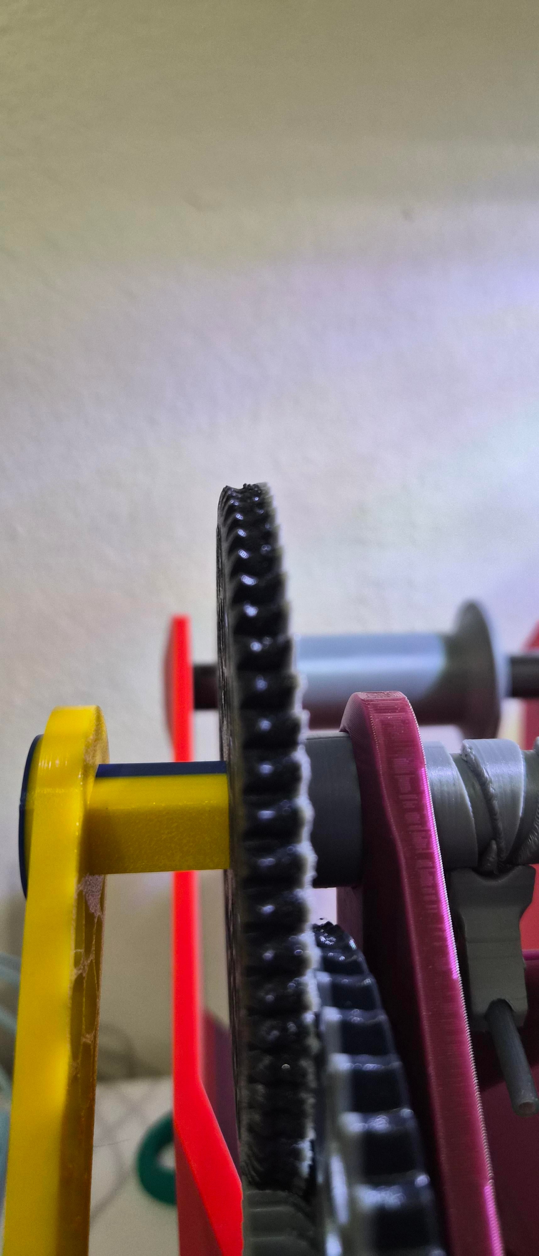

  • Fourth Attempt: I bumped the chamber temp to 60°C and lowered the printing speed. The first 10 layers looked great, but then the corners started shrinking/warping inward over the next 20 layers before stabilizing for the rest of the print.
