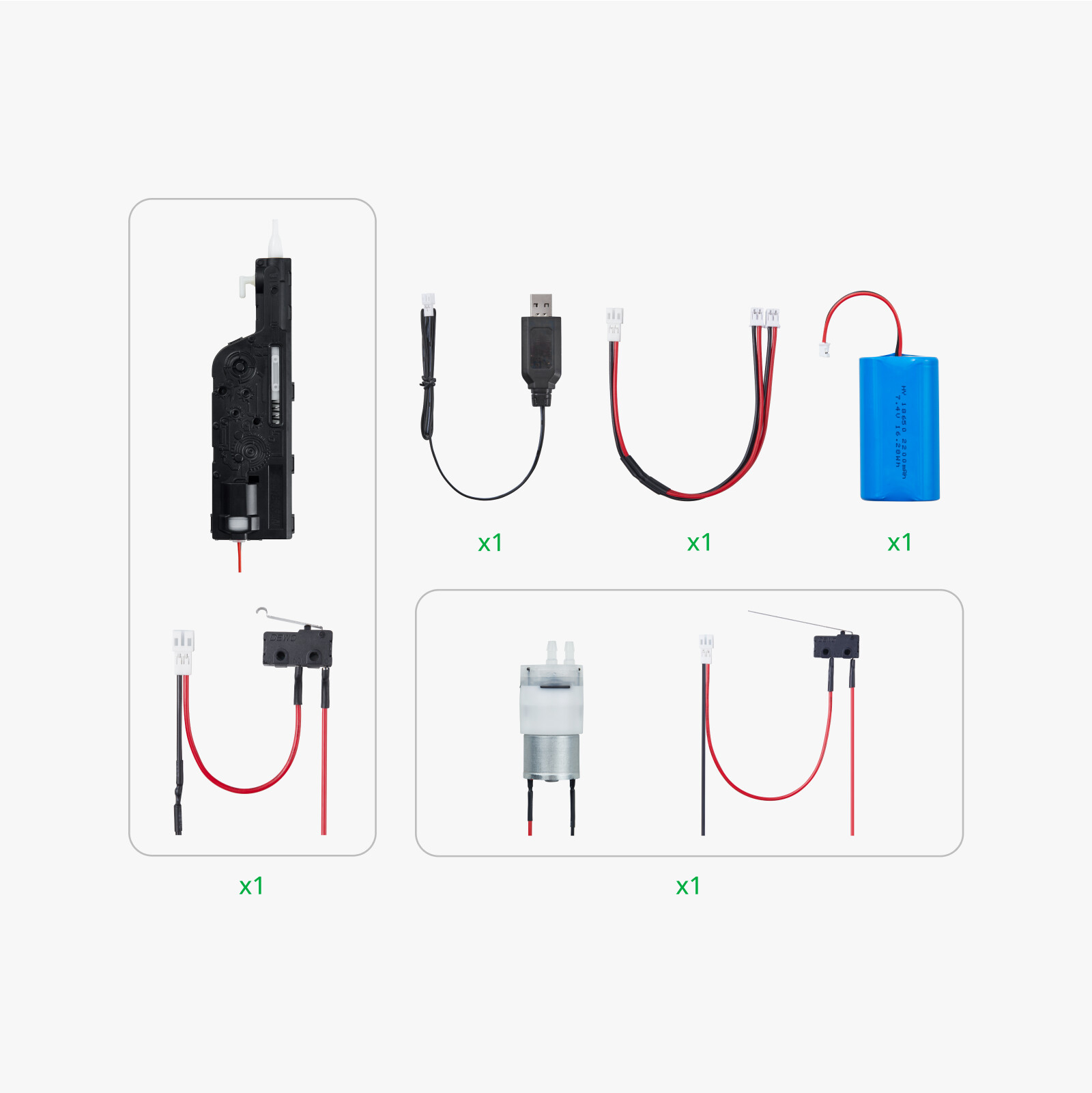

Hi. I’d like to design a model using water spray kit and i realised their’s two kits. The Water spray kit 02 doesn’t have an auto-fill, as opposed to the 01. But what is exectly auto-fill? Tried to read the documentation but nothing helpfull. Can some one help me with some details please?
According to the documentation…
The kit also includes a water pump that automatically draws water from open sources into the tank, reducing the need for users to detach it for refills.
From the pictures it looks like the outlined section in the bottom right.

I have opened mine and I have the two parts shown in the bottom right outlined section.
This is the difference between the two packs from the photos they supplied.

Thanks! The sprayer hardware works really well and can shoot a long way. It is quite loud but I don’t think that will be an issue for most people since it’s an outdoor toy.
I can confirm that the water pump is optional. Since I didn’t use it in my project, I’m going to try to find some other use for it.
The auto fill part is just a pump and a switch that are separate from the primary water sprayer parts. You can plumb the pump to a reservoir so when the switch is triggered, it sucks water in to fill the reservoir connected to the sprayer.

The sprayer units and batteries are different between the two. It’s not just with or without the pump.
You missed the actual question.
The OP could see the listing differences, but, the form of the function wasn’t clearly explained.
